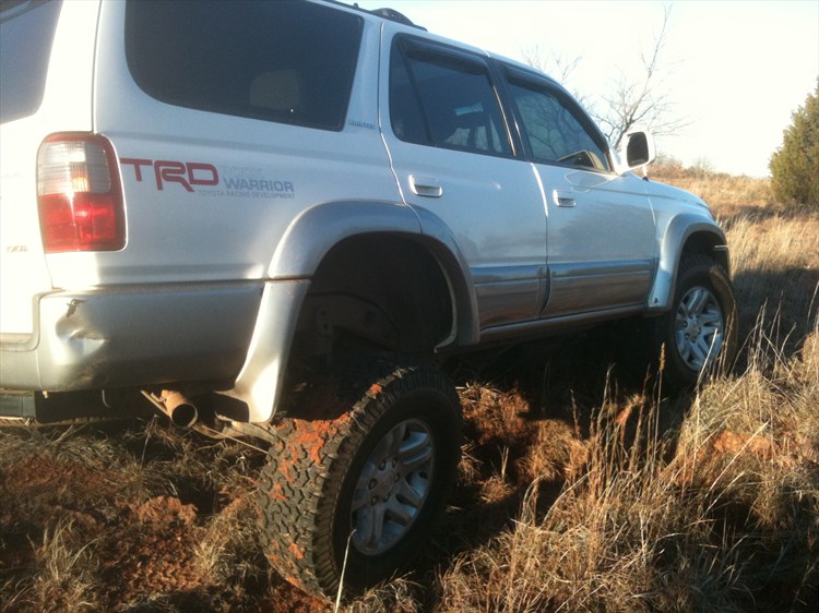

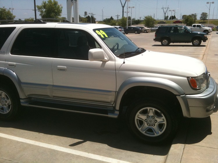

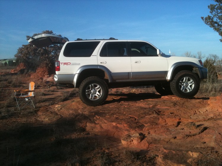

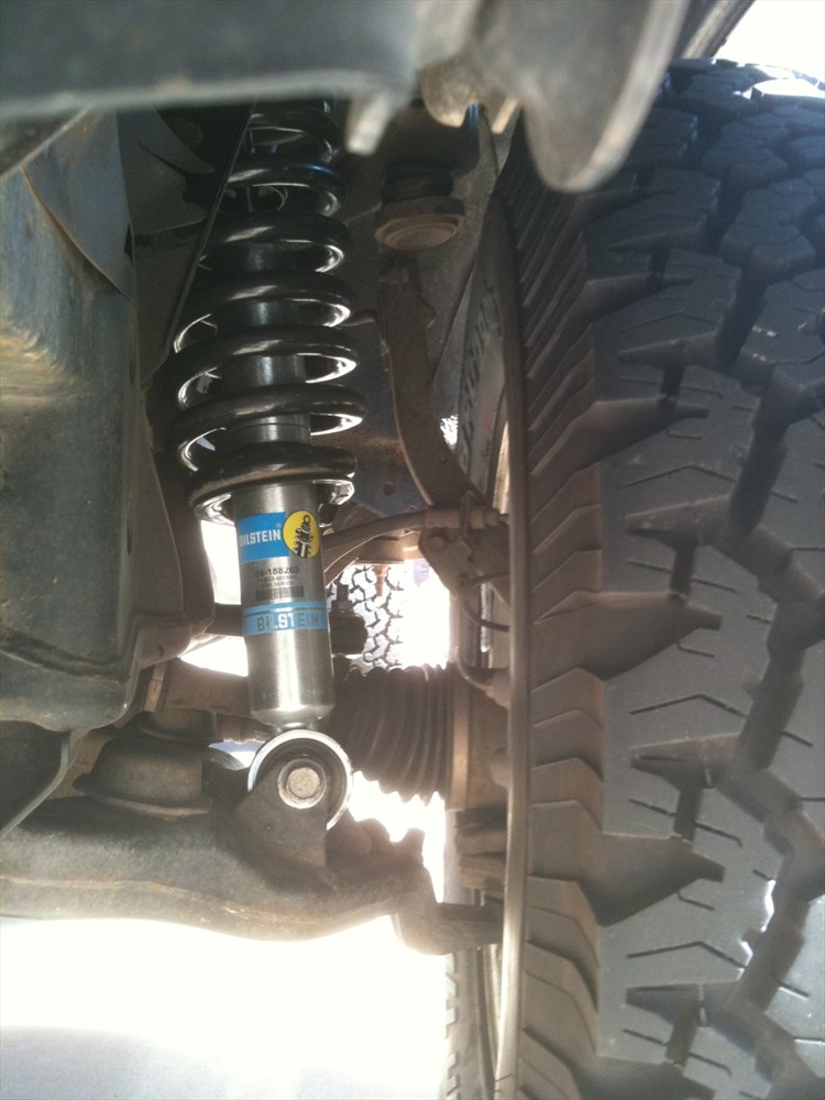

Suspension
• Front
o TRD Tundra
o 5100’s
o Toytec Diff Drop
• Rear
o OME 890 Coils
o Removed sway bar
Exterior
• -17 inch Tundra Wheels
• -285/70/17 BFGoodrich AT’s
• -TRD Rock Warrior Decal
• -15% window Tint
• -Removed Running Boards
• -Few stickers on Rear window
Interior
• -WeatherTec’s
• -Stebel Magnum Horn
• -Sylvania Silverstar Ultra’s
Performance
• -***DECKPLATE
• ***Intake Silence Removal
Maintenance
• -New starter

are you running spacers to fit the 33"s with the tundras?
btw without rear sway bar attached at all, hows daily driving? also do you have sort of "limiting straps" or something just in case you flex it to much for coils to reposition themselves?
No, no spacer no problem.
HAHA.. Now I wish I did after you mentioned that. Im originally a leaf spring dork.
No problem so far:roadkill:
sweet, i always seem to get mixed answers on that. tundras with 33s some say rub some say no rub.. im waiting for funds to jump on 33s just trying to find a definitive answer if i need to run spacers or not... although i dont like the idea of spacers i dont mind them i guess.
