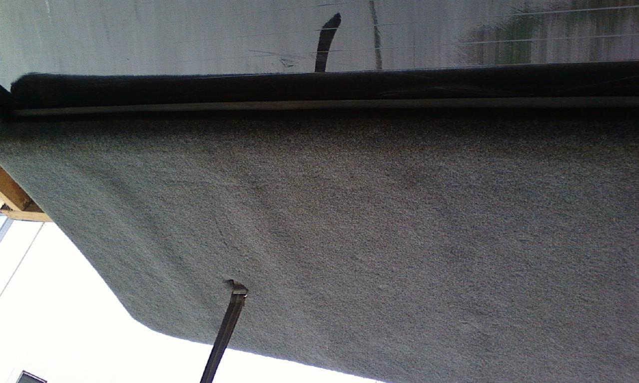

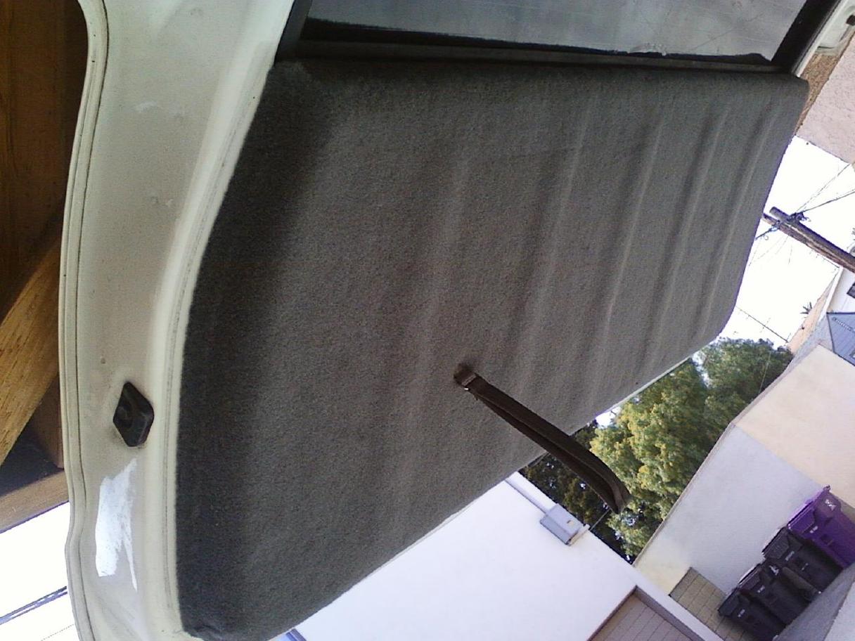

I put carpet on mine last time I took it off just to get some added protection.
