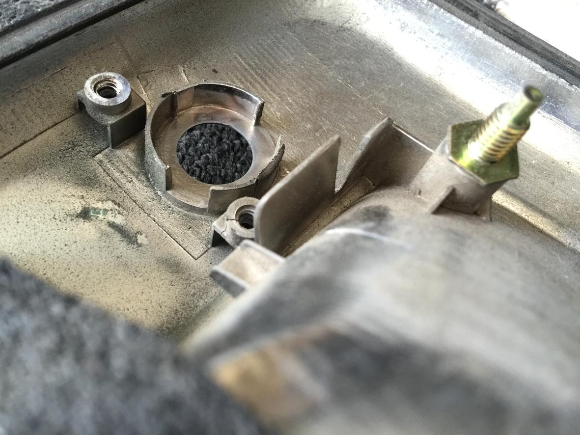

This is a picture of where the lock cylinder is secured with two screws in PLASTIC... Brittle plastic... A little metal here and there would go a long way. Wish less plastic was used for areas like these that have repeated pressure over time which is sure to break eventually ...
You can see the ONLY integrated bolt sticking out & the two screw openings to secure the lock cylinder...
I have since tried to strengthen areas like this which will eventually break with JB WELD...
Just a big glob in the open area below....
You can actually see a small crack on one of the screw holes....
