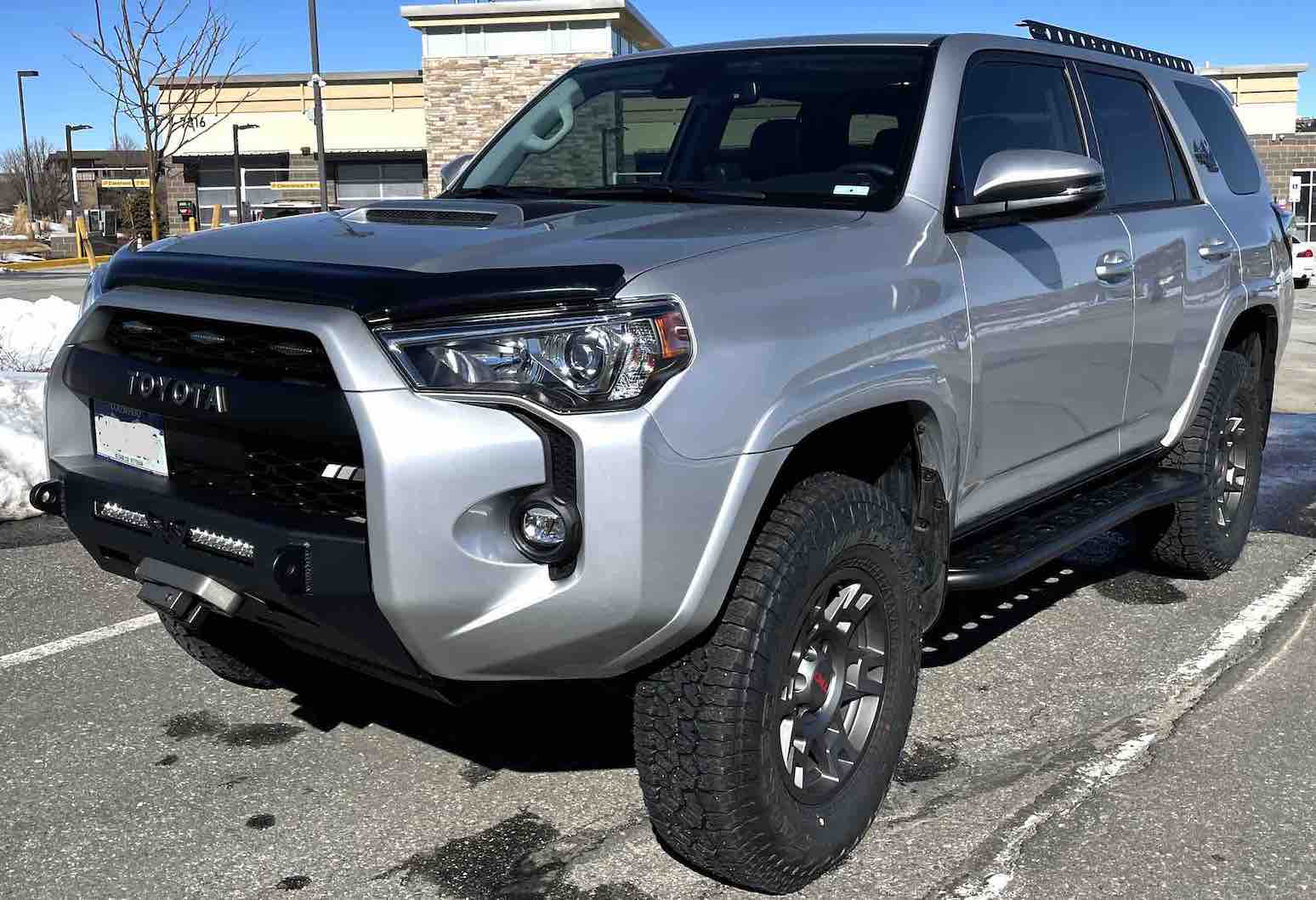

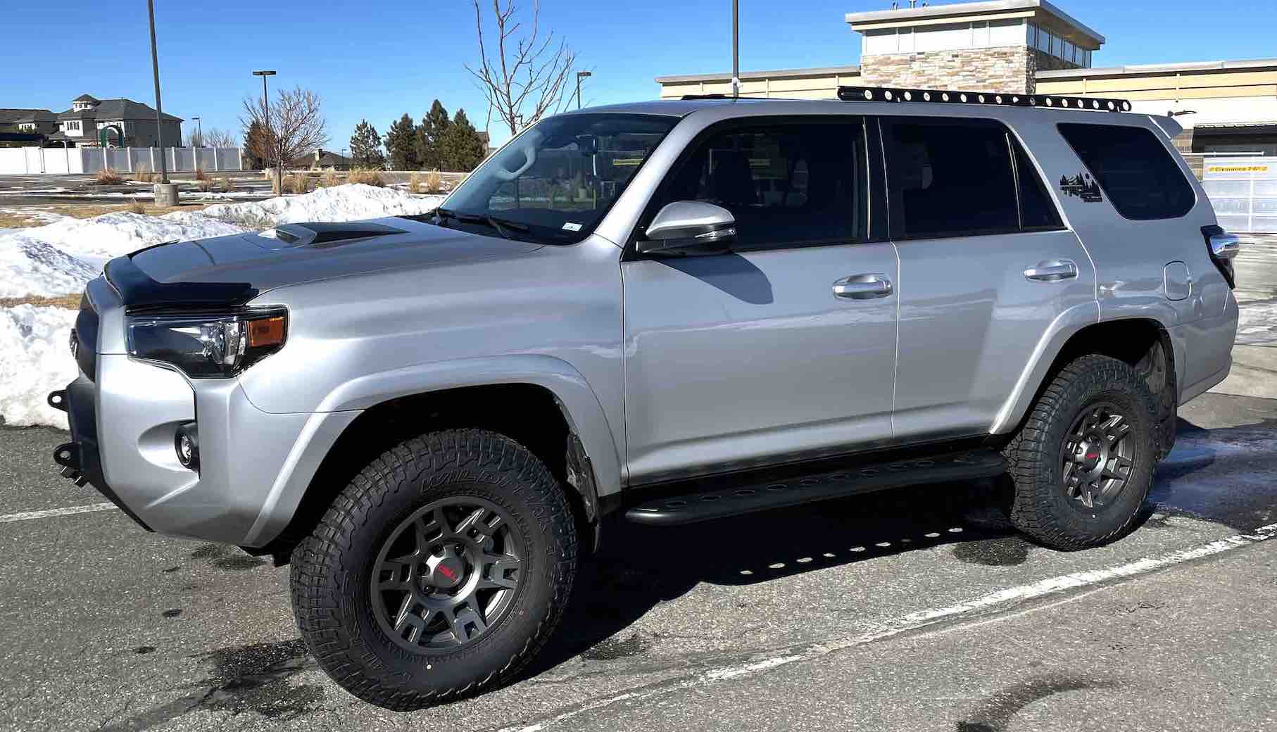

Photo for reference

My next set of tires will be 255/80/17s. They look to be the perfect tire for someone who wants a true 33'' and doesn't want to worry about a BMC. They have been around forever but are only growing more popular on the 5th gen chassis.

Side note, I love your truck. It helped convince me to get the LFD 7/8 rack and go with pizza cutters for my next set. Hope we can run into each other out on the trail sometime!
