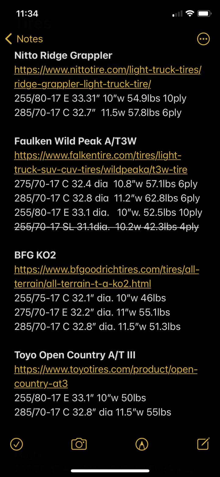

Here is what I have so far, I am really considering 255/75. They should easily fit on stock suspension (pro)
The 255/75 seems like the sweet spot? 32”dia 6ply 10”wide 46lbs! 6lbs more than stock 265s and 1/2” taller. Compared to the 285 faulken (prob the most popular 285) which is also 32” 11”w 6ply is 62lbs!!!
To be honest the 285 KO2 isn’t that bad either. BUT.. I feel like the narrower tire would tuck up in the factory spare location much better! (+2 for improved ground clearance AND reliability; very OEM appearance)
255/80 would be nice but it appears to be ONLY available in load range E, 10ply. That is far to heavy and unnecessarily stiff for me.
What are your thoughts?

I have 275/70r17 E KO2's now. You can feel the weight. My next tires will be 255/75r17 C. Lighter weight and less wind resistance. I'm looking at Cooper AT3.
I have had the stock tires of course, the BFG 275 E's, and BFG 285 C's. I can tell you the 285 C's are the way to go unless you are wheeling in super rocky areas. Daily driving is a lot better with the softer ride and you get a little extra ground clearance and the good look of a 285. The BFG 285/70 C load is only 53 pounds each and you dont notice them near as much as the 275 E's as far as weight. It's a lot better ride for sure. Its night and day. E load is too much for our 4runners unless you are wheeling in extreme areas. I definitely wouldnt go 255!

I was just thinking 255 are a win. You get the height of a 275 with the weight of a 265. They are skinnier and should fit up in the spare location very nice. And I think that is a stock Wrangler size; should be easy to find a replacement..
The 275 is a great size they are just stiff and heavy. I drive off-road but not hardcore stuff. Like most, I agree, E load tires are overkill for these rigs. For overall DD use, the C load 255 works very well and is gaining in popularity.

IMHO the 255/75 and 275/70 are perfect sizes for the 4R. I ran both on my '07 GX470, and came to favor the 255's.
Your usage sounds about like mine: no hardcore wheeling but forest roads, moderate trails, daily driving, and beach. I never had an issue airing down the 255's to ~15psi on the NC Outer Banks.
The 255's drive and handle well: you maintain great feel, they react quickly to inputs, and in my experience the narrower profile was much less likely to hydroplane than the 275's (or even 265/70r17's I also had).
That they're lighter and fit the spare location are significant bonuses.
