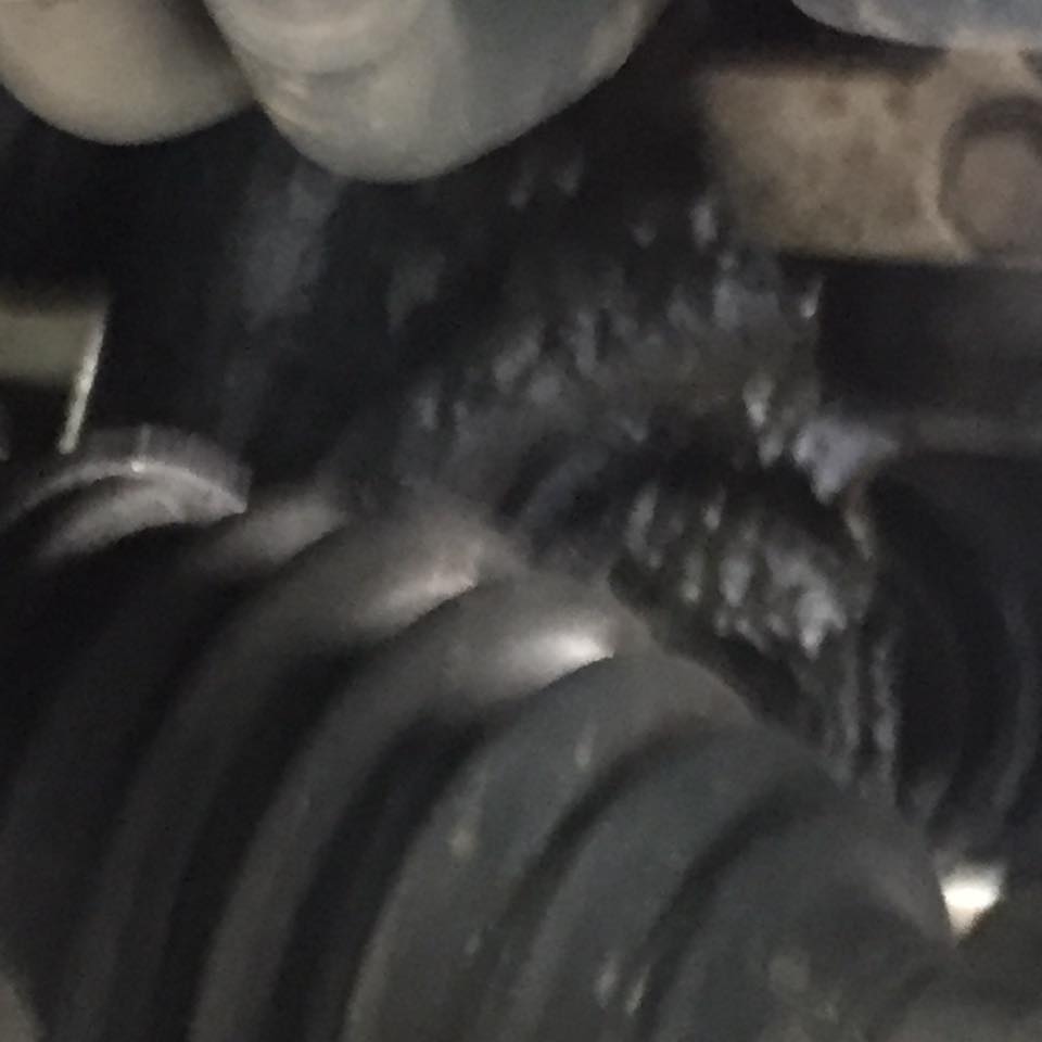

Just noticed a bunch of tan grease on the underside of my rig. Hard to see where it is coming from, but it may be the spring area. The Toytec springs look fine though.
Any thoughts of where I should be looking for? No lights on the dash have come on.

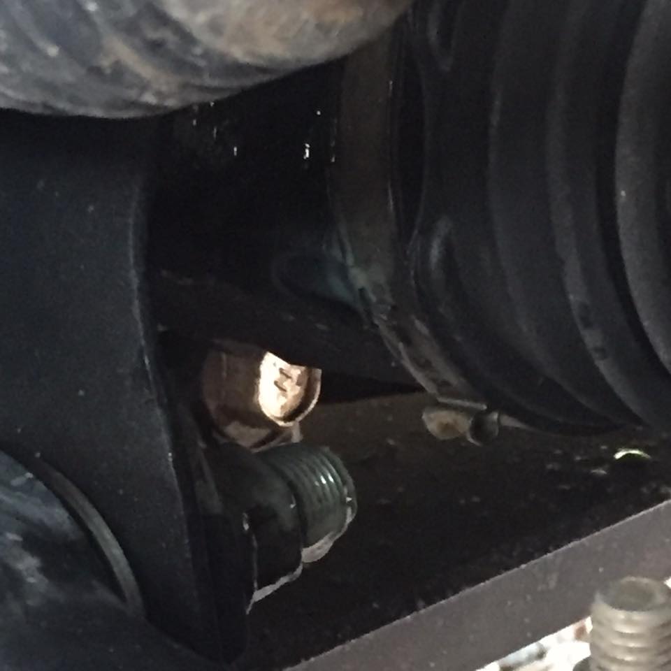

I am thinking its the CV Boot per the pics. Not the best but the leaking seems to be coming from the area in the first pic well the second is the spray.
I plan on trying to get this in this week but how drivable is this thing and for how long?

Take your skids off then take the pics. Every time someone has had tan grease (looks like puke) underneath the front it's been the CV boot so far.
Inner CV boot. Pretty easy to re-boot as DIY.

Your pic is not great.. but it looks like just the clamp is leaking.

Just a quick update for those who may be interested. It was in fact a CV boot issue on the driver side of my truck. No tears, but the clamp came a bit loose is all. It was under warranty so it was covered even though I had a lift which they installed too.
I did look at the cost if it was outside of warranty and it was about $285 including taxes so that seemed inline to what others were speaking of. Job time was just over 2 hours.
Appreciate all the feedback everyone gave as it was very helpful. Nothing like seeing a bunch of axle grease at the bottom of your truck after what you though was a "moderate" trail.
