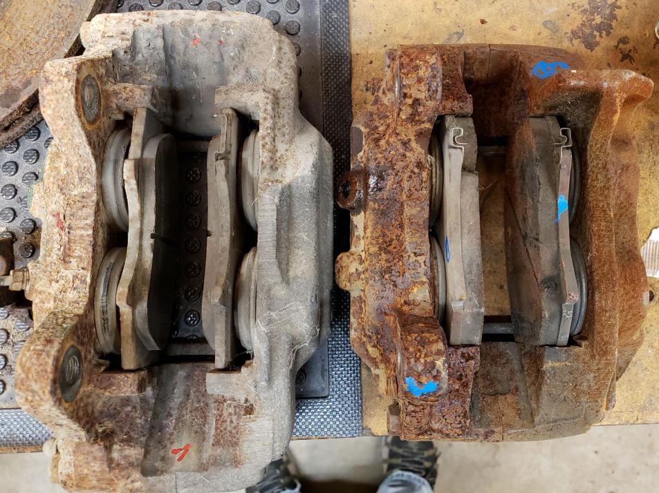

Pictured below on the left is a 231mm caliper (13WL) and on the right a 199mm caliper (13WE). I noticed the opening is larger on the 231 caliper which allows for a larger brake pad, or atleast a larger steel pad "backer". The actual length of both pads is about 4.7 inches but notice the gap between the pad of the 231 and the actual caliper. This seems like wasted area that a pad could occupy.
Why wouldn't the pad on the 231 extend as close to the caliper as the pad does on the 199?
Do all 231 pads have this gap?
Was Toyota strictly wanting more thermal mass by going with the later model 231mm caliper versus the 199mm caliper or did they also increase the surface area of the pads and I just happen to have a weird aftermarket pad in the 231mm caliper?

The gap is there by design. It helps allow a path for gas/heat/brake dust to escape without having to go through the entire length of the pad to escape.
The gap I was referring to was the gap between the pad material and the metal caliper. Not the slot in the pad material. :)
I see. Yes, all the 231 caliper pictures I've seen have that gap including the OEM calipers I rebuilt and installed on my 4Runner with OEM pads.
The larger/stout 231mm calipers have a greater breaking force... don't be misled by visuals in this case. Similar size (in length) pads though a step up in performance. Judging by the post date, you've probably made your decision by now and are enjoying the drastic change in breaking performance. Either one, 199mm or the 231mm, will be a night and day difference from stock. Anyone considering this upgrade will benefit from both, its merely a choice of what fits inside your wheels.

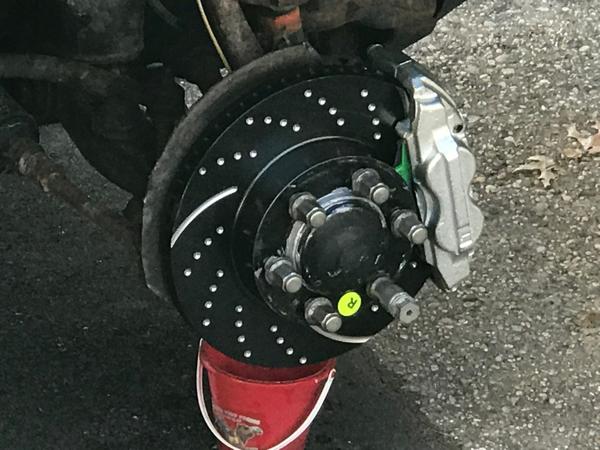

I did the larger TBU, (as per Timmy), and it was a huge success, great bite, immediate stops, no delays, feels like the brakes that Should've come OEM. :brushteeth:
IIRC wasn't the smaller of the two upgrades for folks with the smaller SR5 rims, (not fitting over the new, larger calipers?), mine is a Limited, so the larger wheels prevail.
Sent from my SM-G955U using Tapatalk
FYI - The piston sizes of 231 and 199 are identical, I measured them myself. My point is, the braking forces are the same for 231 and 199. The major difference is the amount of thermal mass when comparing 199 to 231.
