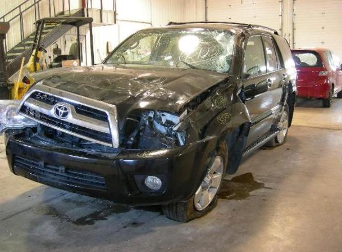

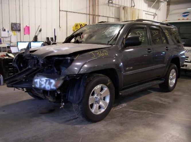

Yes I realize that most of you feel this may be an impractical undertaking, but I would like the information regardless. If you know it, please share. Most of this stuff if not really that expensive, with the exception of the 4WD transmission, which runs for $999 with ~50,000 miles on it. ECU - $250 t-Case - $499 front IFS axles - $160x2 etc etc. All parts prices are OBO as well. All used of course, from cars shown in the attached images. And yes I realize there is more to it, I was just showing some of the more expensive parts.

Did the 4wd one burn on the inside? Was someone ejected? It looks scary to me.
:offtopic: Was one of those T4R's rolled? There's been a Toyota weak roof thread that's been around and if that thing was rolled I'd say it did well...
