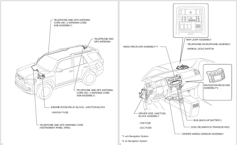

I'm not sure if all editions of the t4r come with telematics (aka Safety Connect) pre-installed, but the limited certainly does, I was curious if anyone knows off hand where the brains of the telematics system are located and/or specifically where the antenna and radiochip are for the Verizon chipset that is in it?
I'm looking to de-couple the unit from my 4runner and put it somewhere more useful, like in a box on the shelf in my garage.

I believe they are located in the sharkfin, based on the repair manual, but let me double check.
Edit: I added the illustrations from the manual, hopefully that gives you what you need. Check nashman's thread for the full manual.

I have a 2015 Limited with Navigation System. Do you have any info on how to replace the Telematics BUB (BACKUP BATTERY)?
