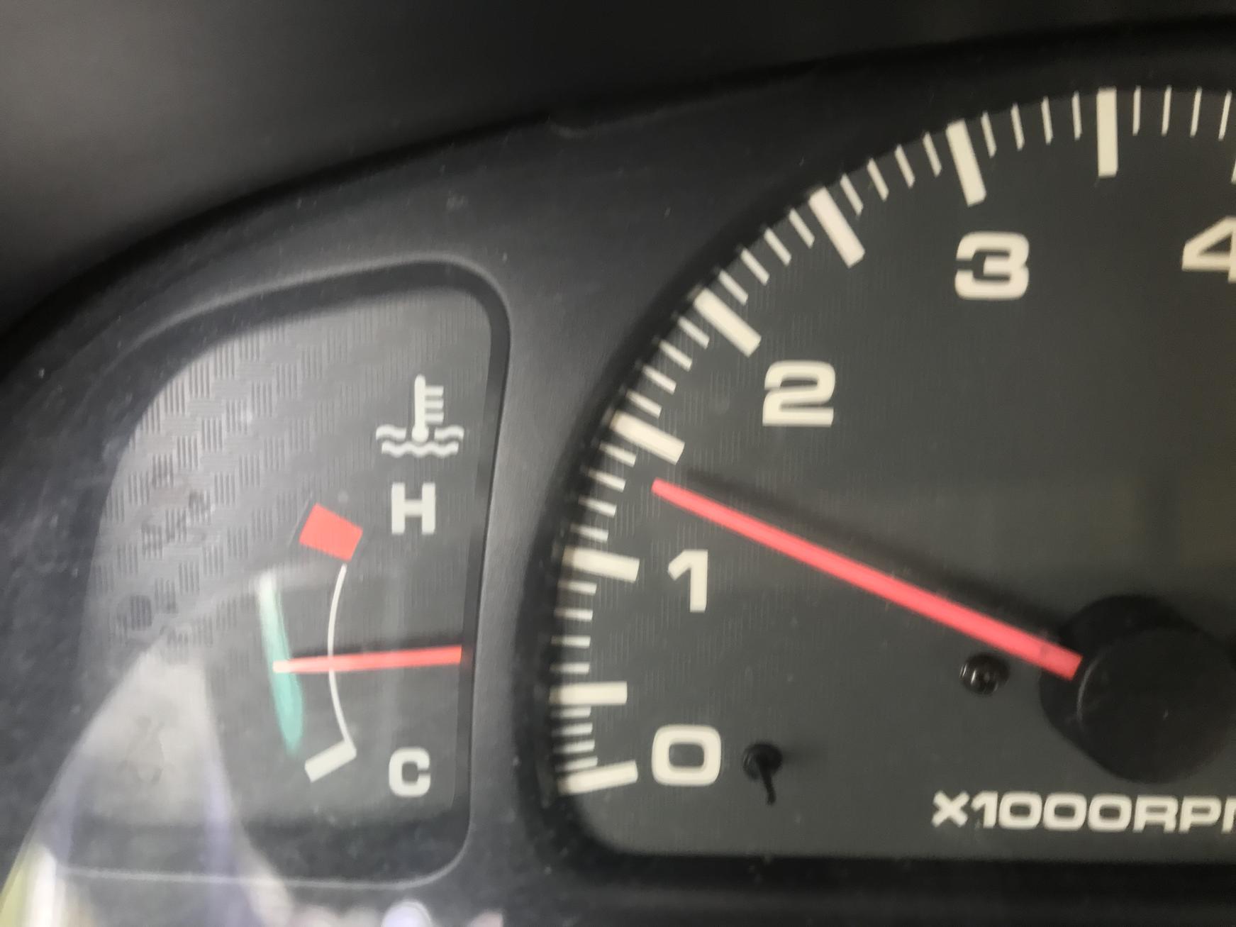

For at least a year is my temp gauge NEVER moves upward any whatsoever. None.
It religiously and unfaltering remains down all the way to below the ‘C’
without any change regardless of the type of driving.
Is it just a faulty gauge or something else?
Thanks in advance.

Is the engine coming up to temp? Or, asked another way, do you have hot heat in the truck when the weathers cold?
You probably have a faulty coolant temp sensor or a faulty gauge. See if you can get you hands on a scan gauge (or something similar) to make sure the truck is getting up to temp.
The sensor that drives the temp gauge in the dash is separate from the sensor that reports coolant temp to the PCM. It's way in the back near your heater hoses and it's only a 1 wire sensor. See if it's connected. If I remember correctly touching the wire to ground should drive the gauge towards the hot.
All you have to do is have someone watching the gauge to do it quickly. Or ohm out the sensor if you have a meter capable of doing it.

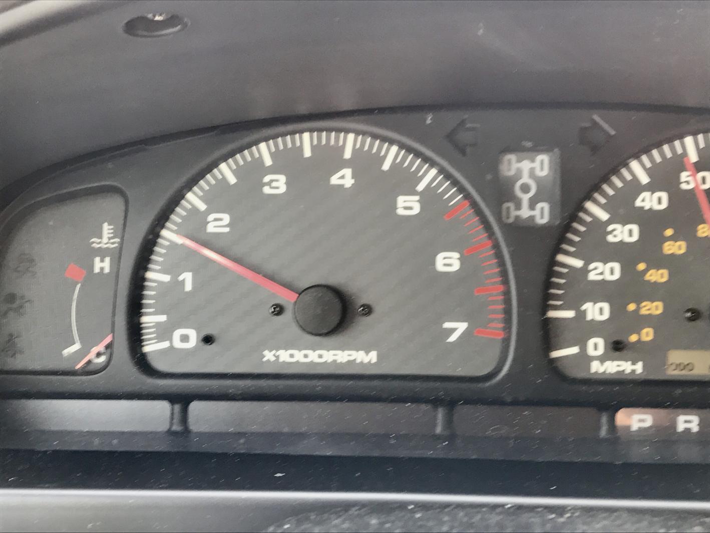

The sensor was unplugged!!
Thank you!
