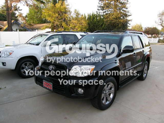

It's time for that rebuild... 150k on her and lots of dents. Its been 7 years of a great truck with lots of adventure but its feelin it so I'll do mod level II and see how it comes together. It's a 2009 Limited 6.

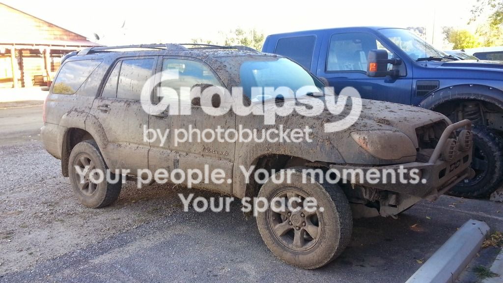

I've almost rolled it a handful of times and have winched it out of some pretty exciting spots; reverse NV mud corner decent, WY pendulum swing save from certain death... and have used the bull prick I built for it now 3 times. Still running okay. I even drove it to Vermont from Santa Barbara, picked up my boat and towed it across country. Pretty good performance across the Rockies too, but have to say that southern Utah, Nevada and Cali were the toughest on the tach.

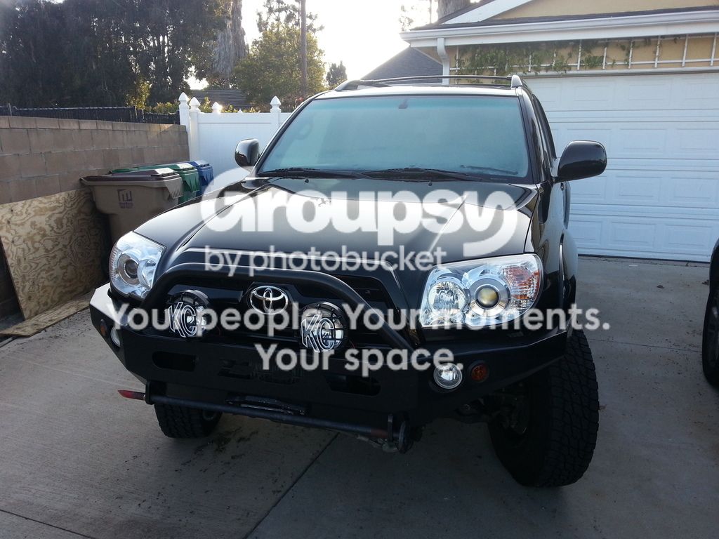

I bought it brand new and took it hunting within 500 miles where a ranch dog, two of them actually, tore the hell out of the front bumper skin - so that was the first to go. I added the Deelmo front bumper first of course, and a Warn 9.5ti. Then, because of my short-sightedness, I added a 3/2 spacer set up which proceeded to beat me and my friends to death over miles of jarring roads and trails. Run tall skinny tires always - like on my third gen, so that will not change. So - now its time for a little refresh.

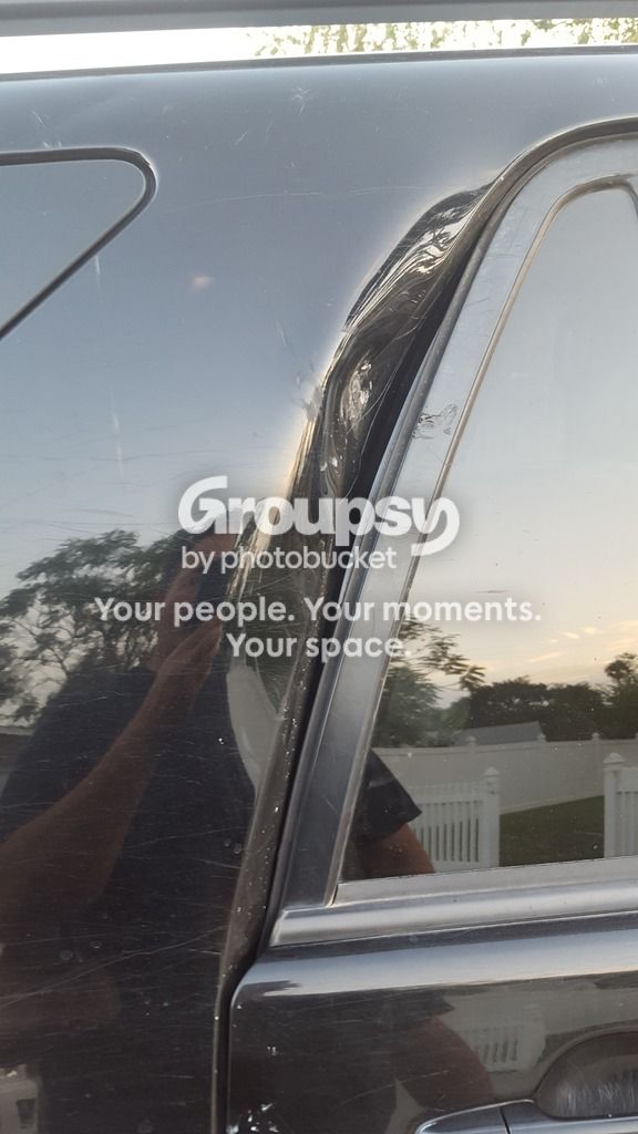

I went to a dent shop and they wanted $500 to pull the dent out of the door jam. Think I can do better so I'll save the cosmetics for last.

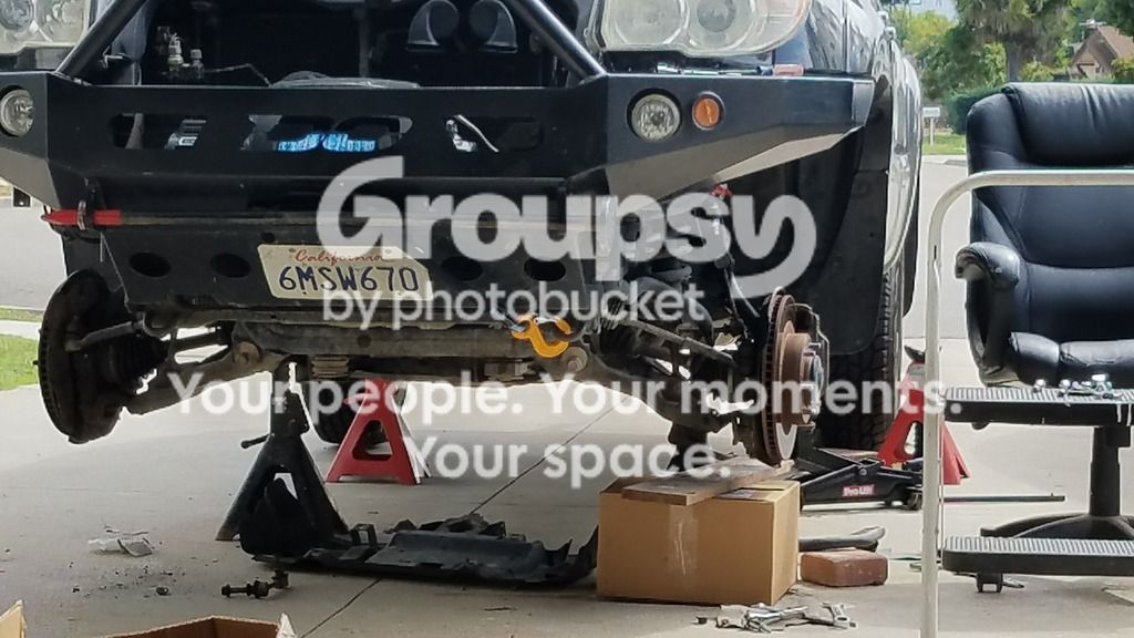

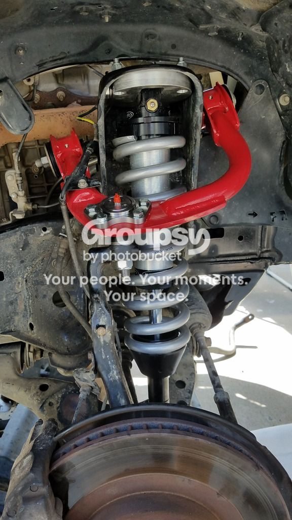

Okay - I've done the first phase of my upgrade. It was made painful in part due to a Taiwanese made 19MM wrench that was more like 19.5 mm. Rounded off my ball joint castle nut on the first go around, so I had to sawsall and hacksaw out the OEM ball joint and then get it loose enough to get it off and press out the stem.

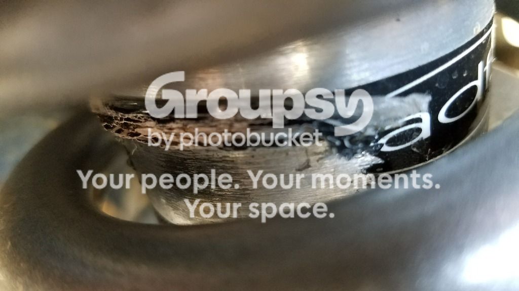

Other than that - I have some squeaks to address and maybe some rubbing. It looks like somehow the spring (inside) is rubbing on the shock on the bottom of the drivers side. (Eiback 700# on 2.5 Radflo's) See pic. Maybe just the label but I know I'm getting some noise on the drivers side.
http://i648.photobucket.com/albums/uu208/tom_hance/20170918_093350.jpg
Other than that - its riding fine. I went with the HD superflex - and not the standards and hopefully they will perform under load. Empty they are pretty stiff as is the front end... and I have to level it out. I'm most concerned with any rubbing up front.
I didn't put in the Firestone airbags - keeping it simple... and because I'm running the HDs, I'm not sure I'll need them.

Once the squeak is gone, I'll do some other mods and will report back. Calling JBA on the zirk fittings and Radflo on the rubbing of the shock.
