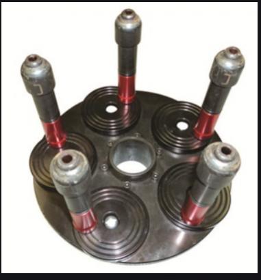

I'm of the opinion using a finger plate adapter during balances corrects this issue. It worked on 3rd and fourth gen 4runners.
Currently my steering wheel doesn't shimmy so I'm not balancing what an't broke on my fifth gen.
