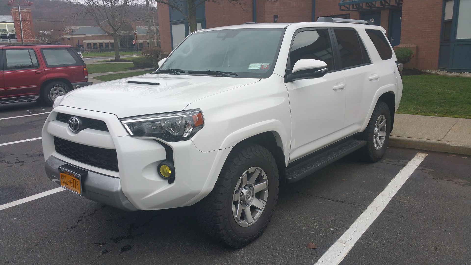

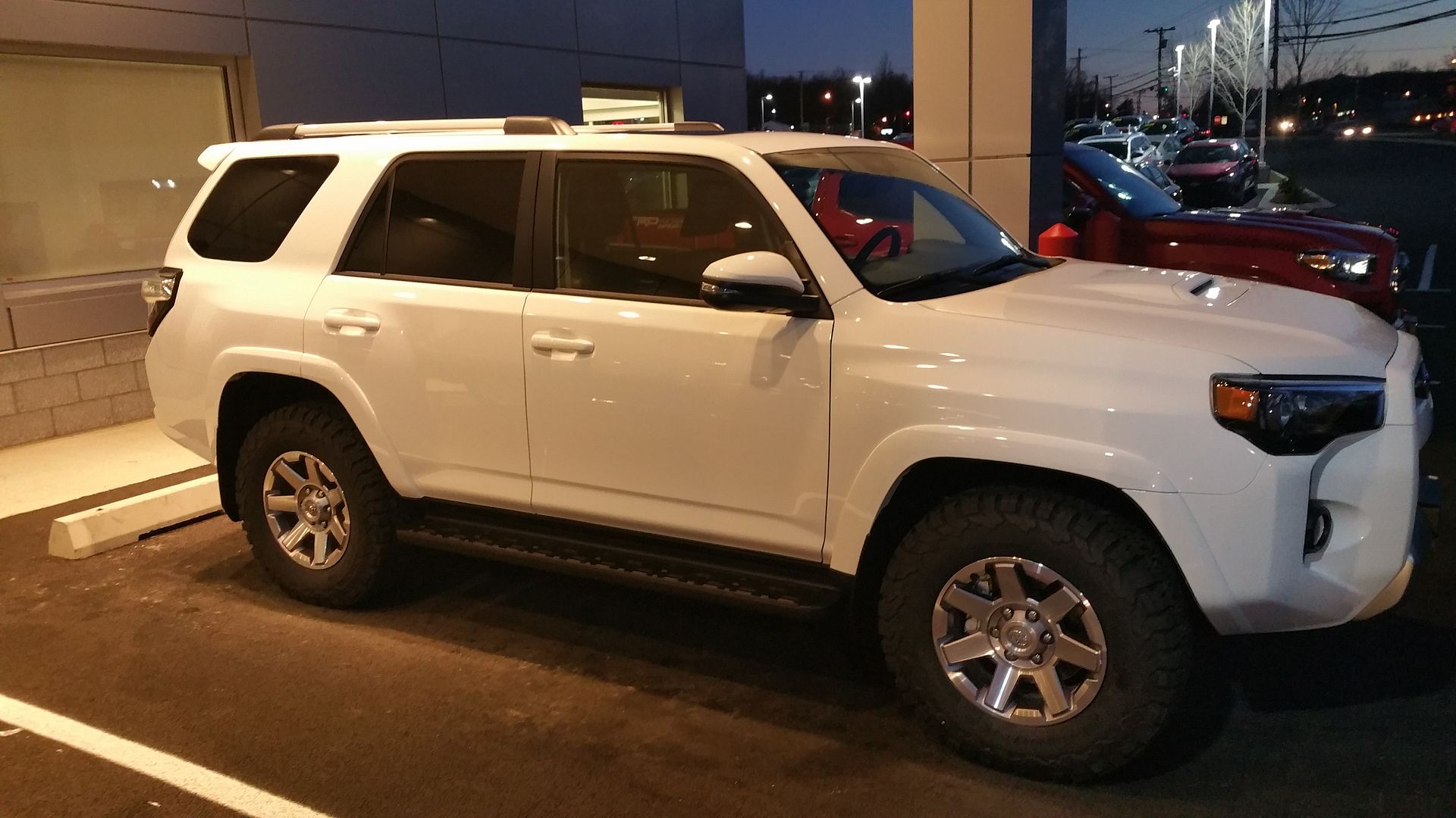

The second 4Runner is a 2016 TEP, no KDSS again, on purpose. Got white instead of silver. A few things I miss are the more utilitarian interior of the first truck, now this one is a bit more refined...not my style really..
and one with old 4Runner
First mod out of the gate was BFG KO2 275/70/17's E rated, installed at the dealer before pick up. Love them so far.
Next up was tinted front windows, 35% to match the rears, and Lam X fogs.
As she sits....

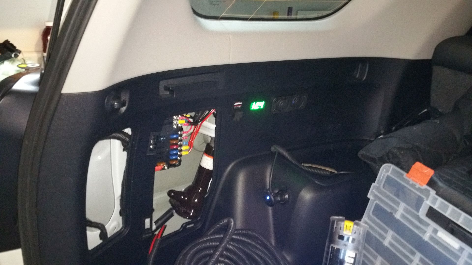

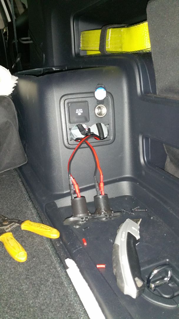

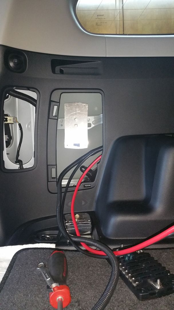

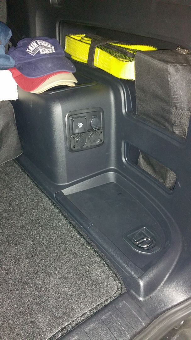

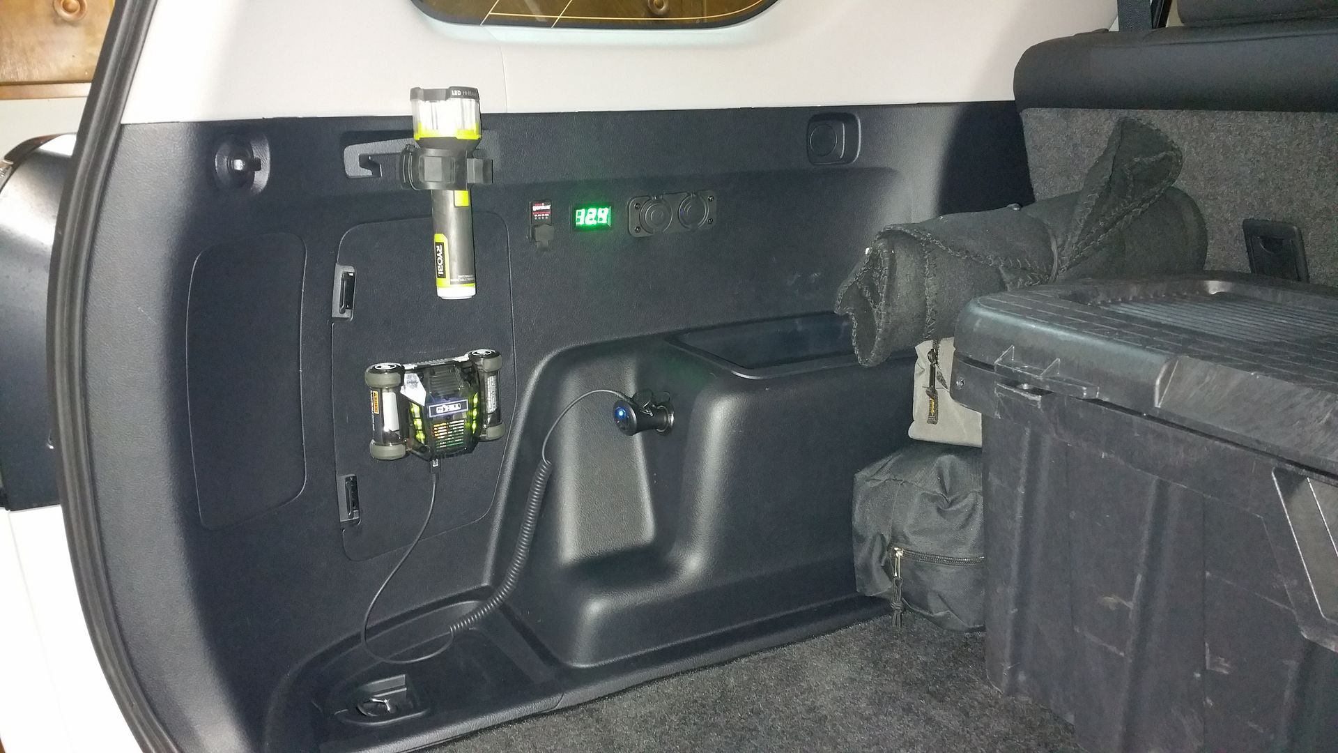

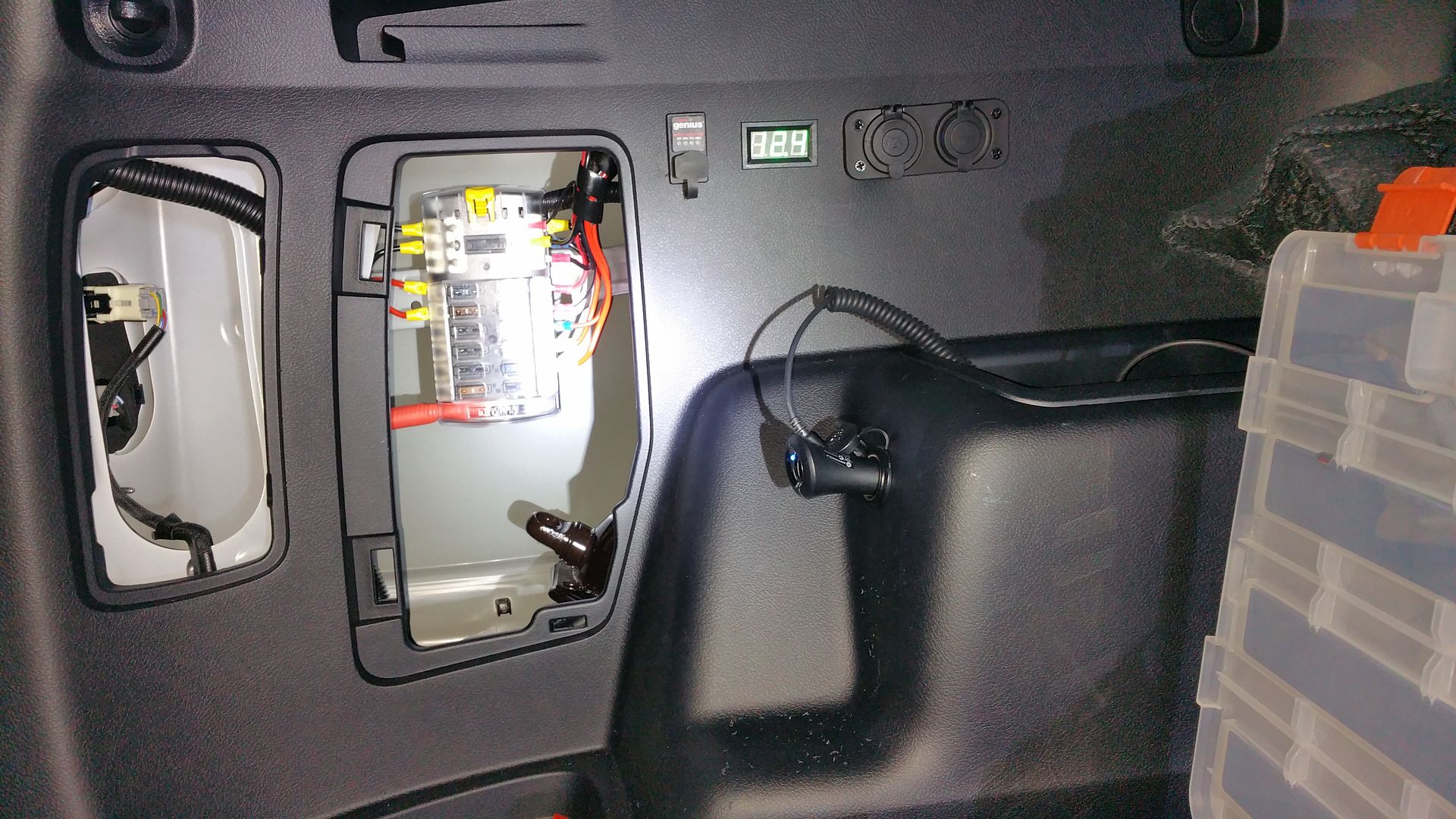

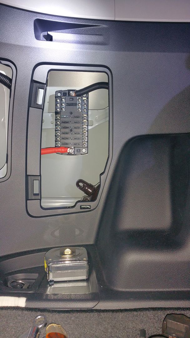

Next up was a 12 circuit panel in the jack area located at the rear of the truck.

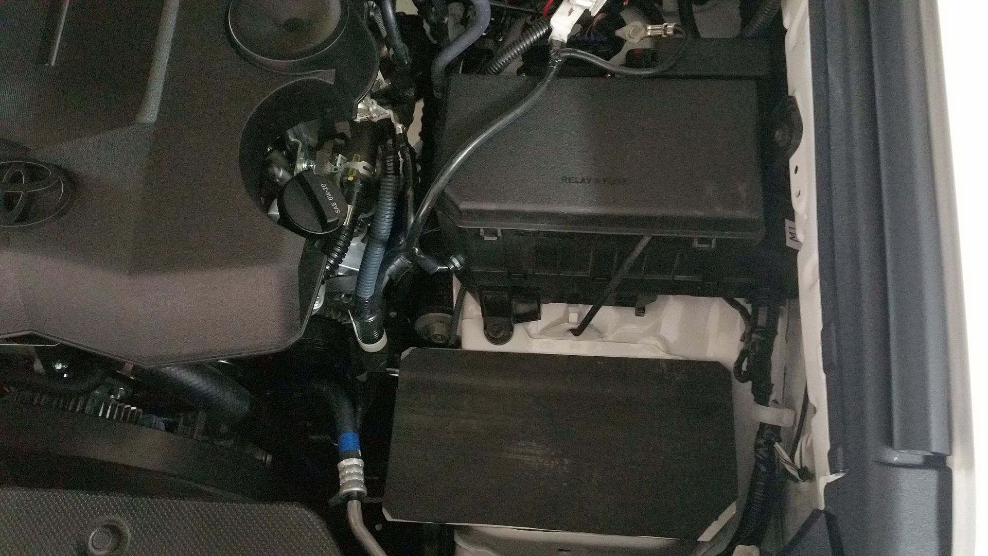

I ran a 6 gauge wire from the engine bay, to the rear, hooked to a 100 amp Buss circuit breaker located under the hood.
I also added 12v outlets and USB's on both sides. The 12v sockets are all run with #12, and will power fridges, or what ever.
I also added a NoCo charging port, that will eventually tie into the solar on the roof. It has a neat little blinking light that indicates percent of charge in the battery. I also added a voltmeter to display the battery voltage.

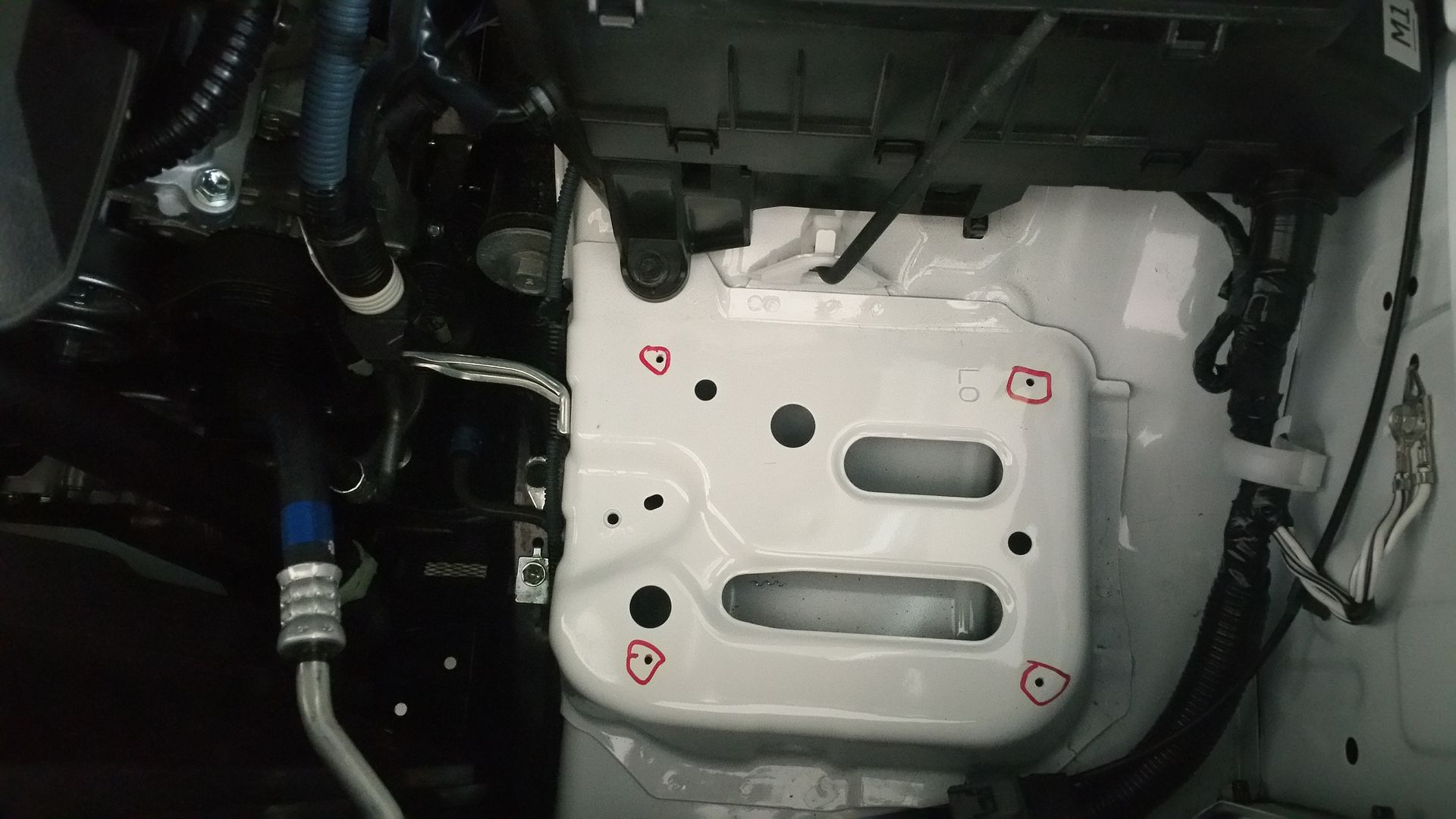

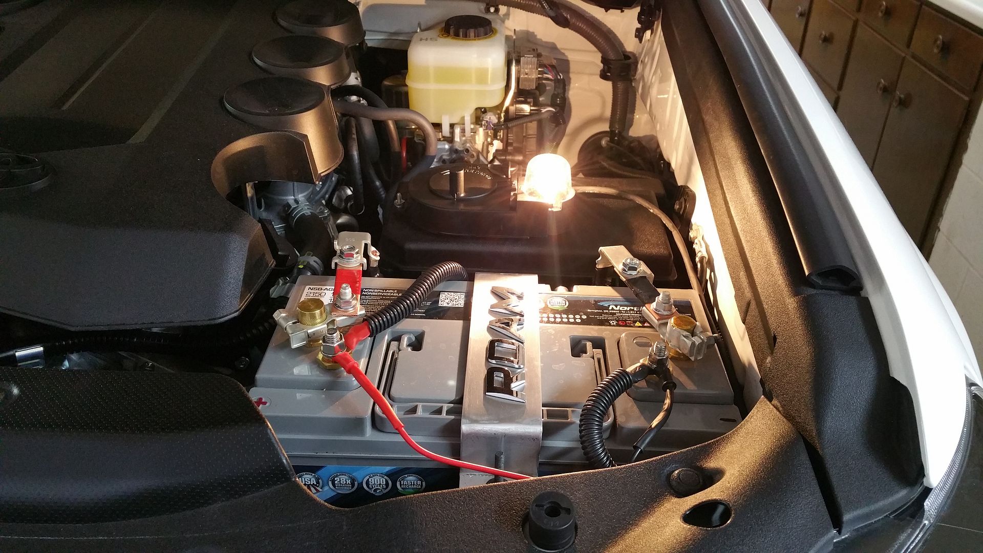

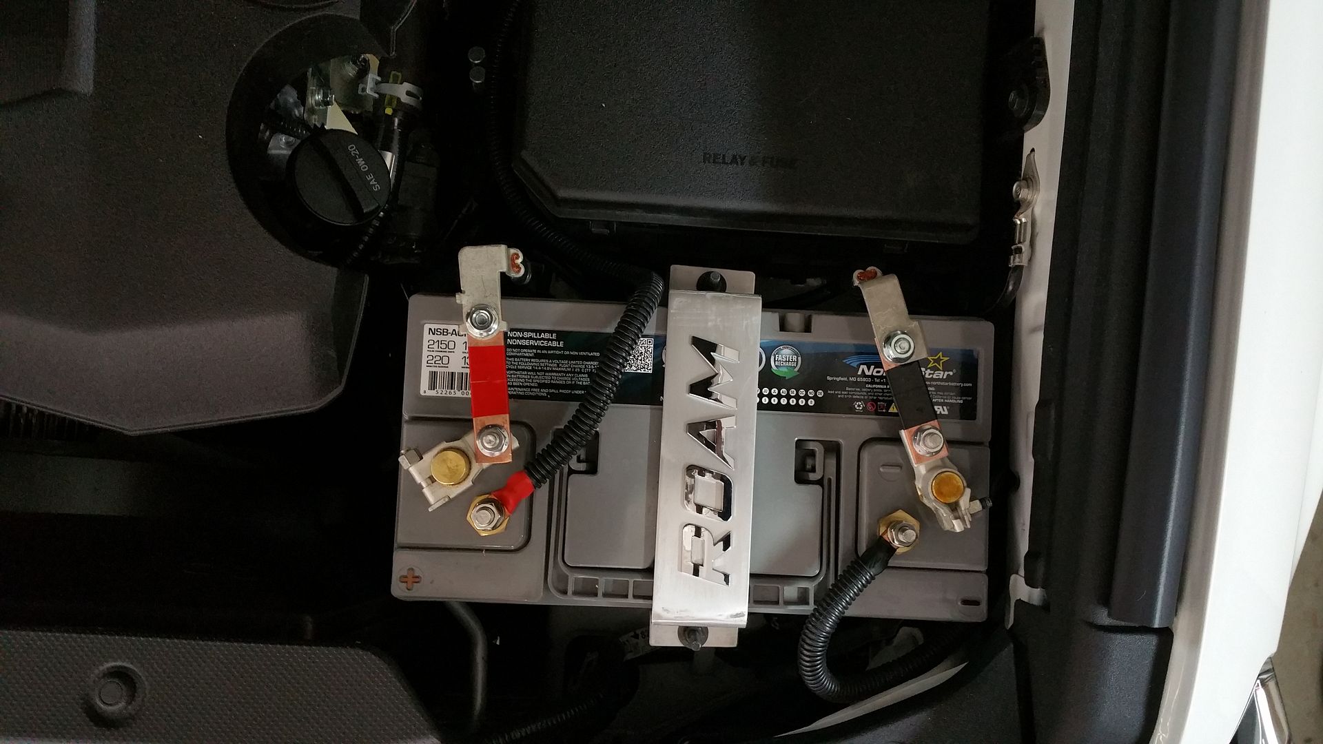

Battery is the PL-AGM-31M I got in a group buy here, and it ran at Tacoma World as well. Seems Sears Platinum AGM's are no more, so it time to look for an alternative...a buddy recommended this.
Initial impressions are favorable. Build quality looks good, as does the warranty. It's a tight fit side to side on the length, and it's about an inch higher then the stock, so the OEM hold down doesn't reach.

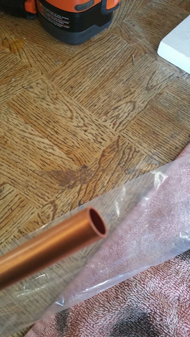

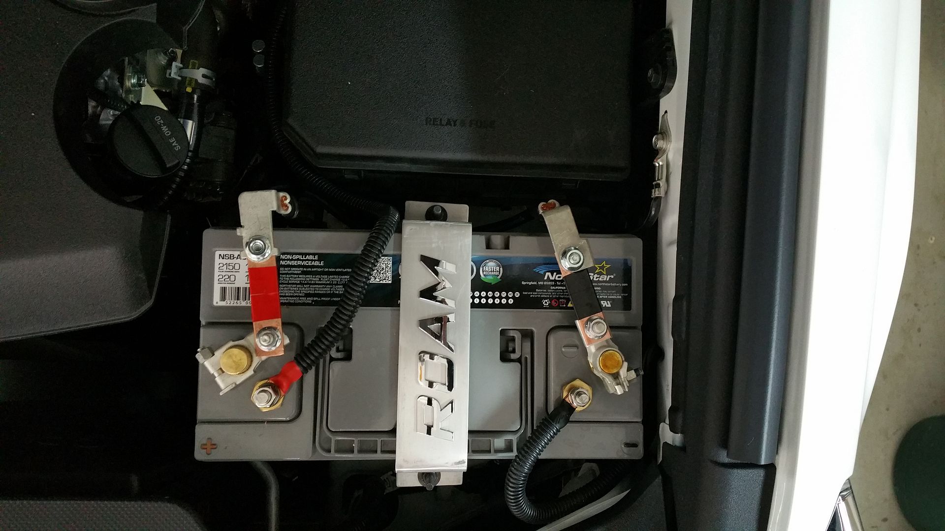

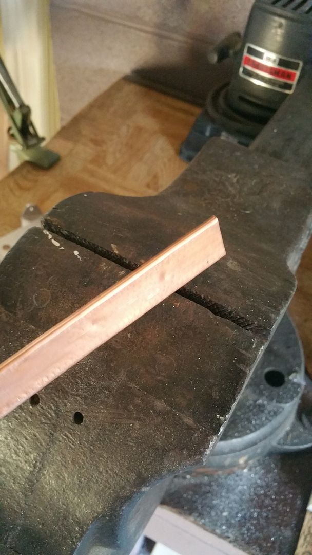

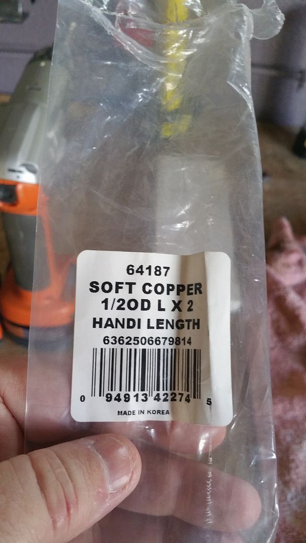

The terminals don't reach either, so I bought some thick wall copper at Lowes, crushed it in a vise, drill out new holes for the terminals, and bolted it back together. Is it safe?...lol...we'll find out. (if you do this shit to your truck and it cooks it, it's on you) I only do these kind of things because, it seems to make sense, and I don't know any better. I did order solid 3/16" x 3/4" copper from Mcmaster-Carr, to redo it, although I think it's fine as it is. It's very solid, bolted to the separate pieces of the terminal, which really made it easy to do it this way.

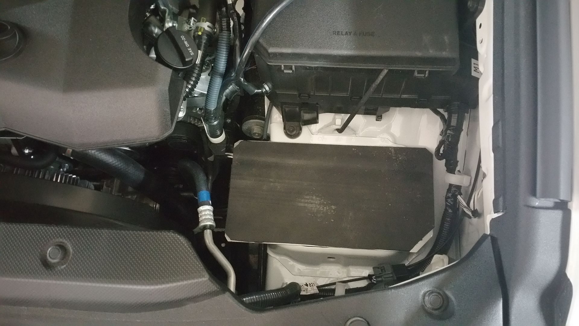

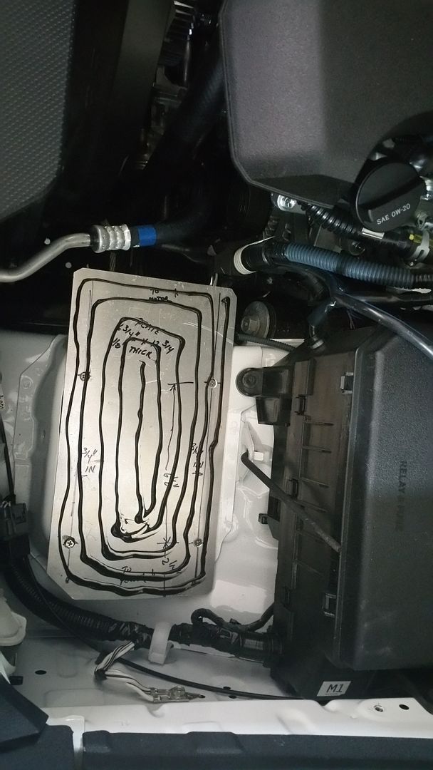

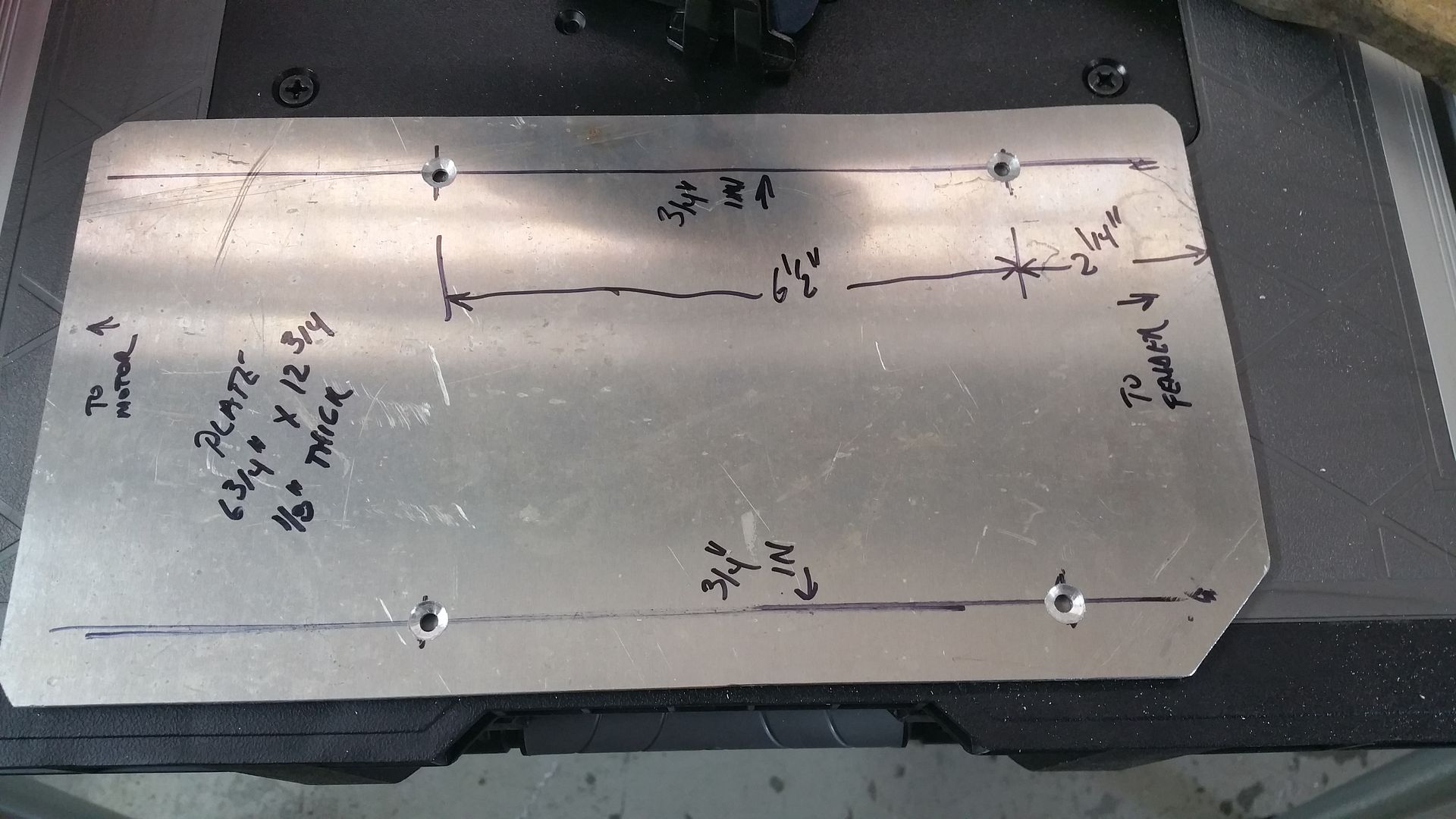

I had some 1/8" aluminum plate laying around. I cut it to size, drilled out some small holes, and siliconed it in place. After that I took some rubber roofing I had lying around, and cut and fit 2 pcs. of that into place, to supply a little cushion under this monster.
After the battery was in place...Murphy's f'in Law never takes a vacation day, so the hold down bracket was short. I had some 1/8" x 2" flat stock, so I bent up a new bracket to fit, and added the ROAM garnish...just to piss Jeff off.

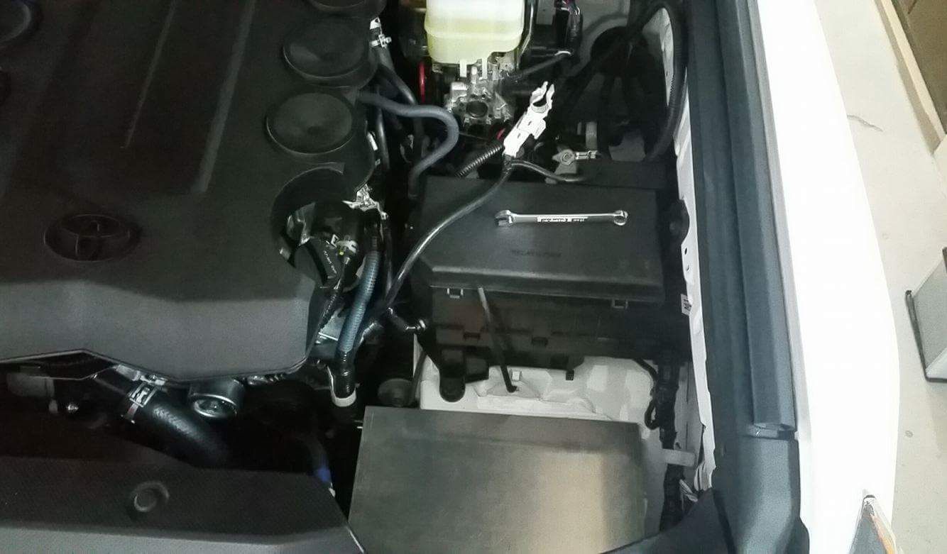

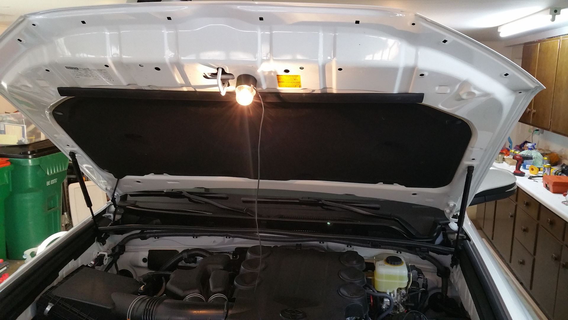

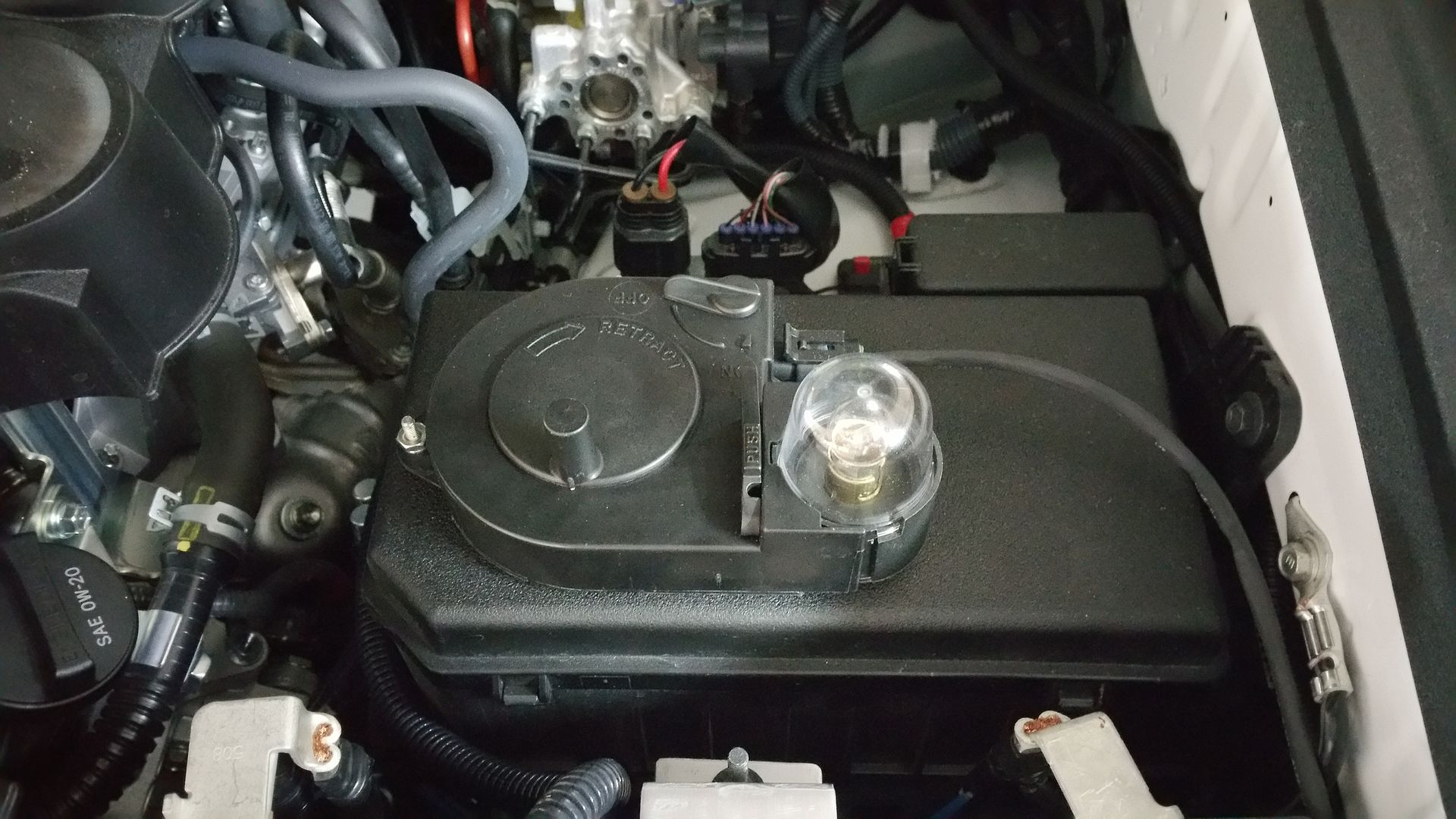

Any you old school Chevy guys may remember the under the hood light that was featured in the trucks back in the 90's...I saw one on Fleabay for 30$, so I always missed it. Now I just have to convert it to LED...it easily reaches the back of the truck, and is magnetic.

For us slow kids in the back of the room, could you explain a bit more about what you did and what is in the last picture of post #2? What is a NoCo charger? Thanks.
Sure...no problem..
The rear 12 circuit box is for running separate circuits for each plug/usb. When camping I like the option to charge everything and anything.
This what I put in...
Robot Check
I cut off the existing fuse holder, since it would fused in the panel
and this would be the cord http://www.amazon.com/NOCO-GC009-SA...=UTF8&qid=1454382927&sr=1-1&keywords=noco+sae to use between the panel and outlet..again, a bit overdone...but that's how I roll..
It Blue Sea 12 circuit panel runs back to the battery for its power, but also for charging from the solar. I run a small Dometic fridge 3/4 of the year, so once I get the solar panel mounted up on the roof (80-100 watt panel) when the truck is sitting, Ill plug into the panel, and into the NoCo charger (which is just a fancy little gizmo, I could've accomplished the same with a regular 12v male plug...but that's just boring) I'll also have to get a sense for how far the battery drops when in use.
