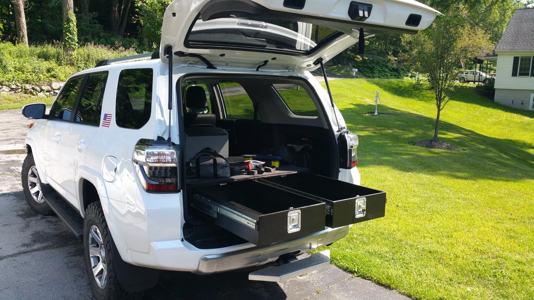

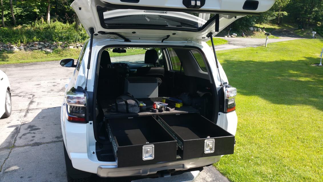

Slammed at work, building a house for my nephew, and just finished my drawers....one more thing out the way.

Drawers look amazing, please give us some specs and details on them.
Thank you!
Very similar to my last set...but 32" long. Constructed from 1/2" Baltic Birch plywood. I have a Google Sketch Up version if you want it. Drawer slides are 150 lb. rated.

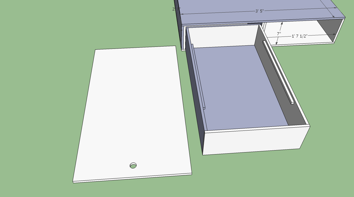

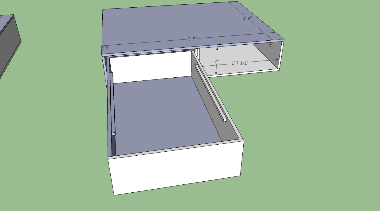

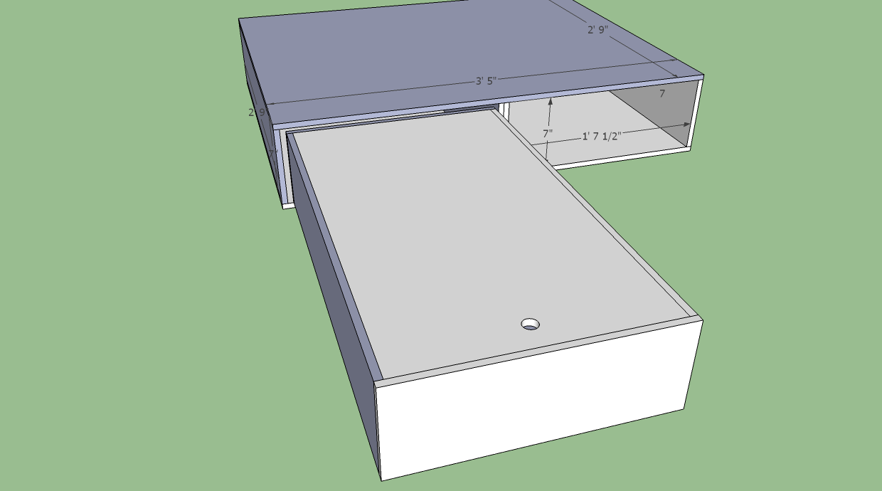

So, using your sketchup file (thanks again!), I modified it a bit to include a 'table top' for one of the drawers. When camping, I'm always wishing I had a tailgate or some flat surface to stand by and work / cook. I bring a table now and have to unload and unfold it. Why wouldn't this work?
It's a simple removable piece that would stow in the drawer (on top of the contents of the drawer). You remove it to get stuff out of the drawer (say, your stove or cooking utensils or whatever), replace it, and then work on top of it (with the drawer out and hanging out the back).
Thoughts?

It will work. With the details I can see, I would suggest losing 1/4" of height out of that drawer and running a 1/4 deep by 1/2" Dado around the entire lid/table top. With the supports you show if you had someone lean on one end or just had too much weight, it could flip up. With a full dado it would lock in on all sides. It will end up being the same height as the other drawer with the table on top. You could just use a full support on 4 sides too, same deal and you don't have to cut the drawer sides shorter. Just my 2 cents. Looks like a great plan!
