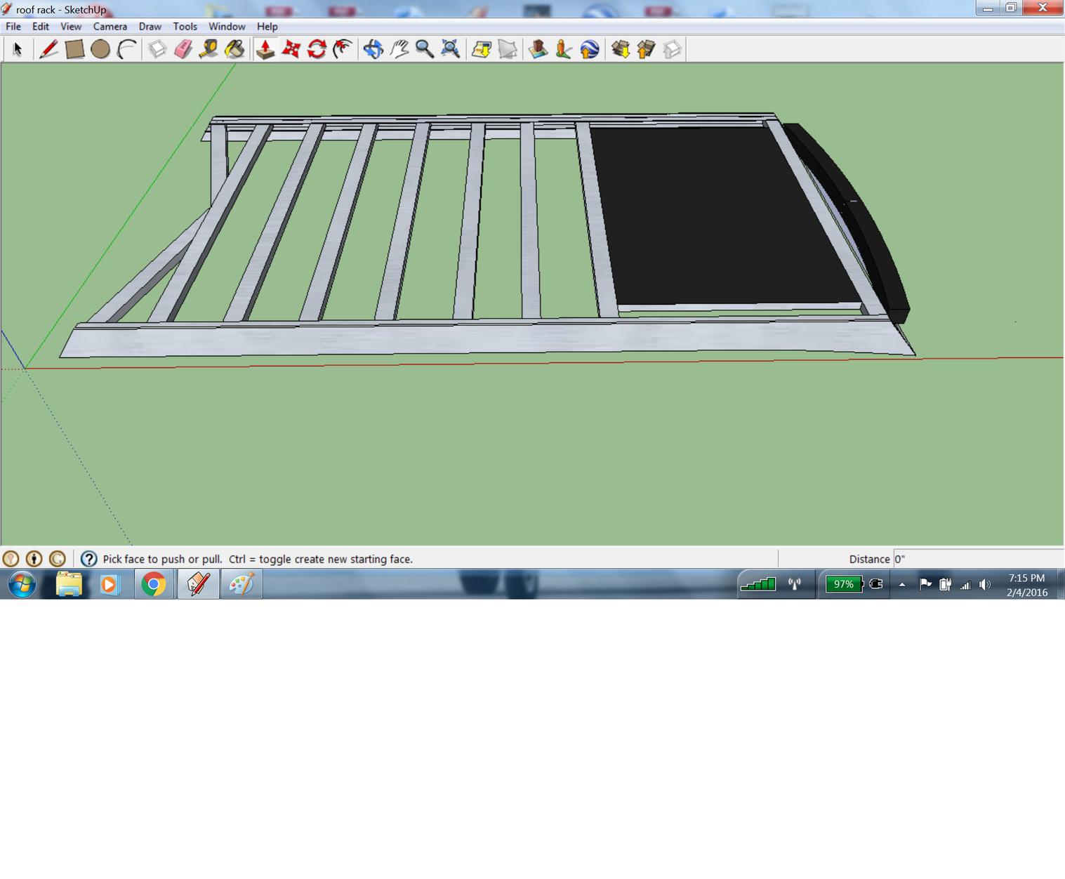

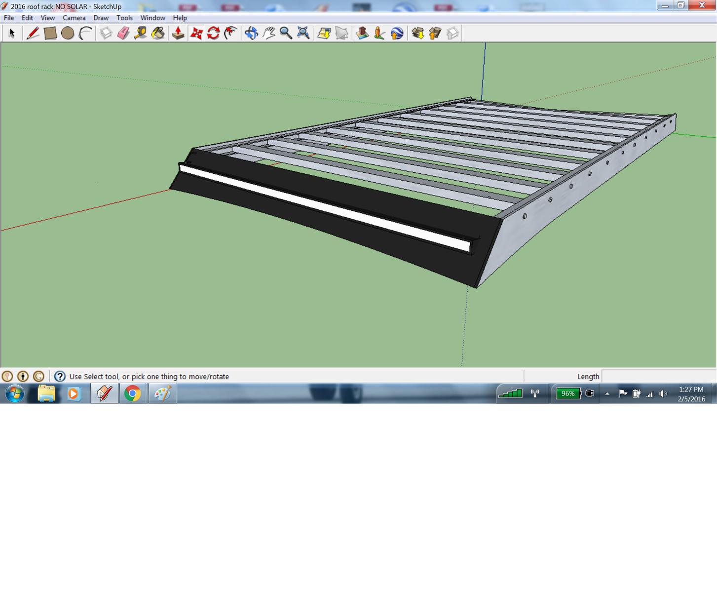

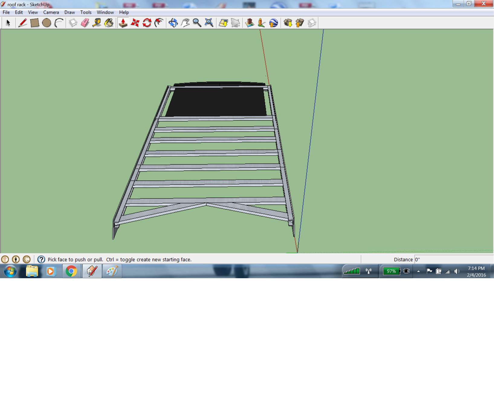

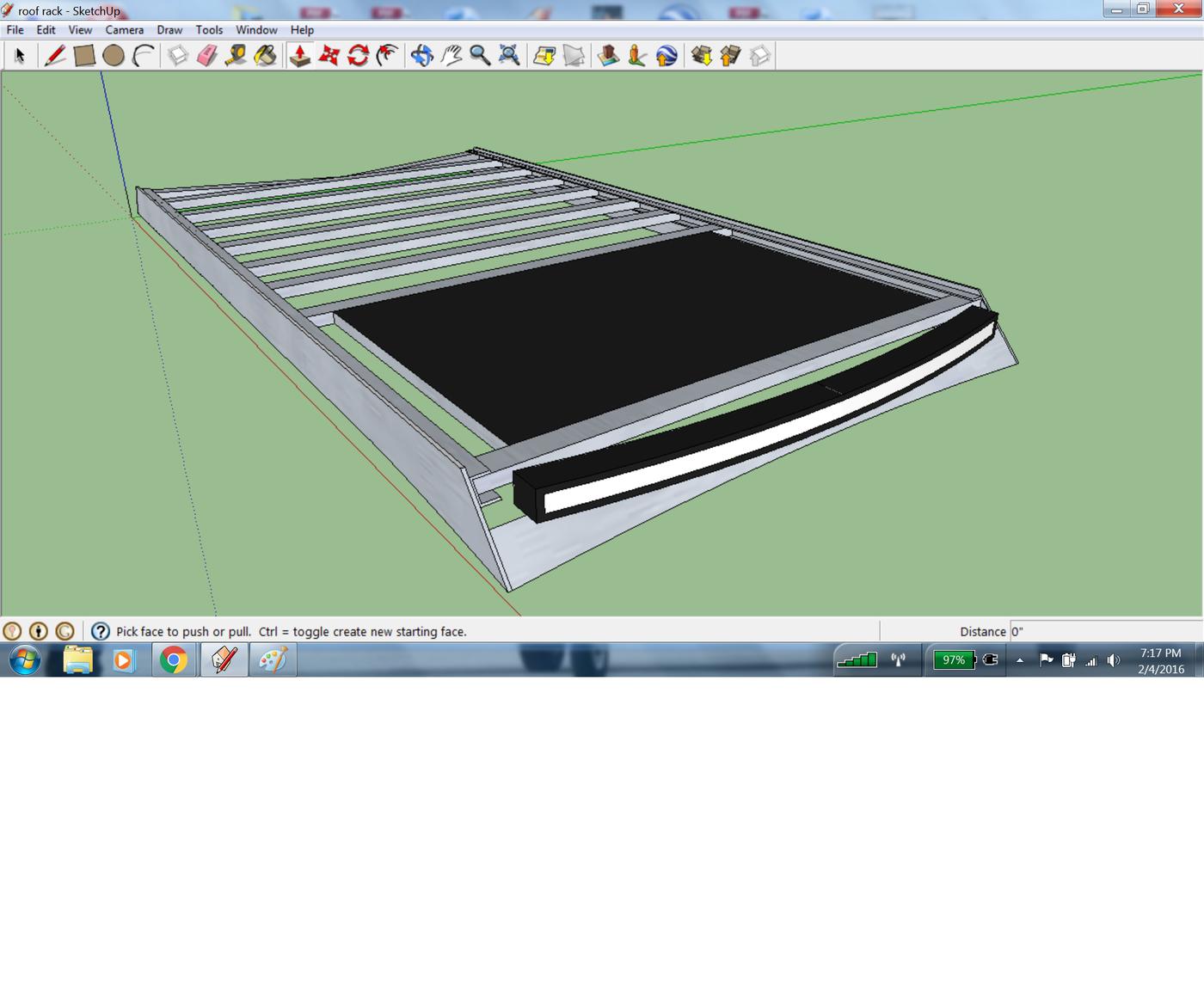

Roof rack is pretty much figured out...all aluminum with a removable 100 watt solar panel over the sun roof area, a 42" curved LED bar...maybe a single row. The feet will be bent 1/4" plate steel mechanically attached to the aluminum siderails.
At some point the ARB awning will get installed, and then figure out a mount for the hilift. I'm also incorporating E-rail down each side...hidden.
Weight comes in about 55-60 before solar panel lbs...panel ads an additional 20 lbs
Then there's an option of no solar, use a foldable 80 watt panel when I need it, and make the whole rack solid ( or possibly an insert for the moonroof)
I'm figuring a 42 " single row LED bar for an application like that.

Looking good man, the panel looks movable, is that part of the design? Also, are you gonna leave it silver? Black? Super White? :reddance:
Thanks!
Going to shoot for the silver look. I really like the the TEP wheels.
As far as the panel...as long as I can figure a way to hinge it and ultimately keep the top surface free of any hinges sticking up, I'll probably make it lift on the rear to take advantage of the sun.
Honestly...If I just carry a small jump pack, I could probably just pass on the solar. If I added correctly, I should only be in the hole for about $180 fit all the solar parts.
