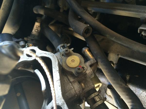

I joined this forum because i was having issues with the SC on my 3rdgen; which led me to the check valve between the TB and SC. Honestly, I could hardly believe that this would fix anything, but thought i would just rule it out before I spent money. I wasn't that easy finding out exactly where the check valve went, so i thought i would just drop in the pic to more clearly document where it goes.
after you lay over the TB, you can see the hose that is removed from the TB. I just cut that hose back about 3 inches and put the check valve in.
I can't exaggerate how many issues this stupid valve fixed for me, my truck backfired through the TB, ran like it was running out of gas and would hardly do the speedlimit on the interstate. my truck runs awesome now (for having only 6 injectors) and saved me a ton of time and money.
