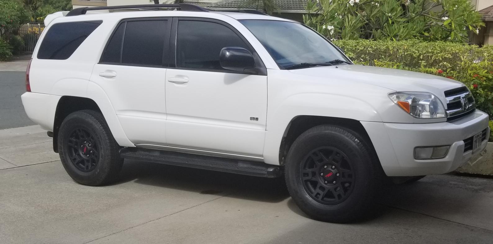

TRD Pro Wheels on Falkens 265/70/17 and Daystar 1" Leveling Kit

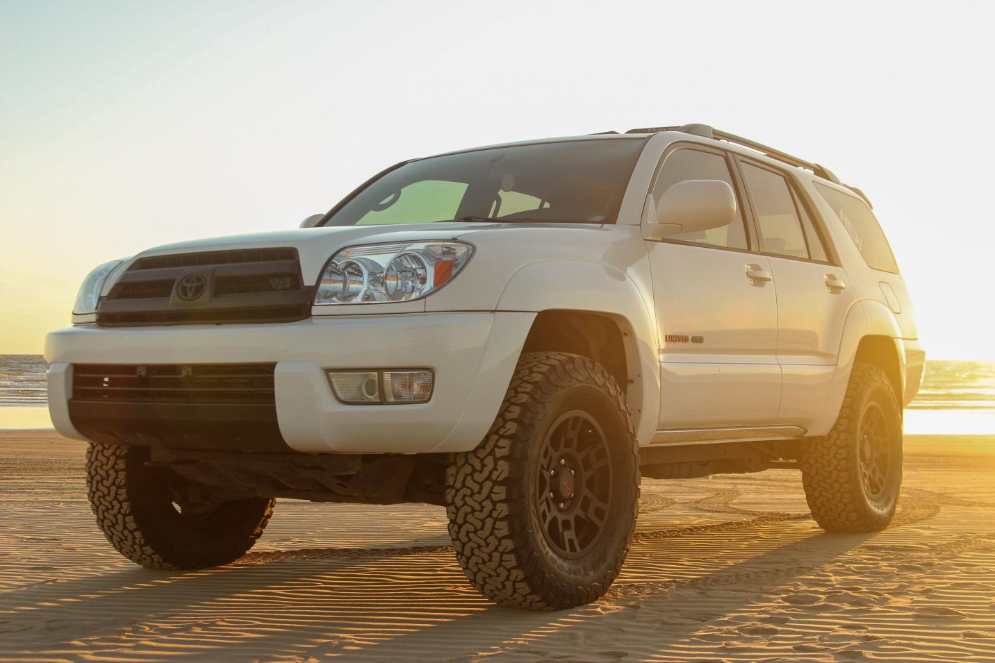

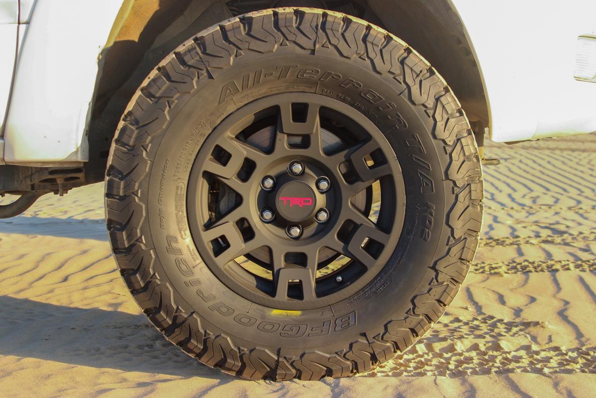

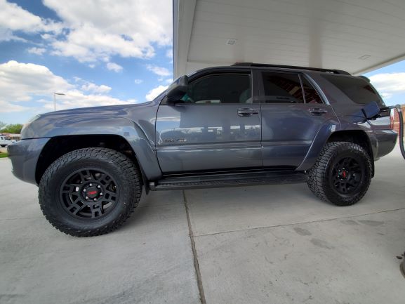

Just got these installed. They are wrapped in BFG KO2s 285/70/17. I have a 2.5/1.5 Daystar leveling kit. I don't know how but all I had to do to fix rubbing was move the fender liner forward and take mud flaps off. Thankfully no BMC was needed.

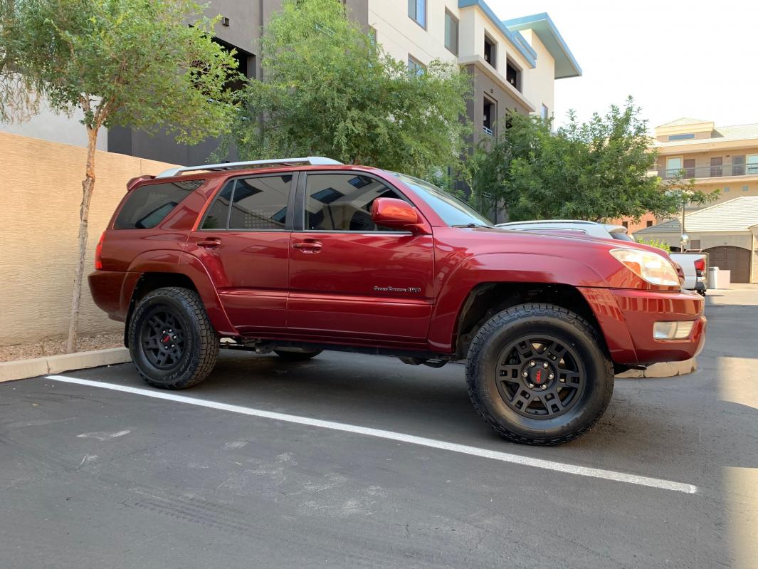

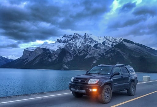

2005 V8 SportEdition 4WD, riding on Bilstein 5100's with stock springs. The front is set to the 1.75" setting, no height spacers in the rear. She sits almost level (the photo is deceiving and can make it appear to have a reverse rake).
The TRD Pros are wrapped in 255/75/17 Cooper Discoverer AT3 4s'. I also have some SpiderTrax for looks. Needed to remove the mud flaps and do a tiny bit of trimming.

looking good. thinking about the same 255/75 for my next tire. currently 265/70/17.
red and black never go wrong.

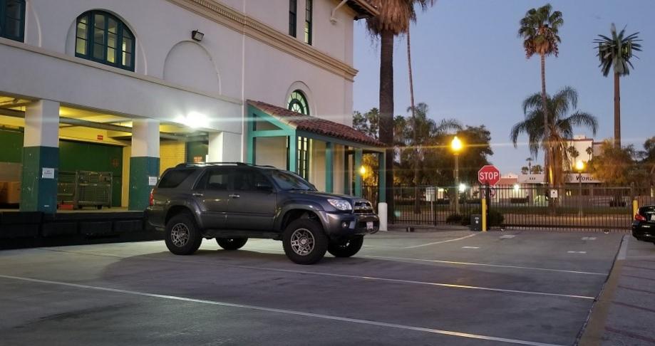

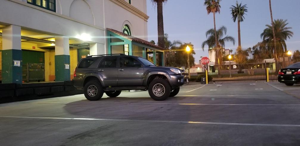

Bilstein 5100's, Ome 884/895e springs, SPC UCA and 285/70/17 Falken Wildpeak AT3w on TRD Pro Matte Gray wheel
