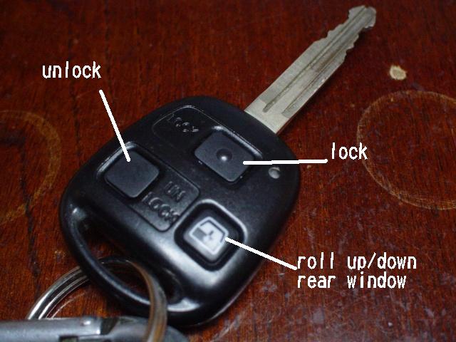

remote key
Hi, goodevening!
konbanwa☆ Mr.Luxury and everyone.
I attach a picture of my remote key.
We can roll up/down the rear window with remote.
Maybe it is normal style of our surf, not special one.

Re: remote key
joseyasu said:
Hi, goodevening!
You have to be kidding me. Now I had it. Why could Toyota not given us the same nice features of the Surf.
Damn, I want my rear window to go up and down as well.
joseyasu, now you did it. We will be on a mission to get this option!
The key fob is also nice. How much do those keys cost / part number. I wouldn't mind ordering one if we are able to program the key with the vehicle.

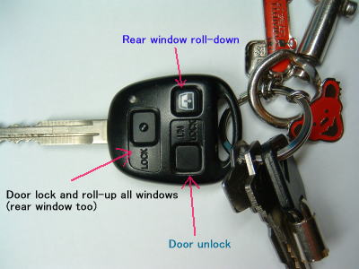

Re: Re: Re: Re: The answer from Japan
Luxury said:
Thanks for starting this new thread sharivan. It will be very useful. Right now, questions are being asked all over the place and it would be nice if they would all be posted here. I have a quick one to add, that the answer is probably no:
Can you roll up your rear window with the remote?
Hi Luxury,
Yes,I can roll-up rear window remote,
This is my SURF's key,
Pushing a LOCK button is continued.
All windows are shut.Rear window too,
4R's key same?

Re: Re: Re: Re: Re: The answer from Japan
sharivan said:
Hi Luxury,
4R's key same?
Sharivan, no, our keys aren't the same.
Our keys have a transponder in them which deactivates the engine imobilizer function (added security so the vehicle can not be started just by jumping wires).
We have a plain Key Fob (functions are not on the key itself), which gives us the ability to lower (not raise) the rear window, and unlock and lock the vehicle (with a panic button on the rear of the fob).
Hitting the Lock Button on our FOB, the windows do not do anything at all - they stay put.

Re: remote key
joseyasu said:
Hi, goodevening!
joseyasu,
Haha...I post...same pic,sorry!
But "REAR WINDOW botton" is roll-down only,
Roll-up windows... "LOCK button" use,
