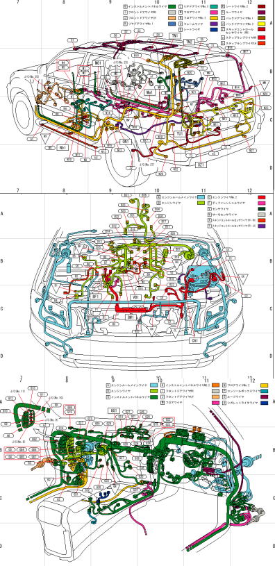

sharivan said:
I have some data,
CD-ROM for TOYOTA insides,and System data for Dealers,
(About 10 CD-ROMs conversion to my PC HDD)
But ...sorry...I'm not understand that data,
sharivan,
Thanks for the attachment. That is just the type of wiring diagrams I am looking for. I will compare this to the T4R diagram. I understand you have alot of files so hopefully this is the right one.

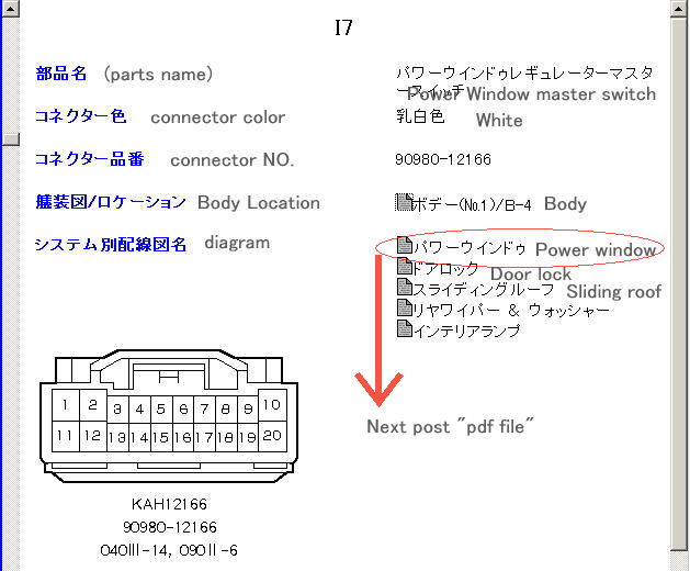

The wiring diagram that you posted was great, it helped point me in the right direction as to the rear window roll-up feature. It looks like we need to add what is listed on your diagram as "I7". Could you possibly get a description of this part and the part number, along with the part number for the connector? Also could you post the power window diagrams to further help with the connections to this part?
On a side note could you also post the wiring diagram for the rear fog light, as i am trying to wire it up and haven't figured out the wiring to the stock switch.
Thanks alot you really helped us out!
cpguy33 said:
sharivan,

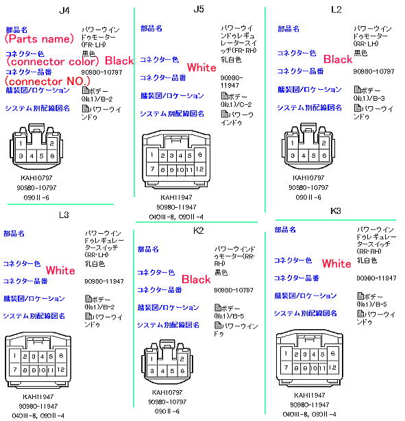

This?
Thanks for your help, but doing this modification dosen't really look like its worth it. We would probably have to replace all of our window switches and window motors because they are completely different. All of our window switches are wired back to the master (driver) switches while the Japan version is wired to the multiplex communication system, or Body ECU. If I were to undertake this I would need to know the part unmbers for "K3," "K2," "J5," "J4," "L3," and "L2". Which is probably only two connectors, one for the switch and one for the motor. And this is if only if I can get the switches in the US, which I would need part numbers for. I would also need to see the 'multiplex communication system" or body ECU wiring diagram.
