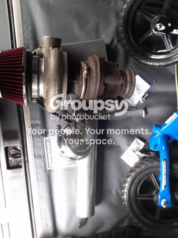

Ive been boosting 4 cylinders since I was 16 and have used holsets, great turbos by the way. Anyways what fuel mods are you going to run, injectors, lines, pump? What you going to use to control the fuel for engine management? How much boost, what AFR's and what type of fuel you going to be running.
Im really thinking of turbochargin my 4runner. I want to run 10-15psi on e85 but I'm not sure what you guys use for fuel control. I have an old Apex SAFC and greddy emanage sitting around but I dont see much info online of people running them.
Yup, the HY35 is a great turbo and should spool very quickly. My waste gate spring is a .5bar/7psi unit. I will leave it there for the time being. No immediate plans to up the boost. At 7psi no additional fuel mods are necessary because the factory ecu is capable of adapting and supplying fuel at this level. Clownmeat, another user here, is running around 7.5psi and is seeing AFR's around 12.5 in boost with the factory ecu tuning.
I am running a remote system rather than having a custom manifold built. I have my scavenge pump installed, oil lines are run (oil feed is not hooked up), boost gauge is setup. I just need to bolt up the turbo, run charge piping, and have a bung welded in for my wide band. I'm a graduate student right now, and have been very busy with work, so I haven't had time to finish, but I only have 4 weeks left of the program until I graduate so I anticipate being done in no more than a month and a half (ideally sooner).
Ive done tons of research and from what I found its not at WOT there is an issue with AFR's, its mainly in lower rpms but thats guys with superchargers. They are seeing knock at normal driving since the supercharger is pushing air at low rpms and fuel doesnt keep up and detonation accurs. I think with the turbo the low rpms wont be an issue since your not always in boost but an hy35 is going to be spool crazy on this v6. Without a good knock sensor or a way to re**** timing at low rpms you could run into future issues since you could be detonating and not even know it, even if WOT is ok.
Im going to try to run an hx35 maybe one day. I usually ran the hx40's on 2.0L 4 bangers and full boost (30psi was in the low 4k rpm). The hx35 and hy will spool like crazy! If I was you too be safe I would convert to e85. Even without timing control you would be safe no madder what, that fuel is so hard to get detonation. Ive ran 12.8 afr's and 26* timing advance at 30+psi without an intercooler or meth injection and it still would not detonate on e85 in my talon.

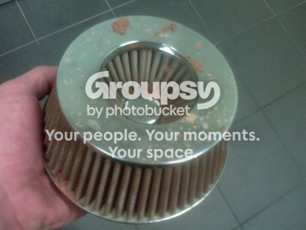

Can't wait to see this done. I haven't seen anyone else turbo a 4runner so I'm curious to see how it turns out. Your air filter looks like the one I used, also which just reminded me to build a intake so this quits happening. What are your plans for the air filter?

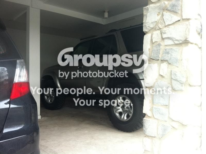

IMAG0610.jpg~original

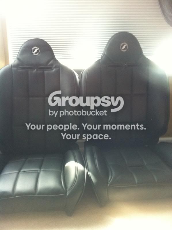

Waiting on Corbeau to make brackets to install these (apparently they don't stock these brackets so it takes 4-6 weeks to build 'em)

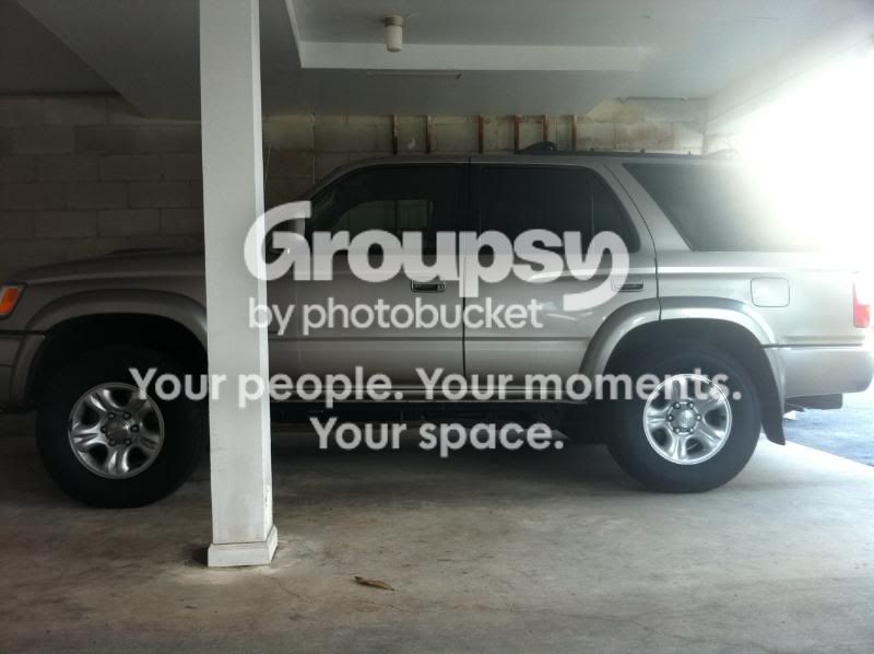

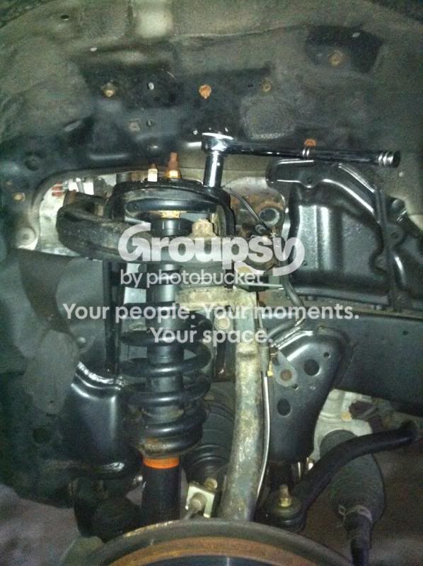

052.jpg~original

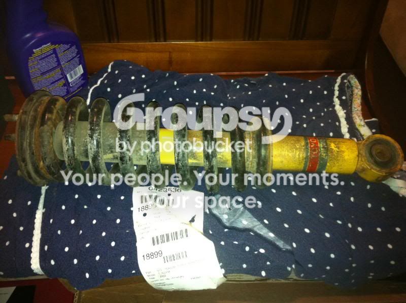

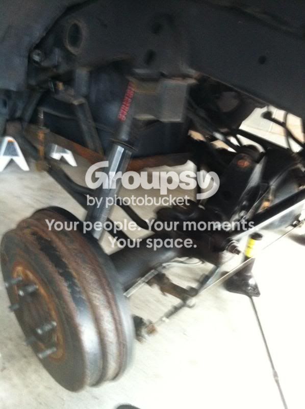

Took half a day for me to do the fronts and half to do the rears myself with only hand tools and running into various issues. Compressing the Tundra springs to disassemble the coilover and installing the 4Runner top hat was a royal pita with the autozone spring compressor and no vice/workbench. Taking out the rear struts is nearly impossible because there is so little room between the top of the strut and the chassis. The engineer that designed the rear shock mount should be killed. Coilovers and springs from Rocki Top Auto. LC shocks from Autozone.
I'm very happy with the finished product and used all Toyota parts. The ride is fantastic. Can't wait to go to Rausch Creek Offroad Park this weekend. More pics to follow.
How are the Corbeau seats holding up?
TRD Tundra Offroad Pckg Strut/Spring Assembly
022.jpg~original
Out with the old
024.jpg~original
Fronts in

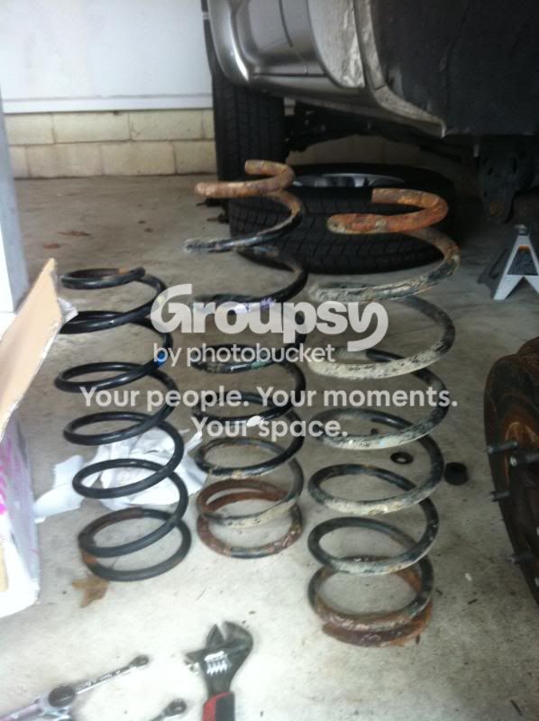

041.jpg~original
Land Cruiser 7 Wrap Front Springs (for the rear)
048.jpg~original
Out with the old
049.jpg~original
In with the new

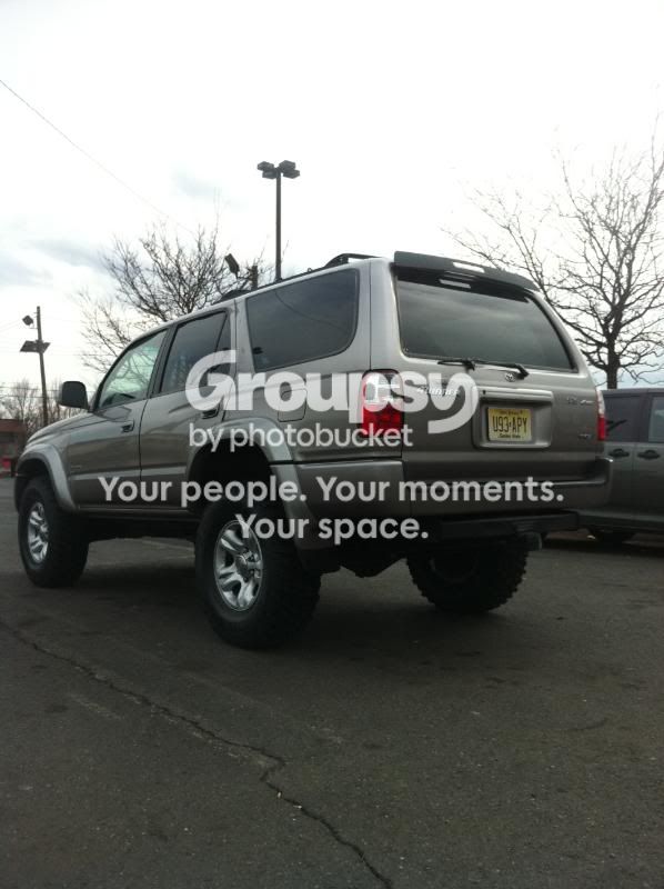

New Tires 285/75 16 MT's
056.jpg~original
Before

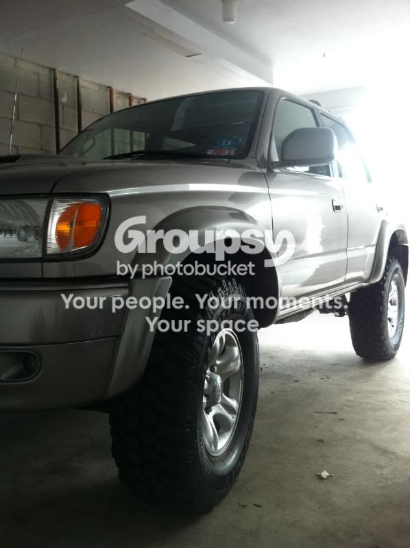

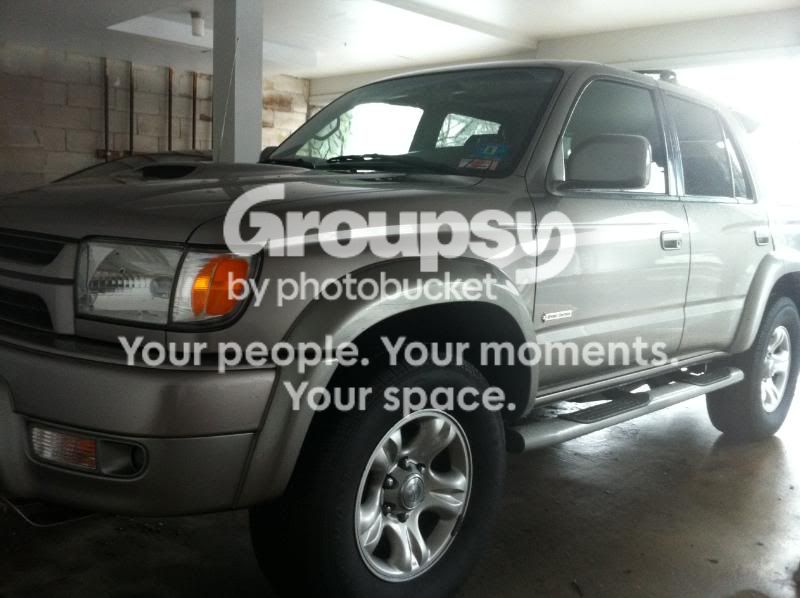

061-1.jpg~original
After
059.jpg~original

Looks clean. Seats look nice too.
