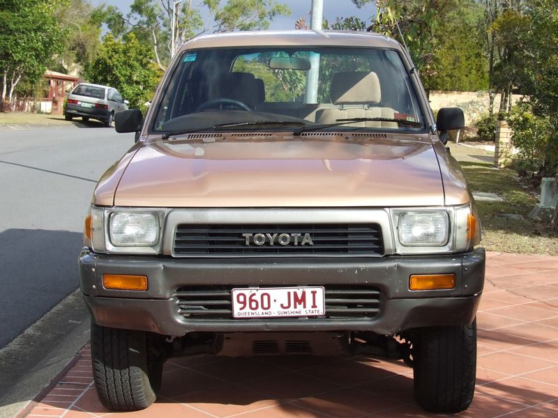

Image 1 is the 4R with Stickers

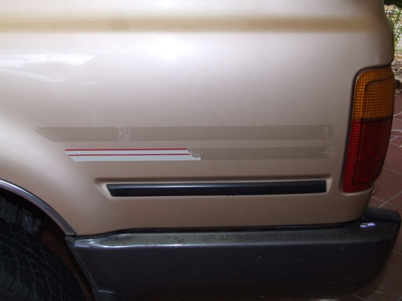

Slowly does it with the razor scraper and all top layers stickers removed in 90 minutes...

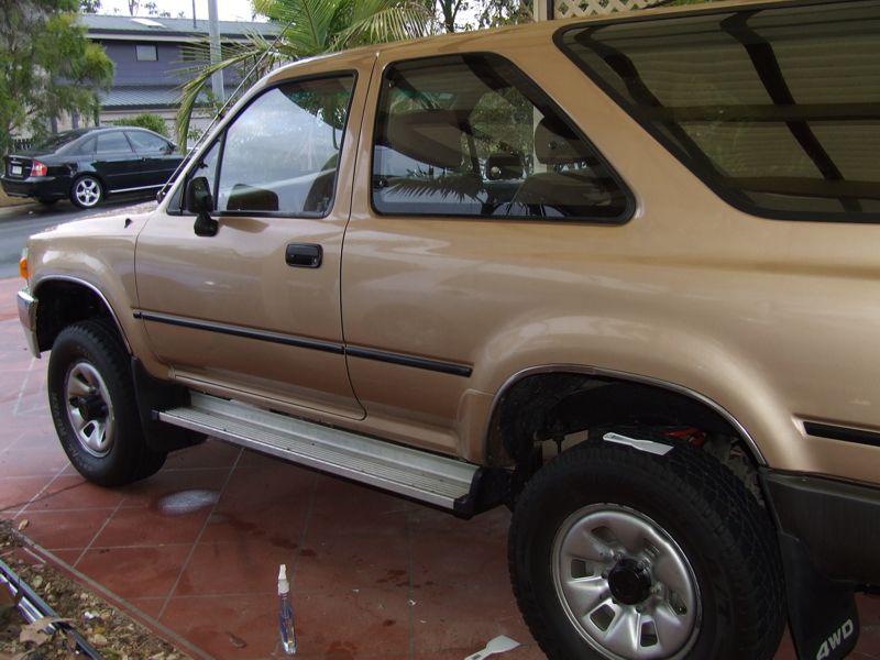

Sticky residue remains, so I gave it a good soaking with De-Solv-It citrus spray..

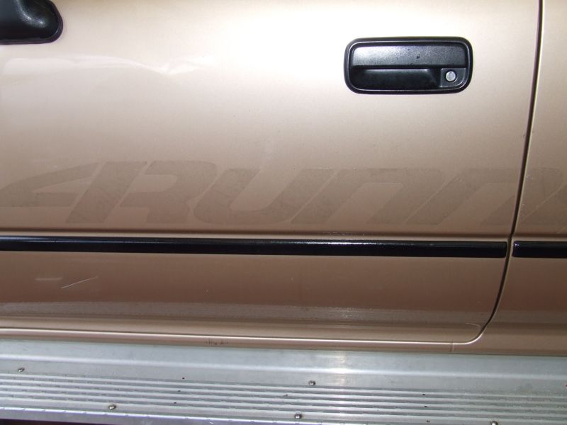

Once the citrus spray has softened the sticker glue (10 minutes) , very carfefully use a combination of the razor scraper and a few clean rags (and lots of citrus spray) and it all comes off.... hit it with a bit of polish and the paint comes up A-OK !!

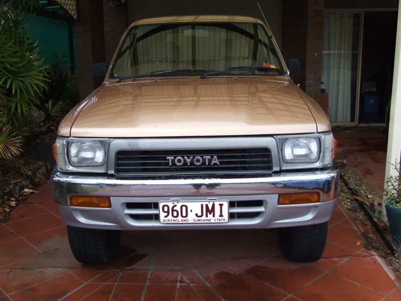

Next job is to replace the banged up front bumper bar. The original bar has copped a few big hits over the years by the look of it (and actually looks much worse in real life than it does in this photo)
A later model front bar was sourced from a SURF and luckily bolts straight on. The Chrome will soon be replaced with a charcoal metalic, and the light grey section will match the rest of the Sandlewood metalic paintwork.... and thus ends weekend number 1 on the Build Up...
