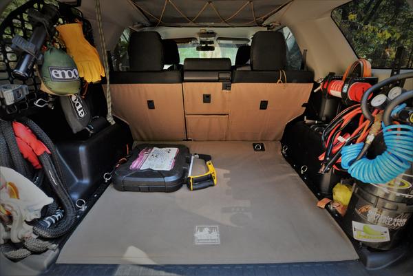

I built a set of drawers, carpeted the outside, and put a hinged flap across the back for a clean look and to keep the drawers shut. Everything is bolted down with hidden fasteners from the inside, again, to keep it looking clean; a set of self-tapping screws into the cross brace on one end, and 1/4" bolts/spring nuts bolted through to piece of unistrut that I bolted down with the cargo tray bolts. Very handy for keeping small items easily accessible when camping.

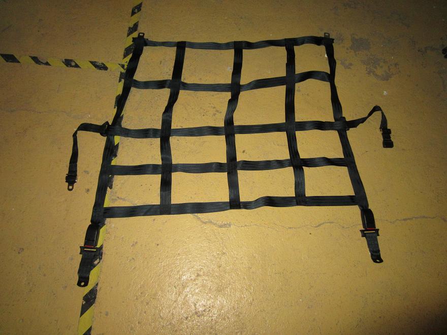

I was looking for cargo nets to use as a base to build a ceiling net, and I stumbled on this. There are 6 left - well, 5, because I bought one. Probably a tad too big for the ceiling mount but might be the cat's ass for some sort of barrier between the cargo area and rear seats.
Volvo truck seat belt webbing in a large size net.
At $10 it's hard to go wrong. If it doesn't work, it was cheap... I suspect I can find some use for this though.

I went that route because I didn't want the drawers to scoot out and hit the tailgate every time I took off. The flap also stops the handles from rattling.
And here I was thinking you were just trying to hide your stuff! But yeah, I hate things sliding and rattling, so I can understand the additional flap! :yo:

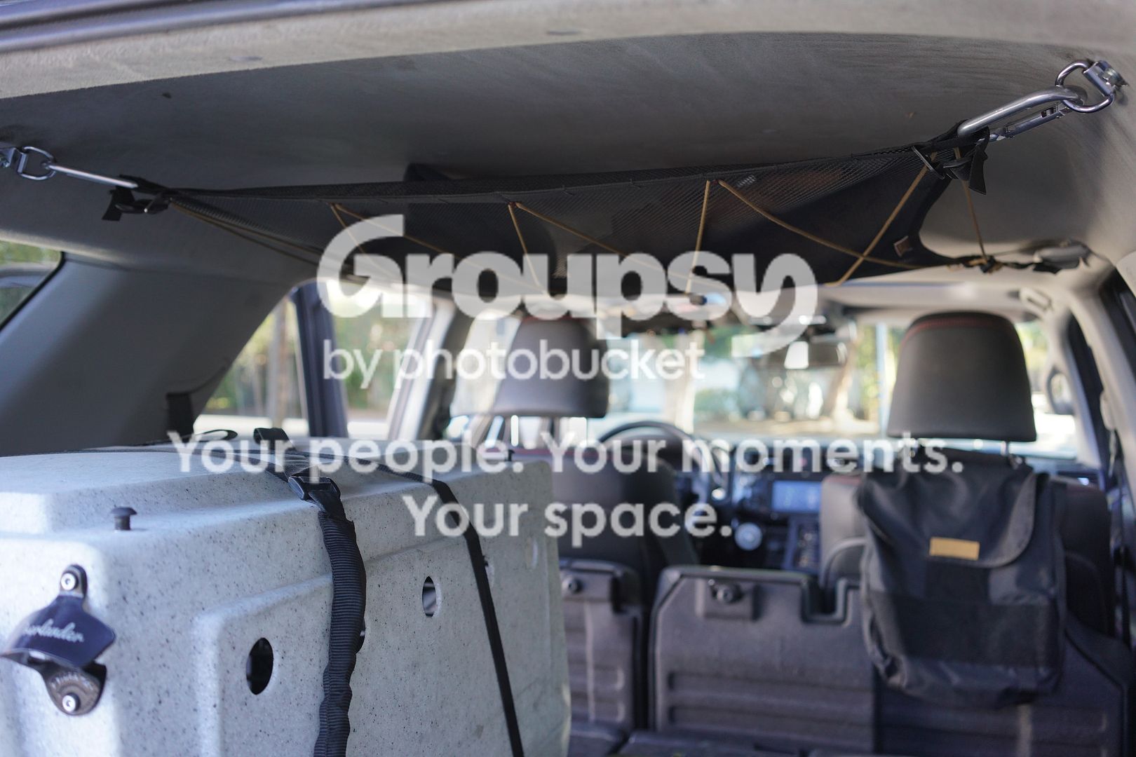

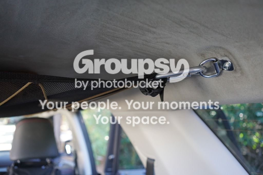

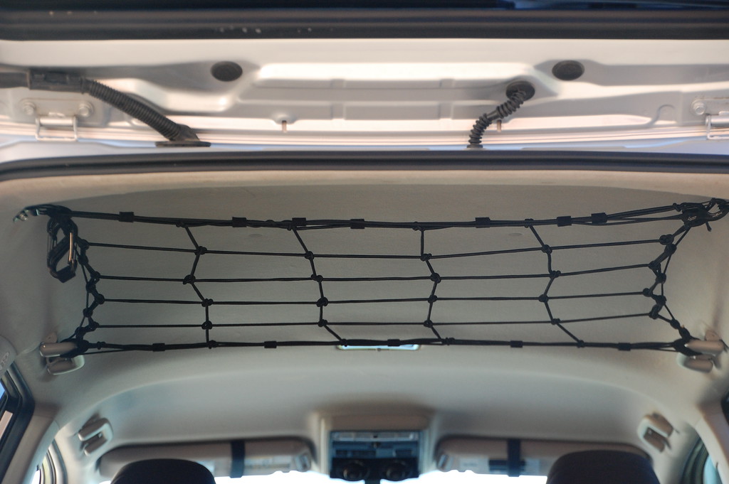

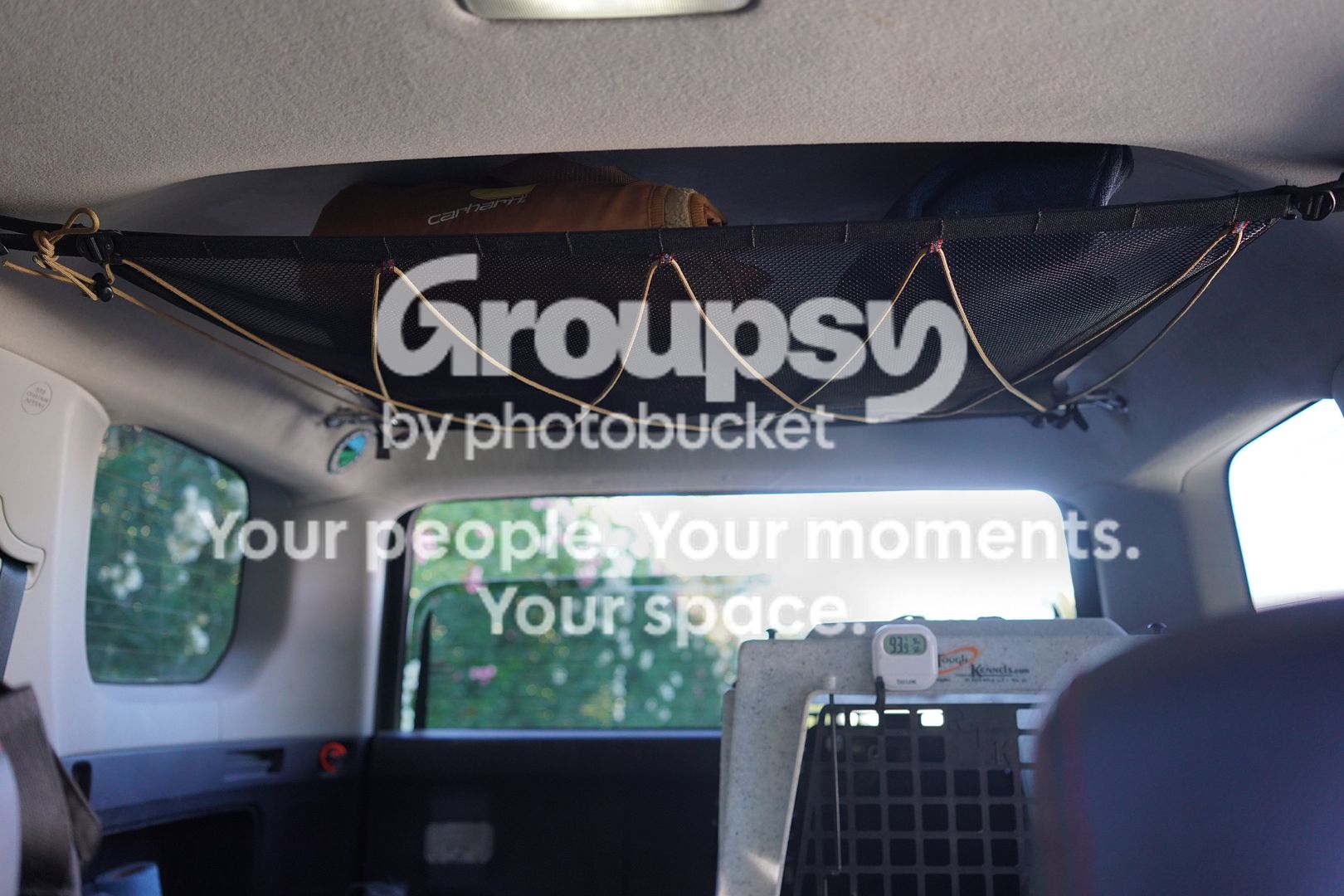

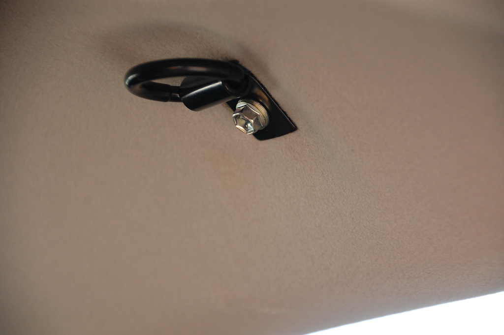

I built my ceiling net today. Ceiling net is built with 2 FJ Cruiser D rings (Toyota part 58460-35012, $11 ea) , approx. 16' paracord ($3), a 28"x28" ATV bungee cargo net ($15), a NiteIze rope lock ($8), and velcro wrap ($10).
Build a frame with the paracord, the passenger grab handles, the rope lock, and the D rings. The rope lock lets you pull the paracord super tight, easily. The grab handles can still be used. The paracord hanging down on the right will later be trimmed off.
You can mock the net up using zip ties - or you can actually mount it using them if you want. I chose to mock it up with them but then replace the zip ties with pieces of velcro wrap.
Cut the velcro into 20 2" strips and 4 11" strips. Each 2" strip goes in between a square of the bungee net to hold it to the paracord frame, and each 11" strip goes in the corner to secure it to the handle or D ring. You don't have to be exact in the size.
Finished product. Useful for holding light bulky items (fleece jackets, for example). I will use it while sleeping in the back to stow my clothes and such up and out of the way but still be able to access them fast for those 2am piss strolls.

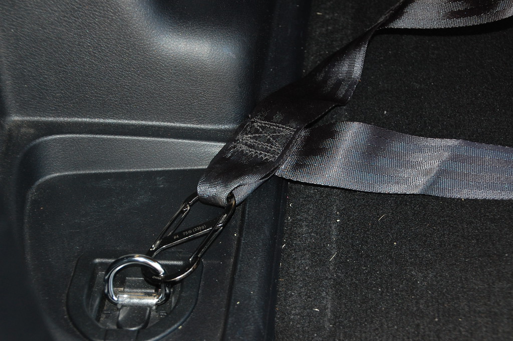

I also modified the $10 Volvo safety net shown in my post above to use as a cargo hold down, and it can be raised up to use as a divider between cargo area and backseat (not shown). It could probably be used as a bad ass ceiling net but it's fairly big and would run from the rear D rings up to the driver's ceiling mounted grab handle which is larger than I wanted. I cut the seat belt buckles off the net using a hacksaw, leaving loops in the fabric to use NiteIze #4 / 75 lb S carabiners on.
Shown very loose over this box; I plan only on using it when the seats are folded down, clipped into the child seat "bars" on the back of the seat and the D rings on the floor by the hatch. It will be tighter when used like that and will keep gear from flying forward in a crash or under hard braking.
I built my ceiling net today. Ceiling net is built with 2 FJ Cruiser D rings, paracord, a 28"x28" ATV bungee cargo net, a NiteIze rope lock, and velcro wrap.
Very cool addition! Those Cam Jams are the best. I have 3 in my truck serving different purposes! I really like the net storage, thanks for the info on the Cruiser D rings.
