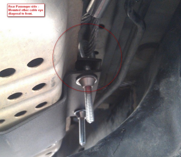

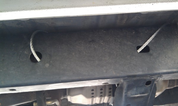

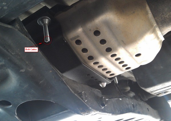

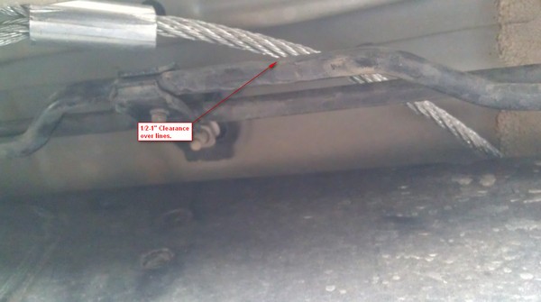

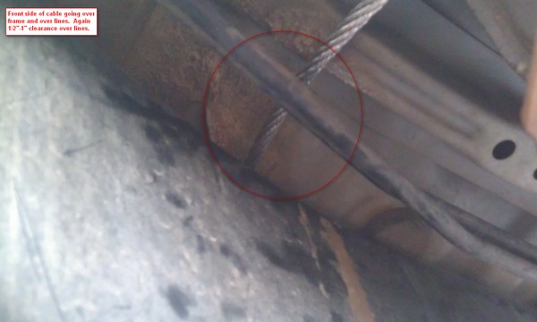

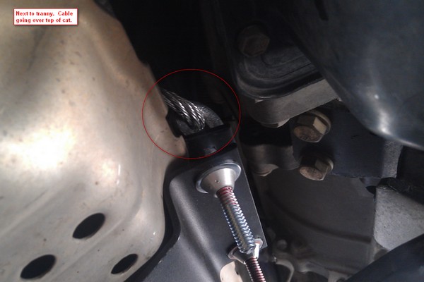

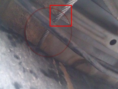

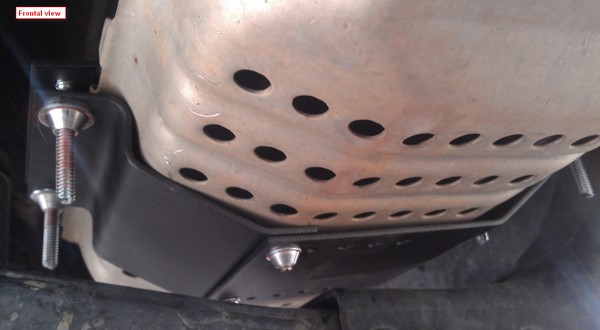

Well, paranoia finally got the best of me. The fact that I visit NorCal (most reported incidents of Cat theft next to Boston and Detroit) from time to time and because I heard last year in SoCal there WAS a big issue with it, I decided to get something to give me some piece of mind. I decided to fork over a $100 to purchase "The Catlock 1.0". I figured what's the use of spending more on the deluxe models and figured this would provide enough of a deterrent without breaking the bank. The CatLock took me about 30-45 mins to install. The longest part was tightening the 4 large breakaway bolts that hold the clamp to the cat. The second longest was threading the cable through the frame (IN/OUT) and over. I also grabbed my bolt cutter to cut off the excess thread. After all was said and done, I'm glad I purchased it. The cable itself was thicker than I anticipated, much thicker than what appears in the product picture. Also, I was concerned about the amount of tension the breakaway nuts would apply to the clamp. In the tutorial video found on YouTube, it appears they breakaway easily and was concerned that not enough tension would be applied to secure the clamp firmly in place, but fortunately that was not the case. In fact, it applied so much tension that I was worried it was going to damage my cat, but luckily it was just enough. The installation was pretty straight forward, so I didn't feel the need to do an official tutorial. By looking at the pics you can get an idea as to how I installed it. I initially was going to use the cross member located directly below the cat but was concerned that something may get caught/hooked on to the cable. Also if someone were equipped with a cable cutter, they would need to do so in an upright position thus putting the in plain site. Lastly, do to the taughtness/rigidity of the thick cable, the actual cables are pressed up against the bottom of the vehicle and do not touch the lines you see in the pictures below. Also, unlike what was instructed in the installation pamphlet, I mounted the cables diagonally from each other versus directly next to the other.

Nope not insane, but during the video tutorial created by CatLock. They demonstrate and attempt to cut through the cable with a recip without success. However, cable cutters or even a bolt cutter, that's different. If anything its a deterrent and at least the manufacturer will refund you the cost of the CatLock... "if your properly installed CatLock fails to prevent your automobiles's catalytic converter from theft". Need to keep reciept with order number, vehicle profile, and police report. Now, their definition of "...properly installed" could be their out. If my RNR is targeted, I'm just hoping for the lazy thief not the seasoned pro.

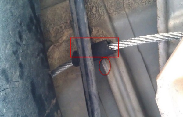

After driving a day after the install, I encountered a vibration noise while in gear and at idle/stop. Discovered it was a portion of the cable transferring the vibrations from the engine/exhaust to the body. To remedy it, I looked to see for an indicator where the vibration may have rubbed off paint/coating and then simply split a left over piece of hi-temp tranny hose from my trans cooler project and wrapped it around the portion of cable that was in contact with the body, creating an insulation between the two contact points. Vibration silenced.

Free advice. Do that where ever the cable touches something. The Stainless steel cable will act like a saw blade and cut through even the frame of the truck over time.
Thanks for the advise and unfortunately, I spoke too soon. The vibration is somewhat still there. So as soon as its cool, I am going to insulate all contact points between cable and vehicle. It's good using left over parts from other jobs; maximizes intital investment. Thanks again!
Fixed the vibration. It was being generated by the passenger side CatLock cable. Simply had to just move it around to where it was nolonger touching the lower body. Now, I'm good to go with piece of mind and no annoying vibration to remind me its there.
