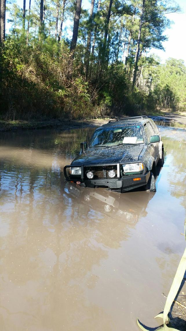

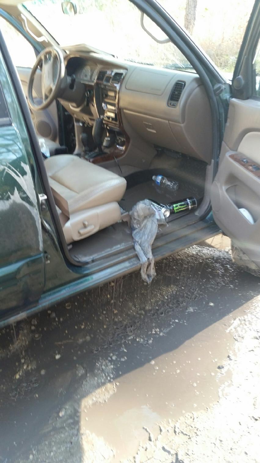

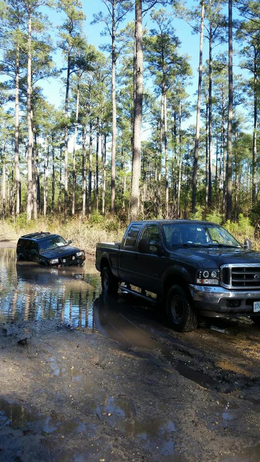

Tomorrow my 3.5 " Sanora Steel lift with the 2.5 shocks is supposed to arrive, and then this happens. I'm hydro locked and my floor boards are soaked. I don't yet know how bad things are going to be. I feel like someone just kicked me in the balls and then told me my mom is dead.

I try to avoid deep holes like this one, but when I must, Inalways try to take the right side first to keep the fender up. I've got luck a few times and found water in the bottom of my filter. This hole doesn't even look deep enough to get in the airbox

Unless the water was a lot higher, or you went in like a wrecking ball, there is no reason your motor should be hydrolocked. Your air inlet sits about even with the center of your turn signal. Perhaps you did not do as much damage as you think.

SHE LIVES!!! I was able to pull all the plugs crank it to force the water out, replace the plugs and keep cranking till she fired up. No ticks clicks or clunks.
What had happened is I was on the side of the water then it drop off and slide into the center all of a sudden. The slide pushed a wave of water out and then it came back choked her out. I got very lucky. None of my fluids got containmented.
I wasn't out screwing around. I was just trying to take a short cut cause I made a wrong turn.
