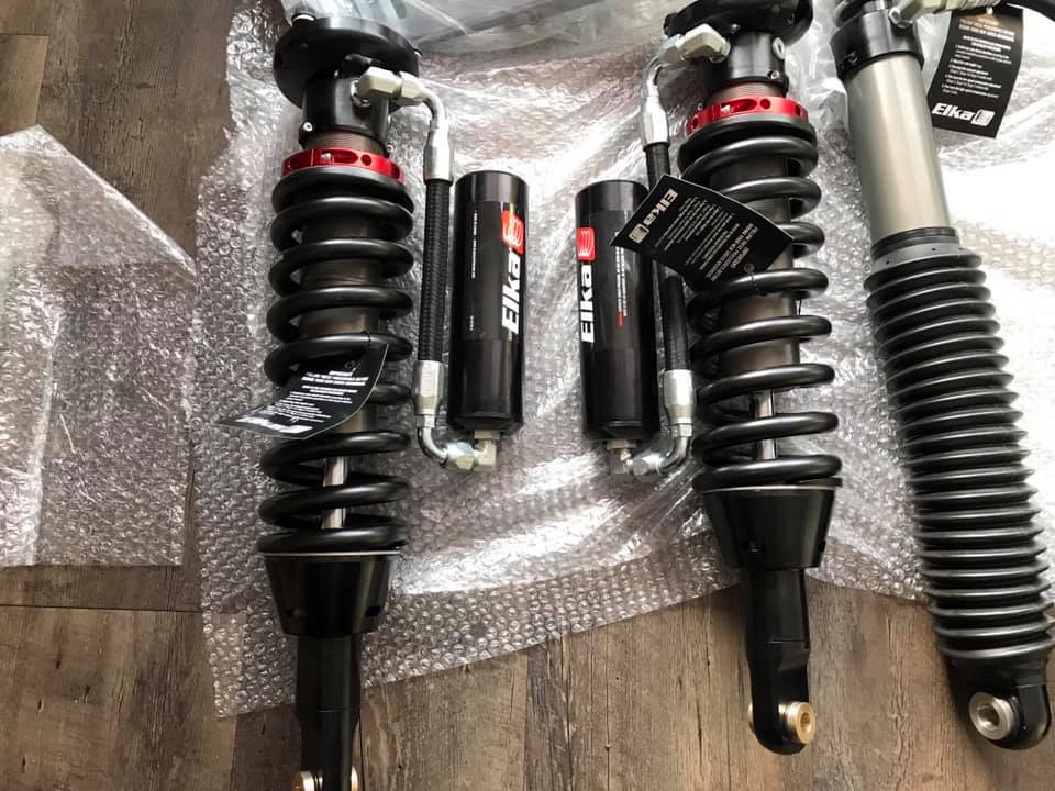

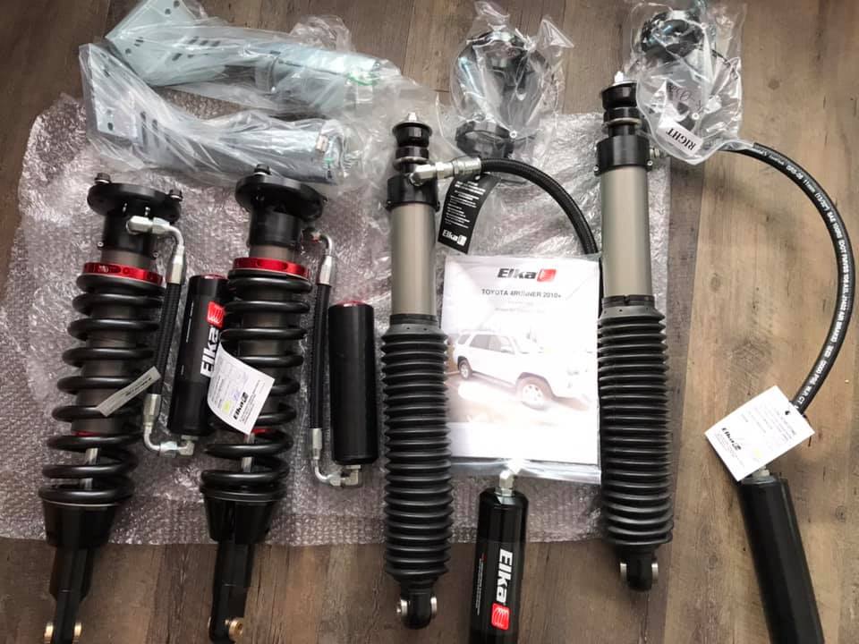

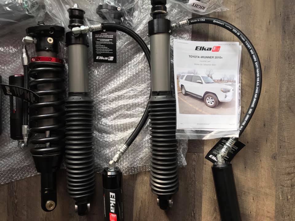

So I decided to give Elka a try since I don't see many folks have that kit on their rigs.
Plus, these are made of aluminum to battle against harsh chemicals in winter and I live in Canada where winter lasts about 8 months in my area. I also realized that parts would be easier for me to get when I rebuild/maintain them since they are made in Canada.
I have a 2017 Limited and my goal is to make it look leveled and have better performance than the Fox setup on the 2019 trd pro while off-roading. This may sound weird but I always wanted to have a trd pro but eventually, I realized it is all just marketing and my limited has things that are more useful than what a trd pro can provide such as full-time 4wd and dual climate control, so I decided to turn my limited into an unlimited.
I didn't get dual compression adjuster since I knew I would be too lazy to play with them down the road (hopefully I won't regret not getting them in the future). I will keep you updated as soon as I put them on as I am still waiting for FN six shooters to come so I can install the tires and suspension all at once. For the tires, I went with Falken Wildpeak AT3 P265/70/17.

Those look very nice! I'm familiar with the brand from ATV's and such, cool to see they are making stuff for trucks now too.
What spring rate did you go with for the fronts?
700lbs since that’s what Elka recommends. They all come with 700lbs springs unless you ask them to give you different springs but I already told them that I don’t have any additional weights and they still recommended 700,so hopefully I will be fine.

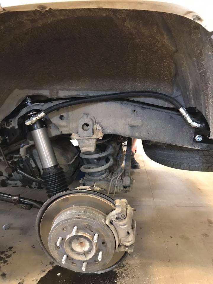

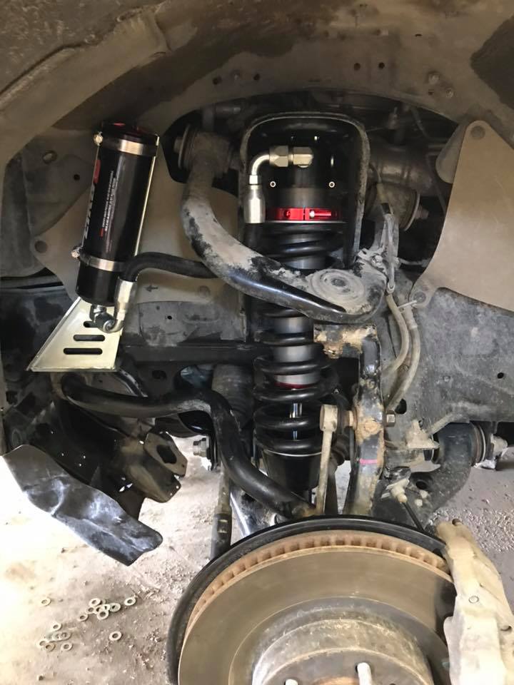

Finally put them on,the difference is around 3.5" before and after which I didn't expect,I am gonna adjust the preload ring to make it lower as I only want 1.5" like the TRD Pro.
