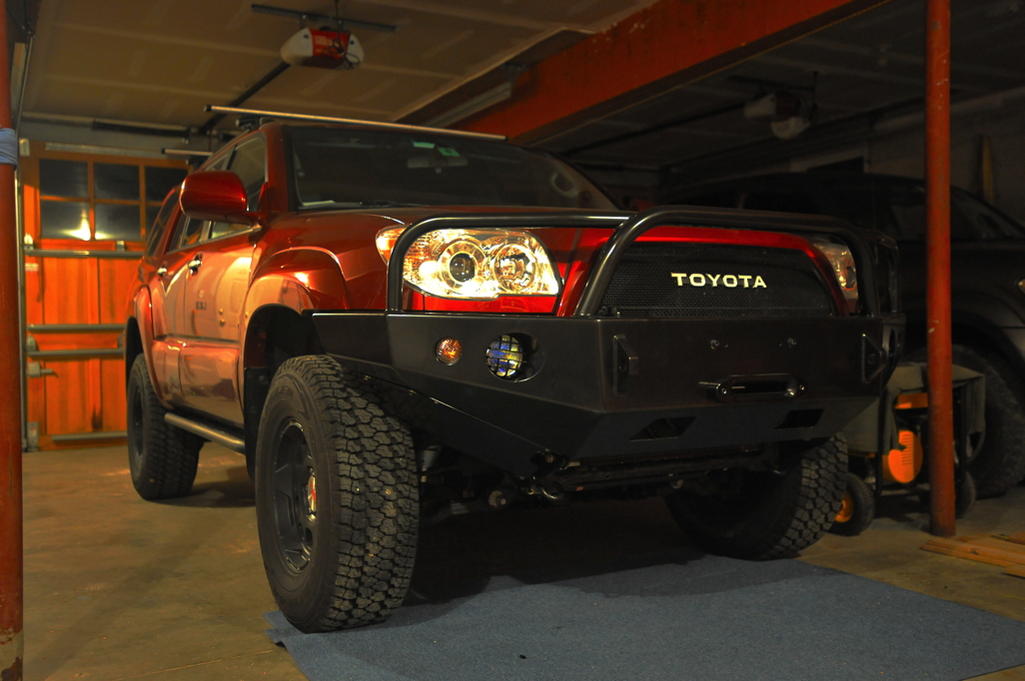

Shrockworks Bumper Installed !
Finally got it installed. Took most of the day what with wiring lights and the winch. This was not a real fun job to do alone but the opportunity arose and I ran with it. I actually installed my winch solenoid within the bumper which keeps it nicely out of the way; haven't seen anyone else do that but it works really well.
More later but I gotta hit the rack...
JD,
Congratulations on the Schrock! Looks great! Nice looking grill too. :bigok: The bumper moves quite a bit so you wanna get at least a 3/4" gap between the bumper and the fender. Under flex, the bumper can buckle the fender or push it into the door.
Hey Dave, Thanks
I really tried for a solid 1/2" ~ 3/4" of space between bumper and fender but I had everything I could do to get the 3/8' ~ 1/2" I did without taking the whole thing off and grinding the support bracket down so the bumper could drop lower.
The space looks a lot smaller in the picture than it actually is. I now realize why everyone's bumper looks like it was mounted unevenly; the front fender flare creates an illusion that makes it look like it is closer to the bumper than the front edge.
Hey Dave, Thanks
I know exactly what you mean JD.:) I had the same problem. 3/8" was the most gap I could get so ended up doing a simple 1/2" body lift.
