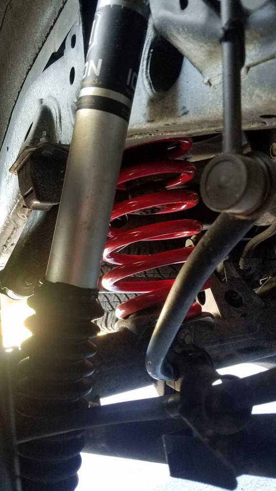

5100s up front and daystar in the rear. Rides better than stock! My next upgrade down the line will be kings with custom valving.

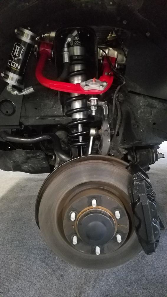

I just recently bought a Icon 2.5 Coilovers w/Reservoir, Icon 2.0 Rear Shocks, JBA UCAs(beautiful), and Dobinsons rear springs. Its a very solid system and should fall within budget or very close!
*DONT PAY SOMEONE TO INSTALL! The install can be done in your garage VERY EASILY will basic automotive tools and a few hours time. An extra set of hands is needed for the UCA install but the rest can be done by you alone if necessary. Take your time and enjoy turning the wrenches yourself.
