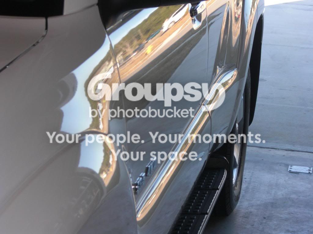

WTF? I don't know if anyone read my last post, but after dish soap, clay bar, rubbing compound, 2 washes, and 2 waxes, I thought I rid my ride of the fingerprints that were on the truck when purchased. after a few days of rain, I notice they are still visible, and my OCD will not allow it. can a good detailer possible know why they are there, and how to get rid of them? I don't know what could have caused them, I will try to get a picture of them, but I doubt it will come out. they seem like police dust prints, they are black, my only idea is possibly a chemical on a hand that burned the paint maybe? no idea, just frustrating.
Can you post a good macro shot of it ? I'm curious about those as I had something similar on a white Prelude , years ago . No , I didn't see your other post about this .

well unfortunately It's not as easy as thought to get pics of the prints, and the dull spots aren't showing up well either. If I get pics I will post them, will have to try different lights, it's pissing me off though, the dull spots more than the prints now.
Try setting your camera to a slower shutter speed with the flash off on a tripod to capture the problem area(s).

Can you feel the fingerprints with your fingers? Are they on top of the paint or embedded? Do you know if the panel was repainted?
Well, I can tell you the panel(s) with the fingerprints have been painted before! When the panel was being preped the tech had sweaty hands, and the fingerprints are the salt from the skin. I've seen it many times, I've even seen entire hand prints come back through! The only way to get rid of them for good is to repaint! You can believe me or not, but I'm 99.9% pos that's what it is!
