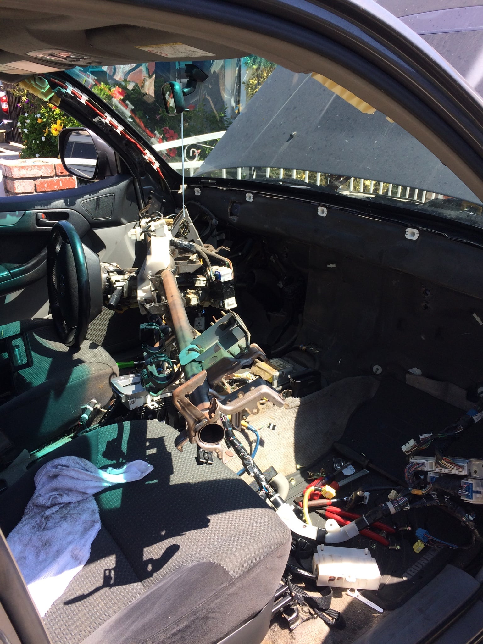

I had to tear the dash out anyway to replace it (warranty...my old service manager just gave me the dash)...
With the pad off, and some of the ducting, same symptoms. All the servo motors seem to work fine through the various settings.

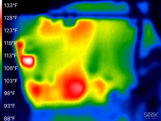

Here's a thermal image shot of the heater box where the core goes after warming it up..
Not a lot of red, and mostly cool on the passenger side. That explains things.
I proceeded to tear out the HVAC box...What a chore. I cut the tanks off of the core when I got it out...I'd say 70% of the tubes are clogged. The tubes are tiny...a .030" wire won't go through even the clean ones.
