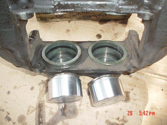

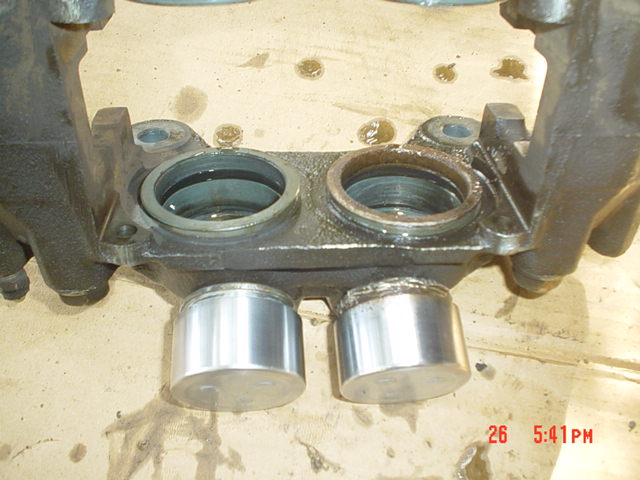

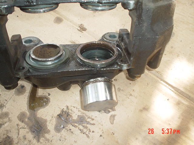

This is what I found after removing the right front Caliper from My 2004 Toyota 4Runner . One of the pistons was frozen (rust) outside of the fluid seal. It looks like the rubber boot did not keep the water out. I replaced it with a NAPA re-man Caliper. The left front I rebuilt with a Seal Kit from Toyota. They also sell the pistons.

Piston
Do you happen to remember the price on these items? How hard was it to remove the piston? Did you need a tool, or did they just come out?
