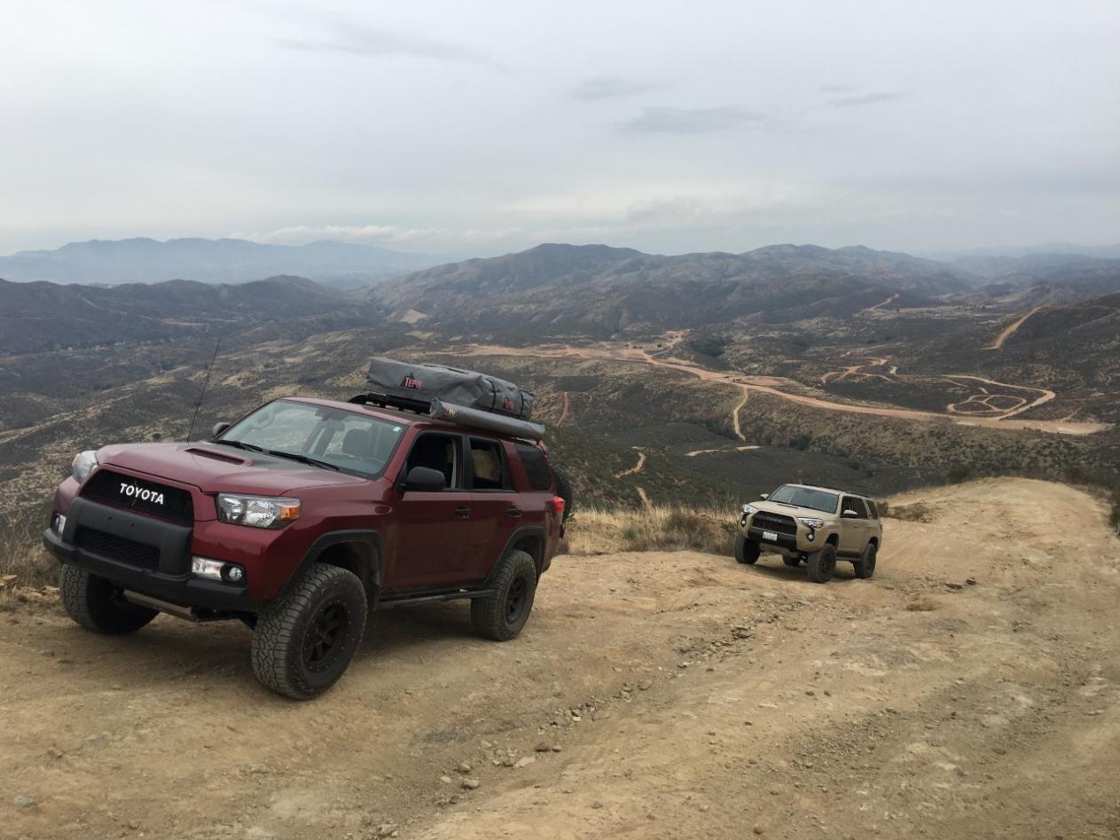

Also ran their crossbars but on a 10-13 Trail. I didn't get any wind noise until I mounted my RTT and only above 50 mph.
My setup
