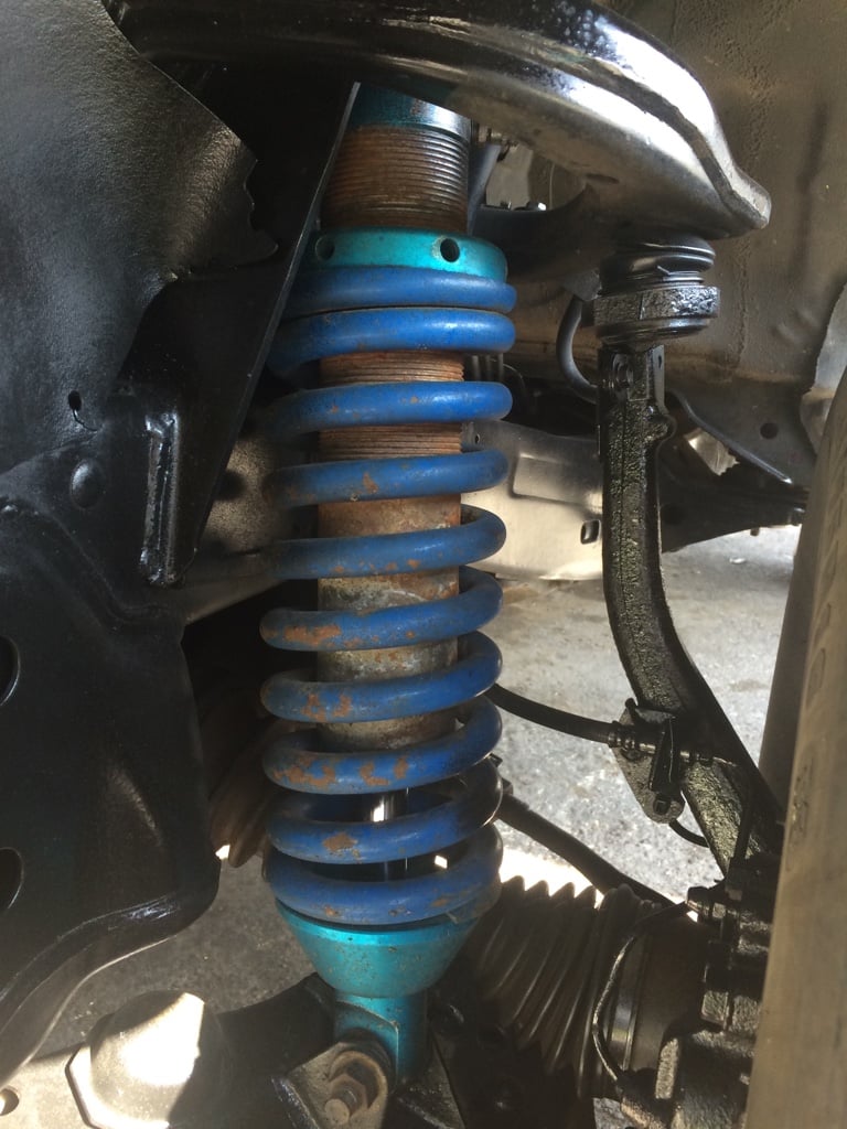

ok so guys, once again i need your help. last summer i took my C.O. apart cleaned, painted my springs and clear coated my shafts after i adjusted them to they height i wanted them at to protect the threaded part.
well that didnt last long. a couple months later (just starting to get into winter, not even in it) it was looking like crap... :hurt:
so im thinking about taking them apart again and wanted to figure something out how i can make them last longer without looking like crap.
i need to work on taking better car of them.
Man for a second there I though you really clear coated your shafts, then I realized you were talking about your shock bodies when you mentioned threads.
So you can't paint these things because the coils move a lot more than you think and will mess that all up. Like mentioned above a little WD will help before a storm or something. But that stuff will get caked with dirt which will then get on your shafts and may damage seals... So be careful with that and how much you out on there.
The best answer is just you need to keep them clean. They are corrosion resistant so spray them down with water often to wash off any debre. They key is to do it right when you get home from a day of wheeling before the stuff gets a chance to bake on there. These Coilovers along with UCAs just require a little bit of attention with cleaning and lubrication. But if you stay on it they will always work great!
Wow those things are beat up. Depending on how DIY you are you can actually replace the shock bodies if they are that damaged. It would probably cost more to get them re-coated than to just replace them. Shock bodies should be around $65 each, and you can find you tube videos that will show you how to disassemble the shock.
Or you can send them to King and have them fix them for you. If the bodies do not need to be replaced I know King charges $120 a shock to disassemble, clean, put in new seals and oil and polish the shock shafts. All of which again you can do yourself with a little effort.
After you get them cleaned up you need to google image search for coilover shock coil covers. There are many different ones out there, but they basically cover up the shock to protect it from the elements. This is not the end all though. You will still need to take the bags off 4-6 times a year to make sure it isn't full of stuff and clean if needed.
Yeah I told u guys.
Yeah they don't leak nor have ever had any problems with them over the close to 50k miles I've put on them and buying them used with 30k years ago.
Yeah they put those bags on dirt bike shocks and atvs that I'm used to.
I am very mechanical and these do not scare me at all. I've rebuilt my dirt bike shock a few times and it's basically the same.
