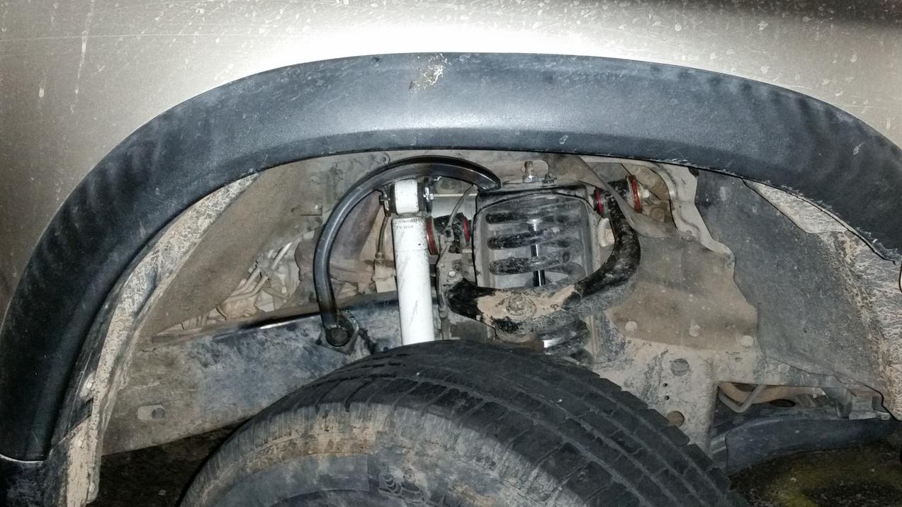

tundra bilstein 5100 yyyb with 1/4" top plate.
custom shock hoop and second shock, i think its gas adjust? i dunno came off the rear axle when i did the lift.

with the way the geometry it is the send shock damps progressively as the arm swings up, which is what you want since it will lessen bottoming out.

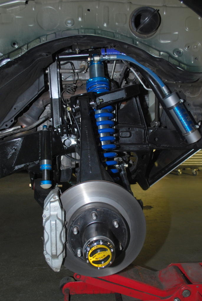

If you were to keep the UCAs mounted how they are how would you extend the coil bucket? Wonder if we could just use these solo motorsports mounts? This pic is off a 2nd gen taco but they make them for the 1st gen. Replaces the bucket with this hoop, tabbed for a coilover and bypass.
Yea I was thinking SUPER simple. Extend the shock bucket and frame notch, stock mounts on everything, longer shock and a hydro.
I may be wrong but that looks like a 2nd Gen Tacoma/4th Gen 4runner front. Not saying you couldn't do it with ours too.
