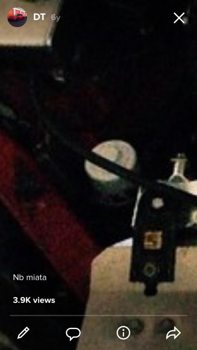

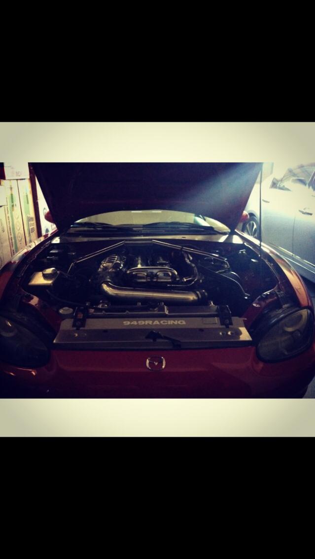

I've never seen anybody do this with their 4Runner, what problem does it solve?
Why? For the same reason why people buy the Fumoto oil drain plug. So you don’t have to take out the skid plate and it allows a clean and mess-free removal of the oil filter. I had it and the fumoto oil drain plug on my 99 Miata and it made my life so much easier. Coupled with the fumoto oil drain plug you got a beautiful and useful thing.
