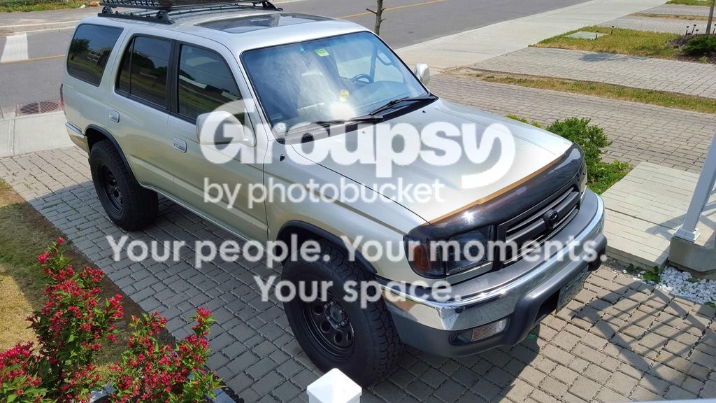

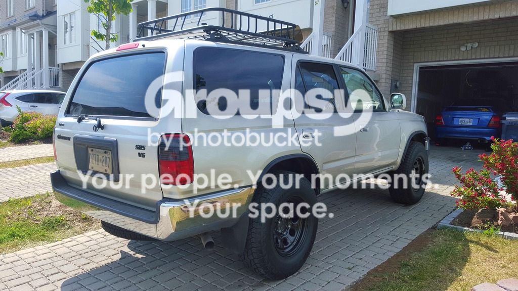

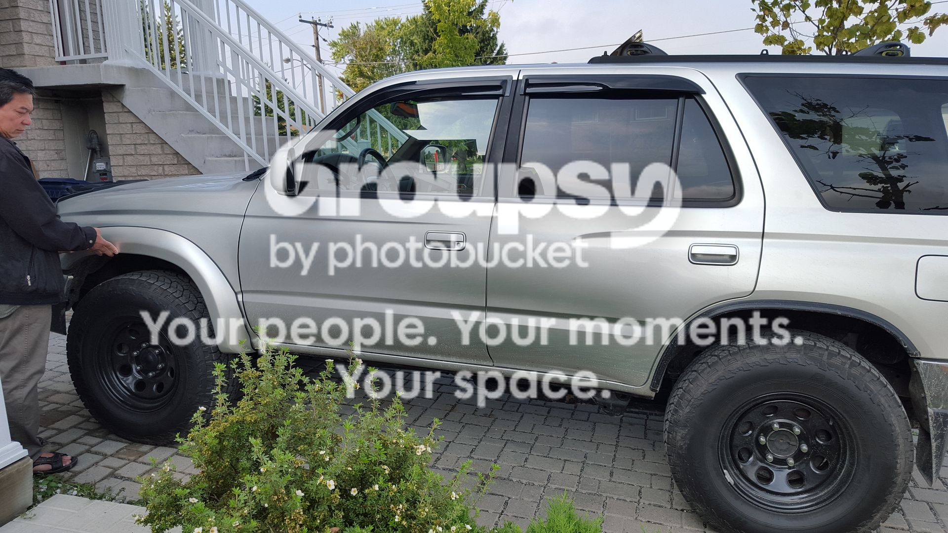

Off work today so decided to add a slight tint to the front headlights and rear turn/reverse signals. Did about 2 coats front and back
Before
20160619_112524_zpspliw3btf.jpg~original
20160620_104630_zpsz9upklgh.jpg~original
Protege getting neglected in the garage :(
20160620_104848_zpsldi9r7hh.jpg~original
I also plastidipped the rear emblems. I did not realize there were so many back there (total of 5!) on the tailgate. I will probably remove the "Toyota" and "V6" logo to make it look cleaner.

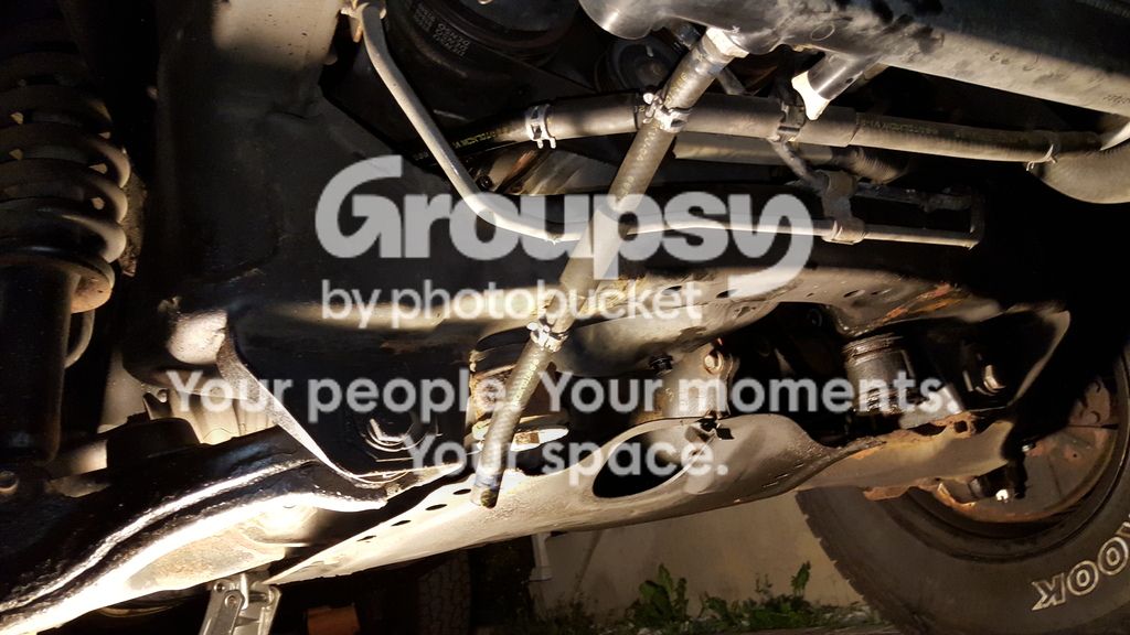

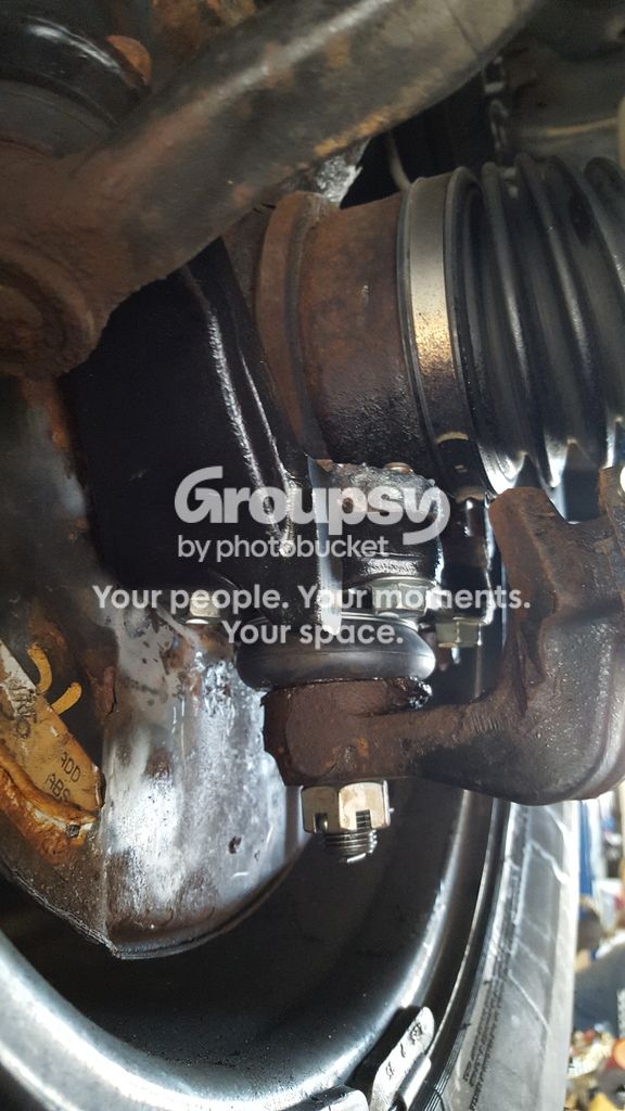

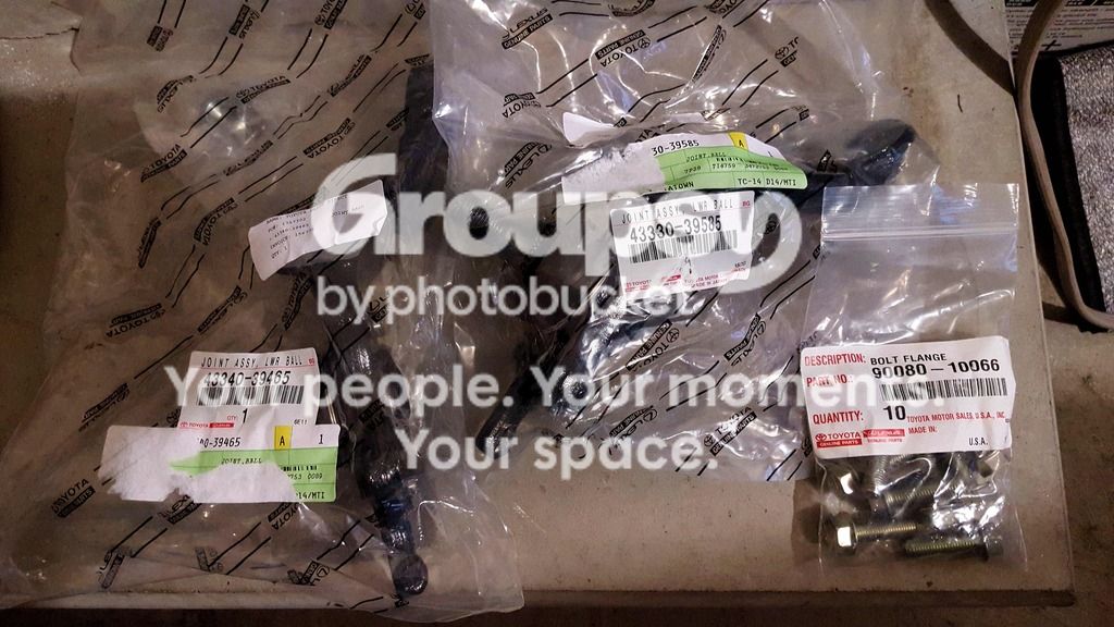

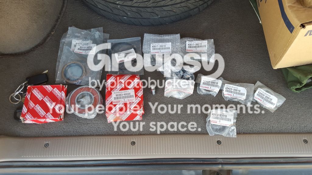

Just wanted to update the progress on my 4runner. After looking up some potential maintenance ideas i went with new axle seals and LBJ with all oem parts from Toyota. Unfortunate that it does cost quite a bit more up here in Canada.
20160803_203346_zps4x4ycr3w.jpg~original
20160803_205412_zpslhsbh6q5.jpg~original
20160808_093942_zpsrps0et02.jpg~original
20160718_104632_zps6tbowgnp.jpg~original

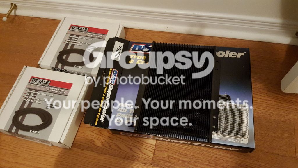

Also ordered B&M 70268 Transmission cooler which will be installed within the next few weeks. This way i knock out any potential failures with it. Should be solid and ready to hit some long distance trips.

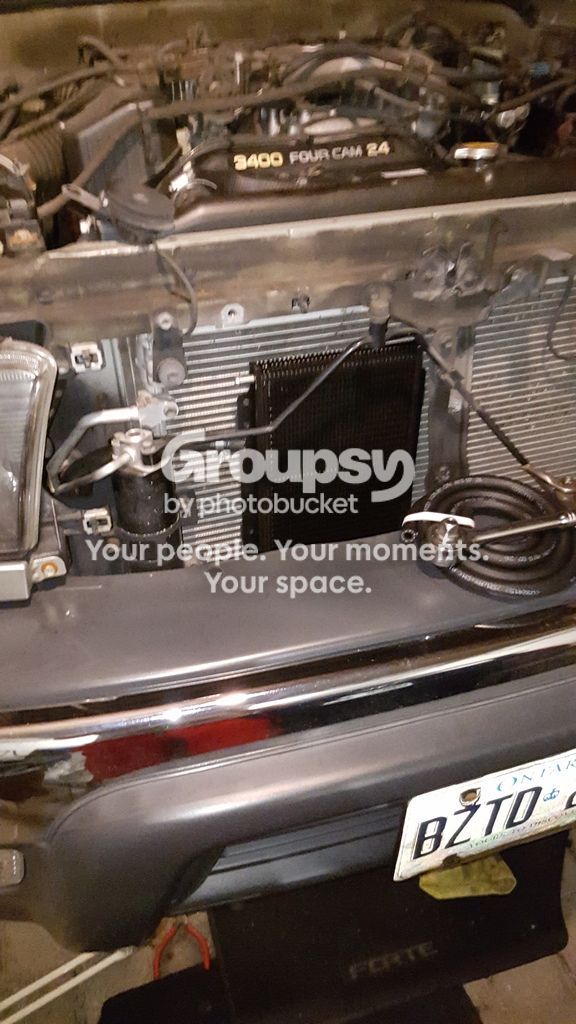

Ended up doing some late night wrenching. My B&M transmission cooler arrived yesterday and I really wanted to throw it on before I go on a cottage trip next week. Reading all these threads about milkshake has gotten be really paranoid even though my truck has 99k. But in the end it was worth it for the extra piece of mind.
I ended up going with the 70268 cooler, the install went pretty smooth. Most time was spent making sure i routed everything properly with some slack and abrasion protection. I bought 10" transmission hose which really came in handy to wrap some areas from sharp edges.

Most of my maintenance has been crossed off the list including
Rear axle seals + bearings
Lower ball joints
Transmission cooler
New brakes front/rear
Oil change
Fresh Transmission fluid

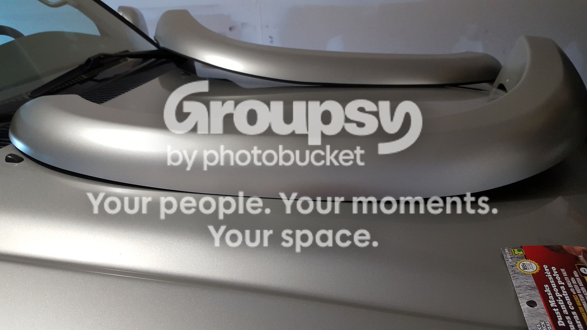

I bit the bullet and purchased a set of Bushwacker fender flares and spidertrax 1.25 wheel spacers. I'm working on installing the flares, currently painted the fronts (need to install). The rears I need to figure out how to even mount them... instructions from bushwacker aren't too clear regarding how to line up the flares on the door.
Duplicolor perfect match
20160912_182159_zpszx2dbjzf.jpg~original
Doing some test fitting here with my dad.
20160918_104616_zpsm3fjpo5e.jpg~original

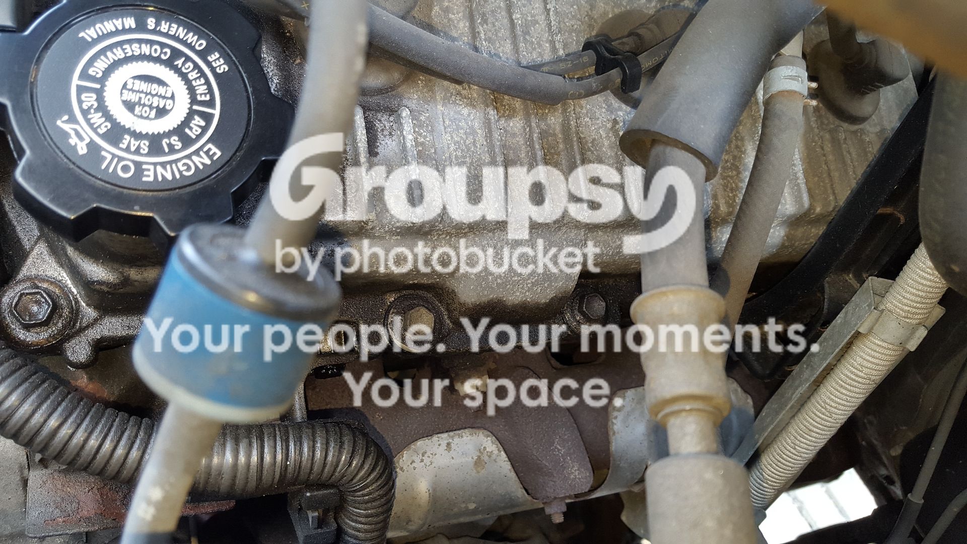

Also discovered today while starting up the car after sitting for 4 weeks that my valve cover gasket is leaking pretty bad. Decided to look up some things on T4R and discovered a lot of people have had issues with loose bolts. Decided to go check it out and long behold... all bolts on either side were so loose I could almost tighten them with my hands. Has anyone else had this issue? I'm hoping that fixed the issue, will have to find out tomorrow.
20160918_110446_zpsyoyfnwd2.jpg~original
I just recently did my valve cover gaskets, because looking at them they were leaking. I assumed the gaskets were bad, but low and behold as I was taking the valve covers off the bolts were loose enough to remove by hand.
I still ended up replacing the gaskets anyway.
Hmm wonder why this is such a common occurrence. I checked today and nothing seems to be leaking now. But I found what I believe is an exhaust leak under the hood right where the exhaust manifold connects.

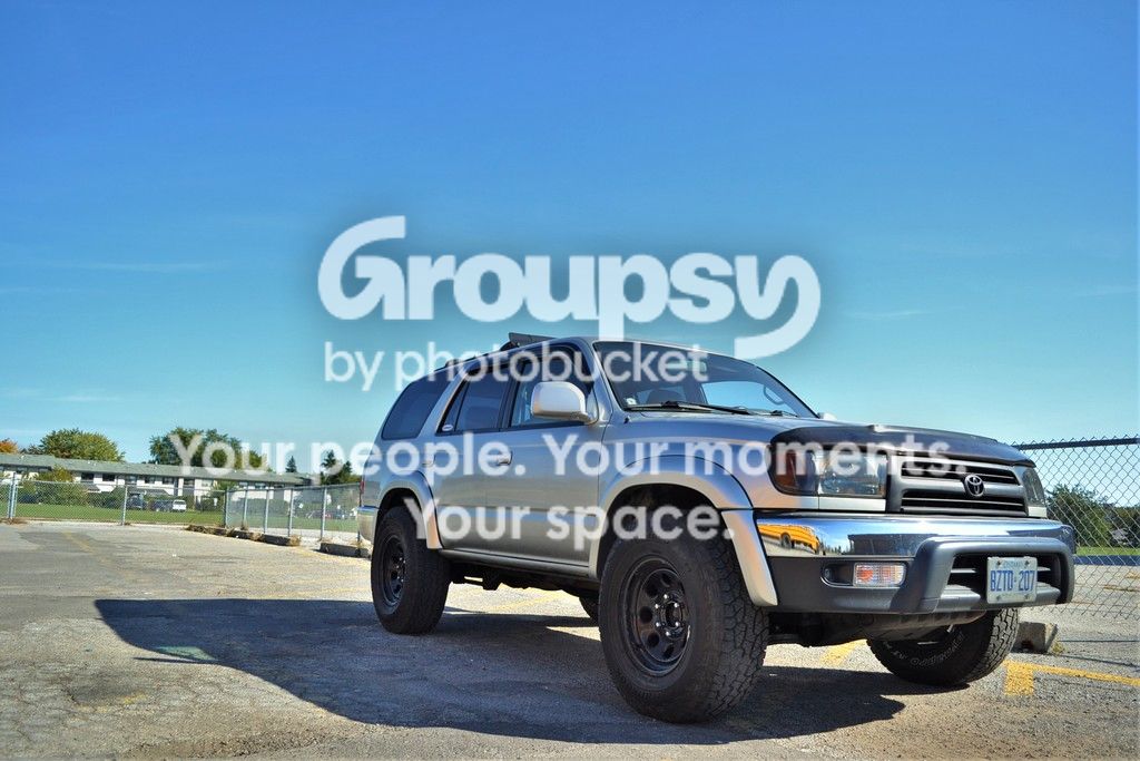

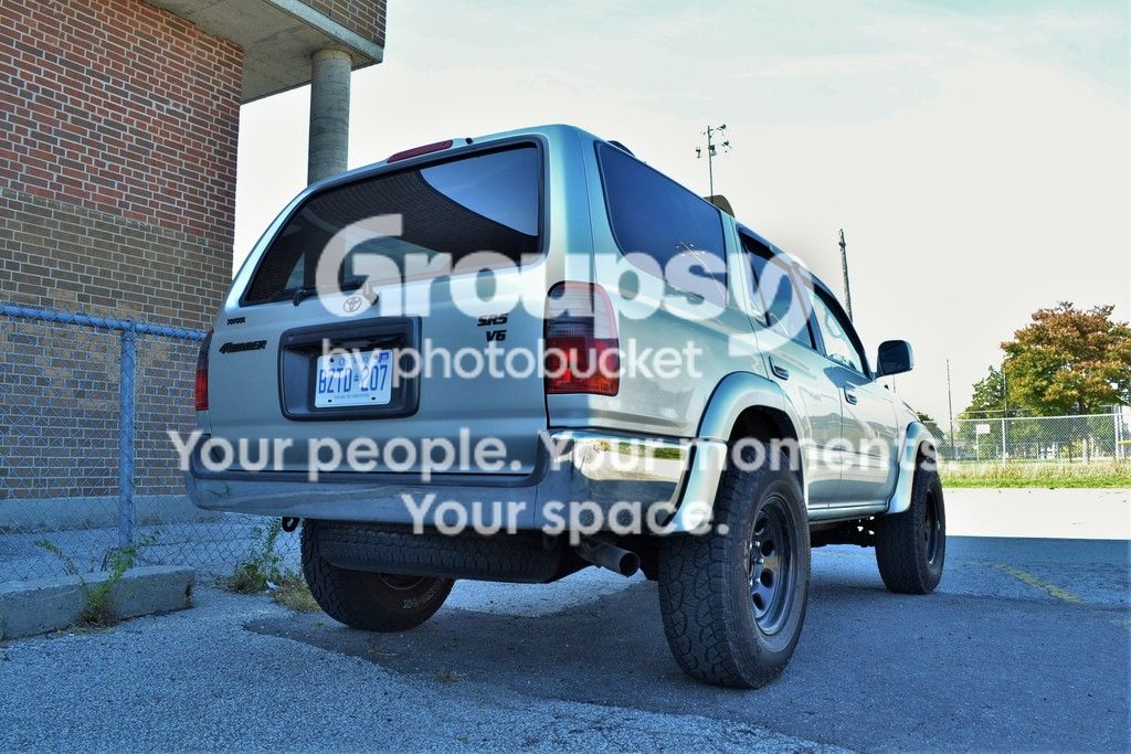

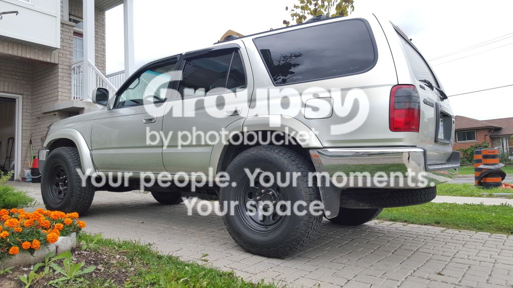

So I'm still working on installing the flares (taking my time painting and making sure everything fits. I got all 4 flares on now and I'm just working on the end caps right now. I think overall this really changes the appearance of the truck!
This is with all 4 flares installed (1.25 Spidertrax wheel spacers up front, no spacers in the rear)

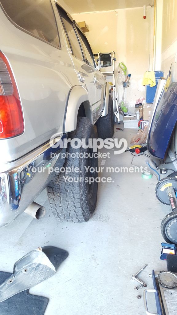

I knew after installing the wheel spacers I would be rubbing the inside wheel well so I pulled out a heat gun and started hammering away a section on each side and trimming the flares.
20161003_155104_zpsq7mxli05.jpg~original
This ones with the rear spacers installed, beefy looking! (Better pictures to come)

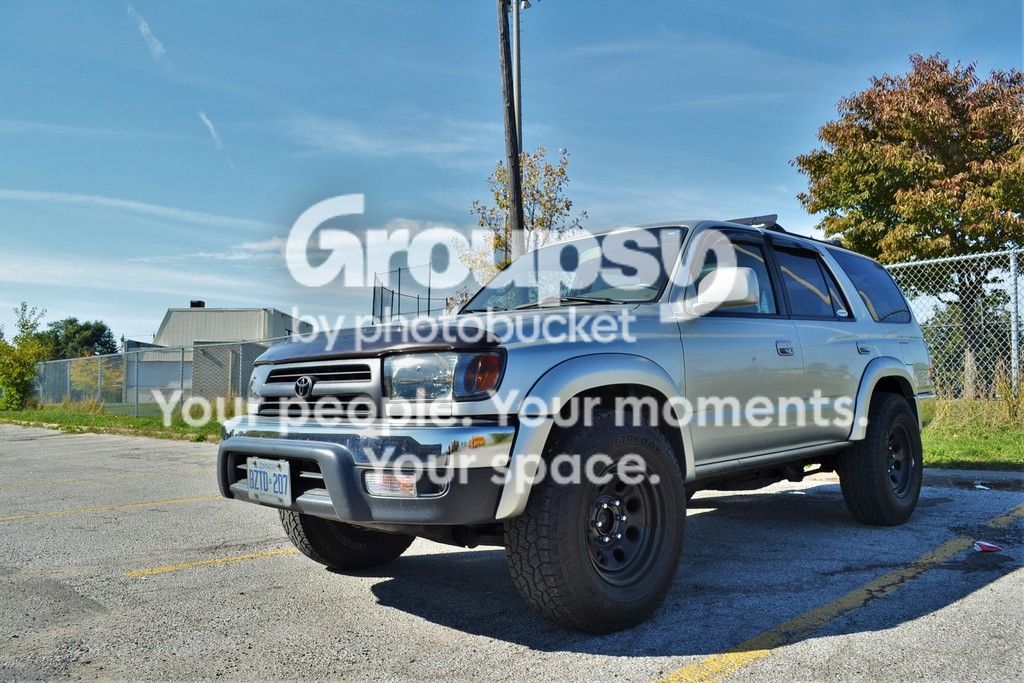

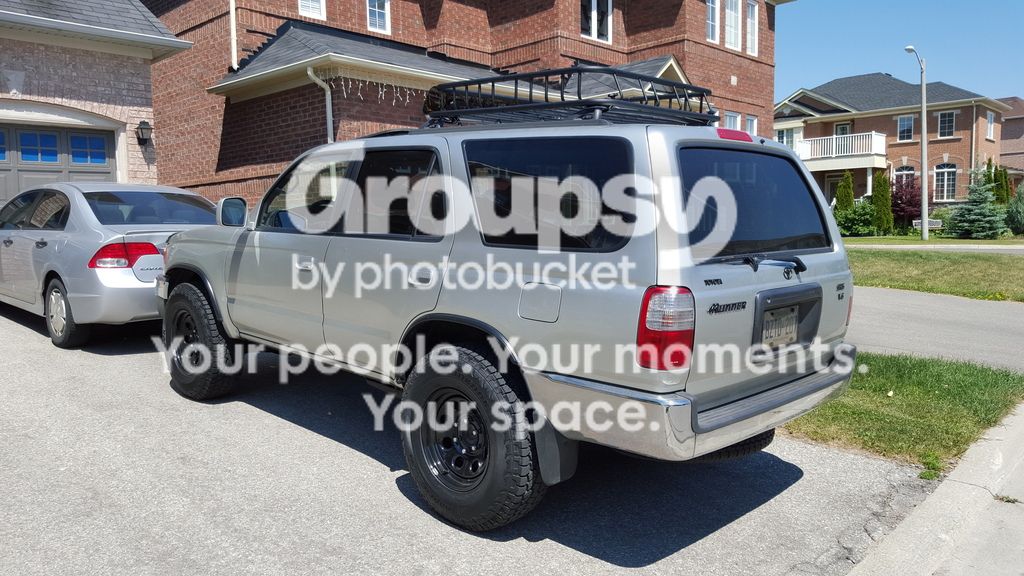

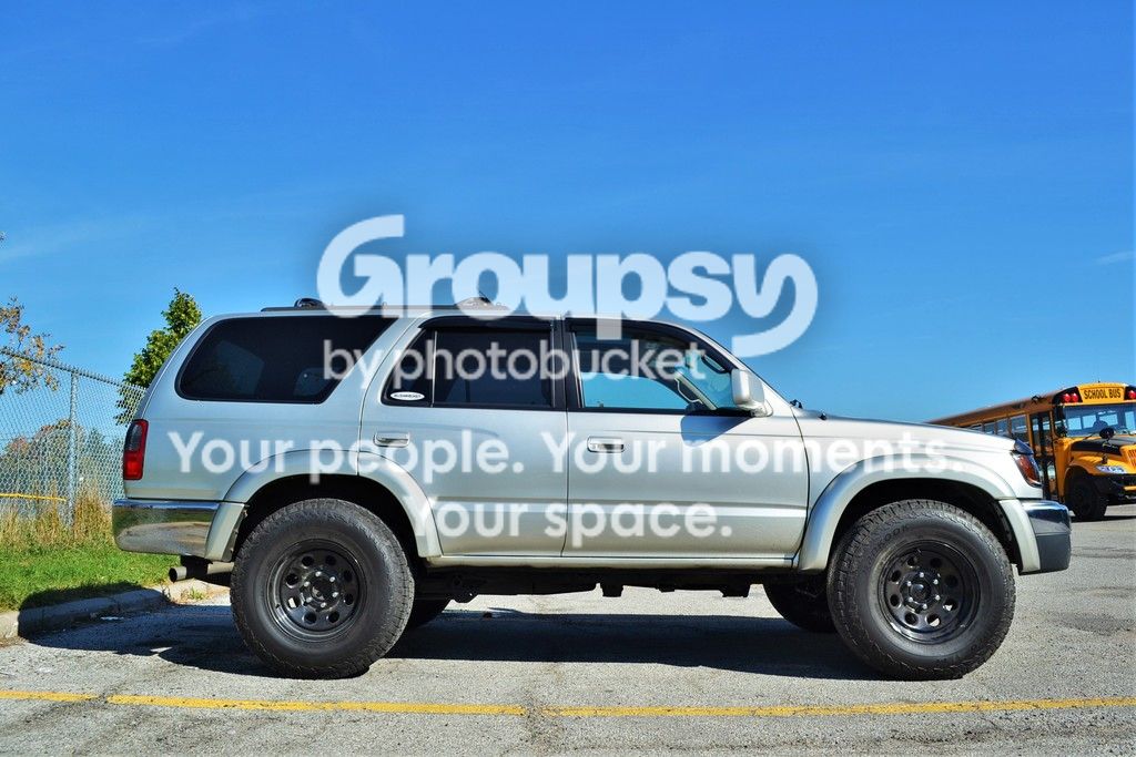

Small update

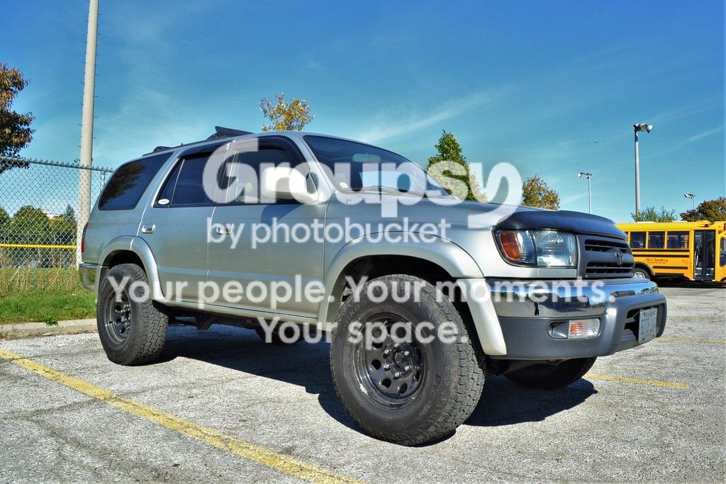

Finished up the fender flares and installed the end caps plus rear spacers. Looks boss!! So much better than before. So happy I went this route

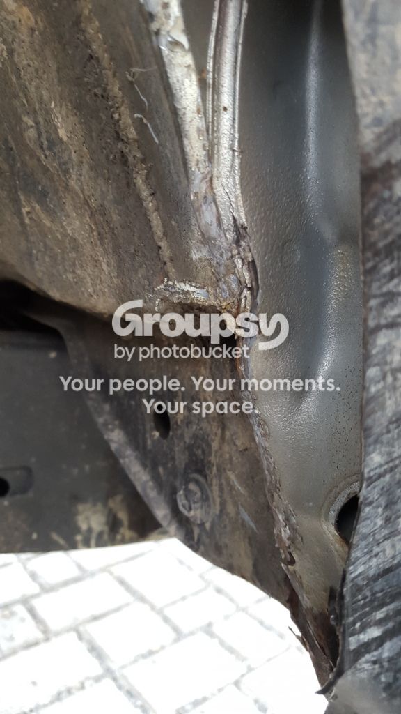

So it's that time of the year again where I store my protege again. Though this year I'm more excited because I have the 4runner which should be a blast in the snow! I went ahead today and got the truck undercoated.
IMG_20161109_130522_zpsh3ght86q.jpg~original
20161112_095315_zpsisifkamr.jpg~original
20161112_095321_zpsz6tlw0if.jpg~original
The shop did a great job with the oil spray
