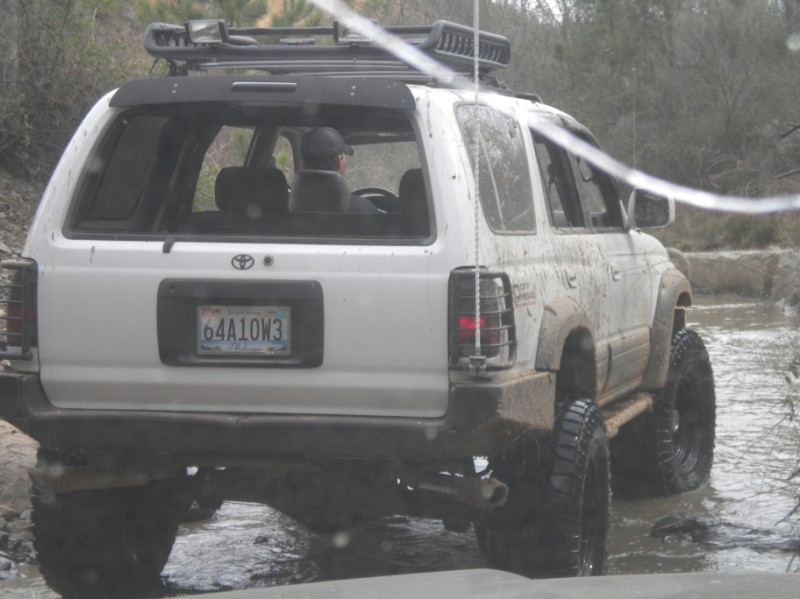

Gray Rock ORV in Mount Olive, Al.

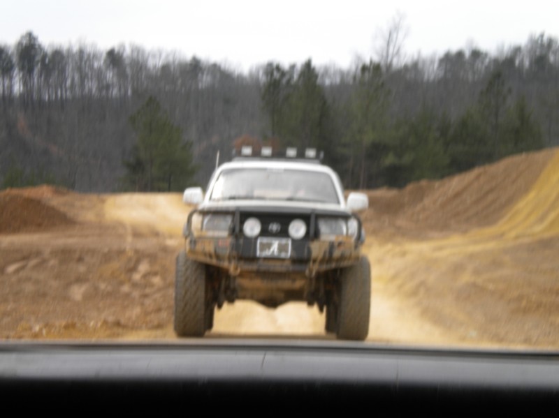

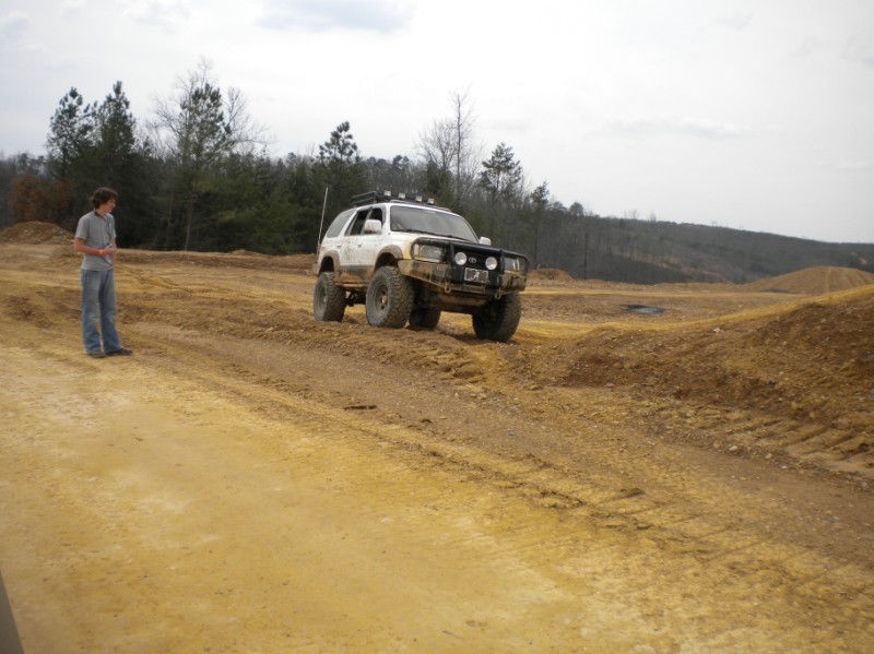

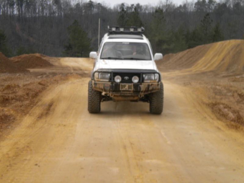

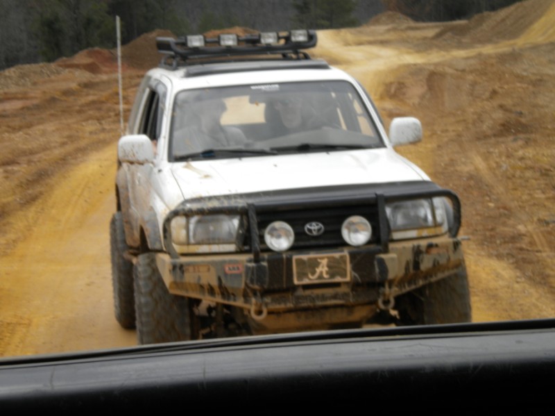

More........
