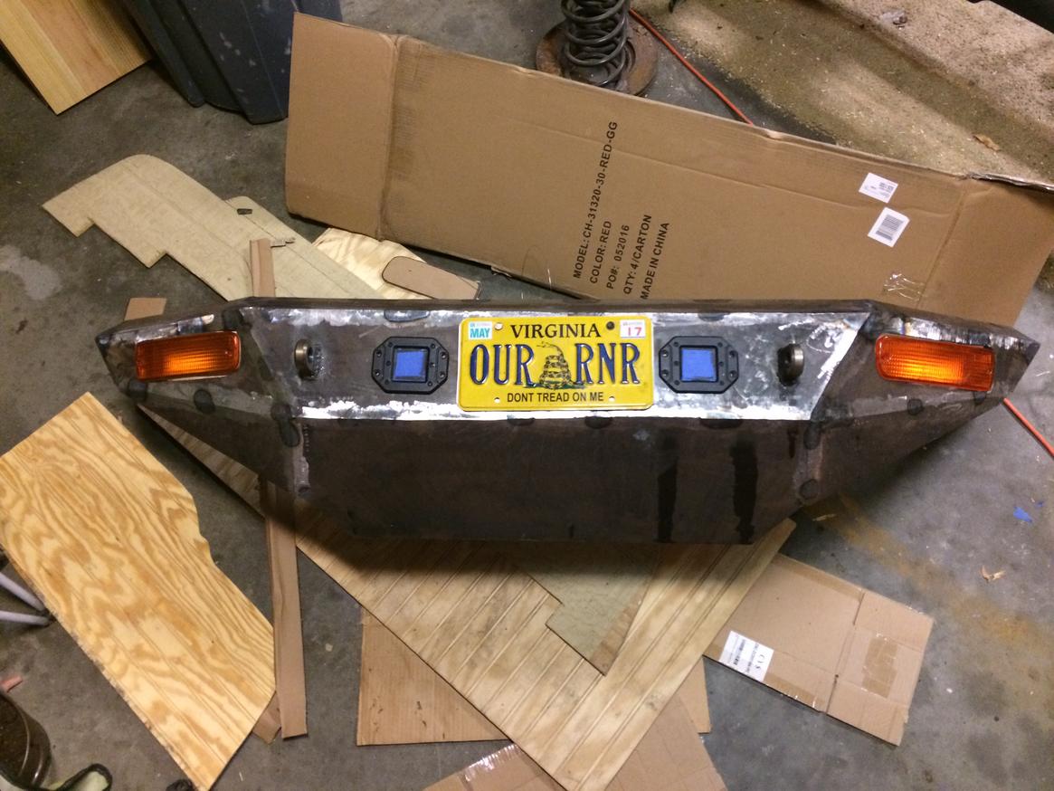

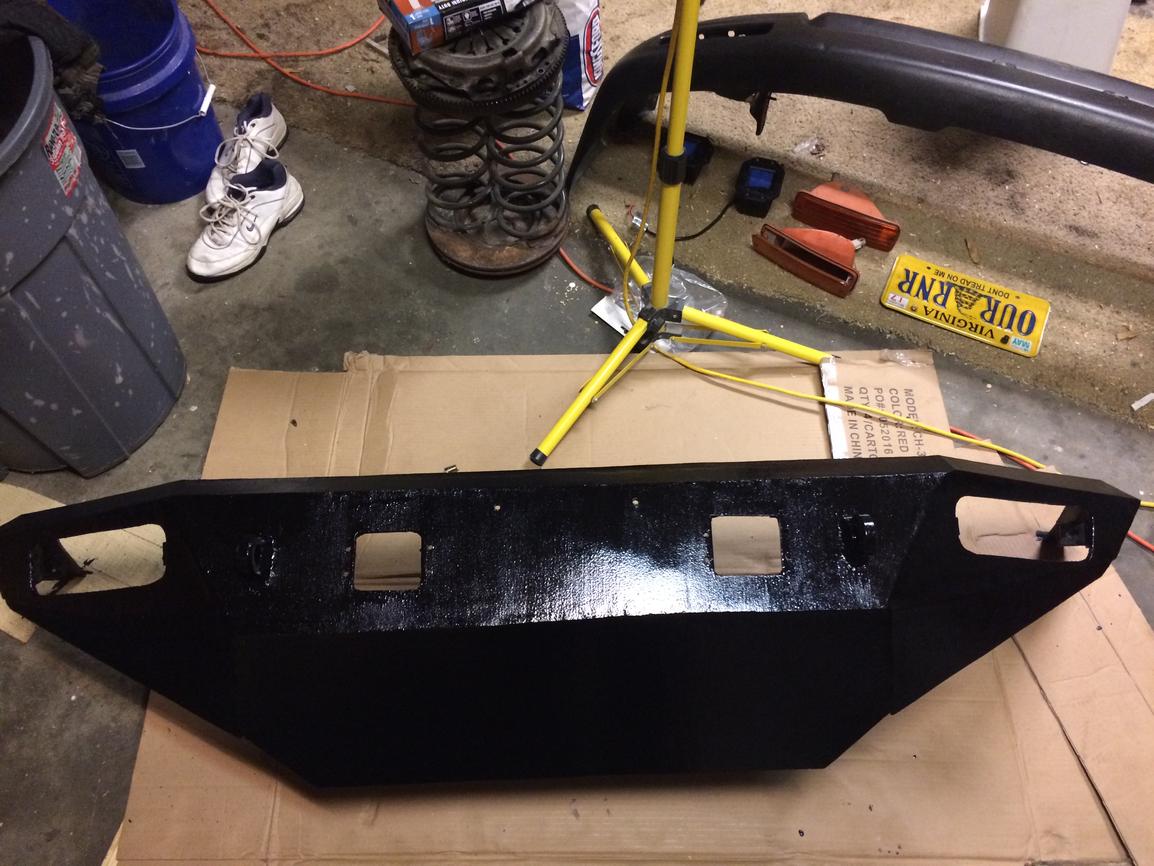

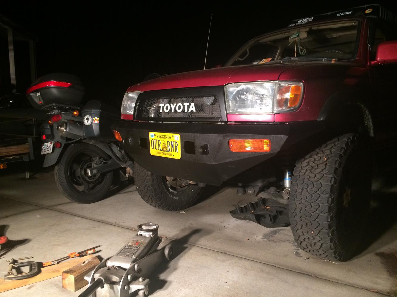

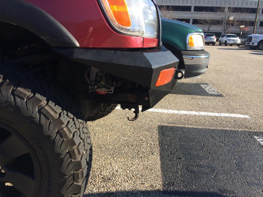

I weighed it. 98 pounds. Stock bumper is somewhere around 20 pounds, so a 70 lb increase. The front end isn't nearly as stiff now though which is nice.

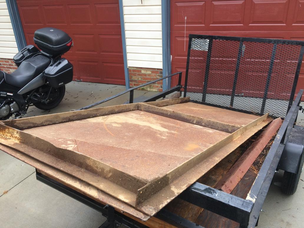

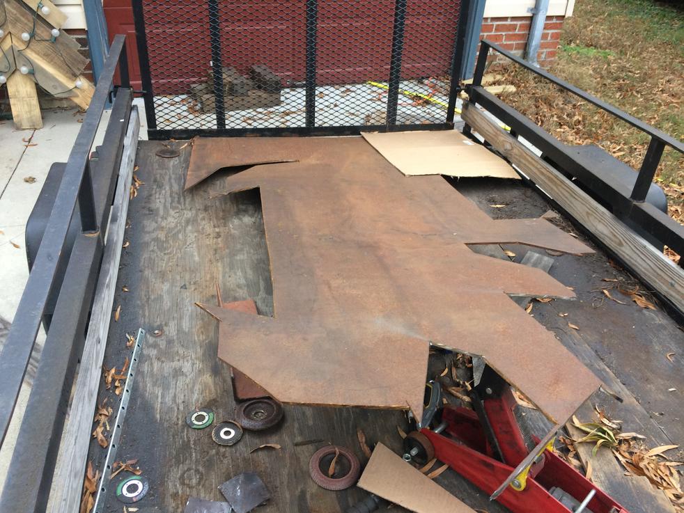

I actually don't think I mentioned it in this one since it was just picking up with the leftovers from the rear bumper. It's a little thicker than I had originally desired but I found the sheet at the scrap yard and got it for a great deal on it. I should be able to return my leftovers and get a decent amount back. All that being said, it was 1/4" steel.
Cool - supposing someone wanted to make something like it, about how much of that sheet metal should they aim to get? (as in a 2' x 6' section for example). thanks.
I started with the first one. I think it was 6x9 when I bought it, maybe 4x9. And the second one is what I'm left with after doing both the front and rear bumper.
Edit: it had to of been 4x9 or it wouldn't have fit in the trailer width wise.
Seeing all those cutoff wheel scraps makes me happy I invested in a oxy/fuel cutting setup, and will be investing in a plasma soon.
They are definitely worth it. I don't miss the days of burning through cutoff wheels.. :)

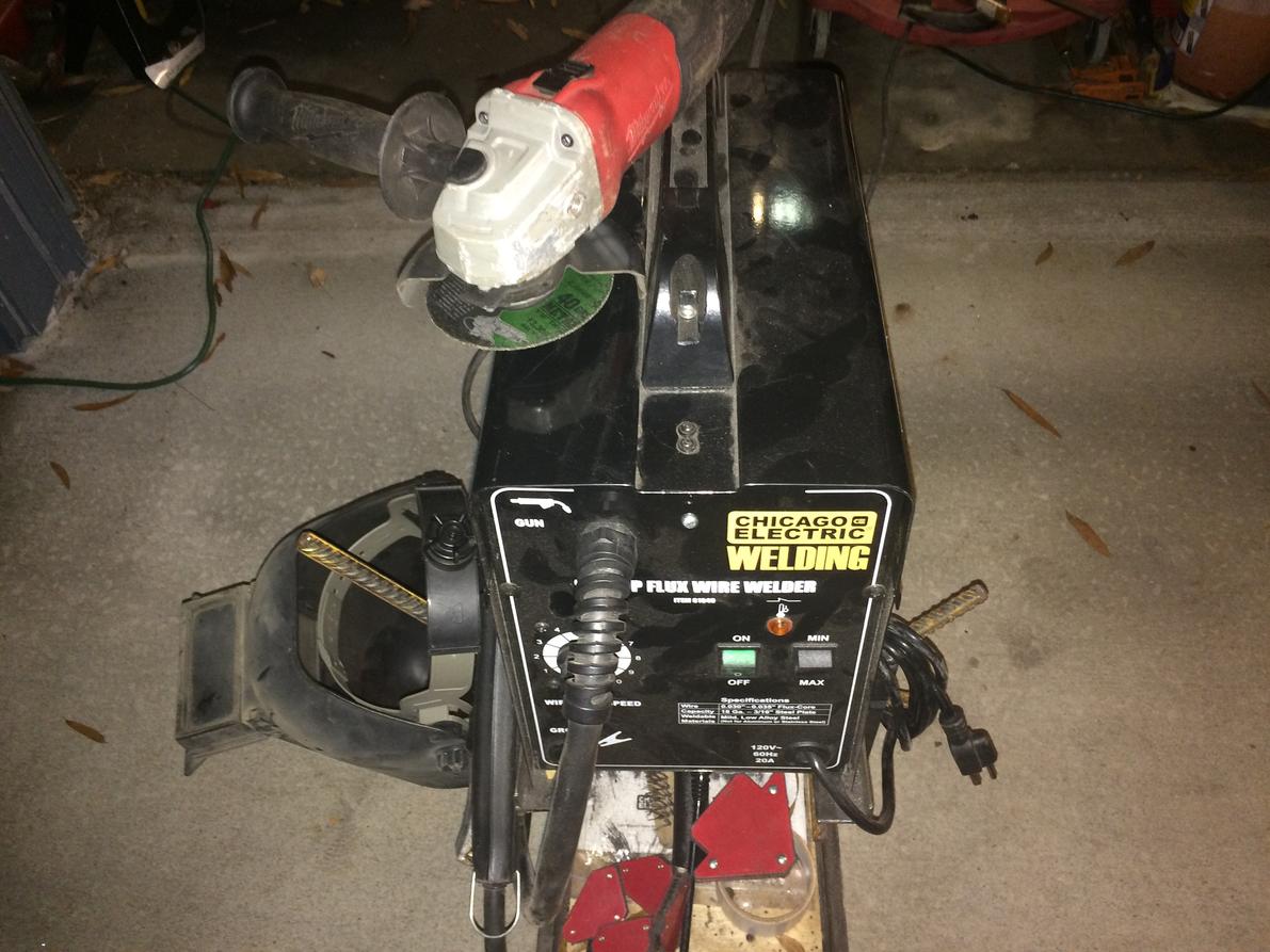

Other than a drill for a few holes, this was all I used

I think I went through something like 30 of them. I had a few loose ones from the rear bumper, and then bought three 10 packs and have a few left. I used them down as far as possible too.

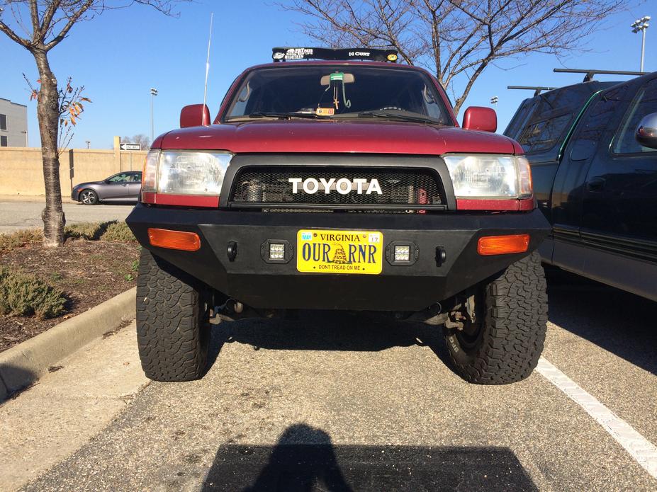

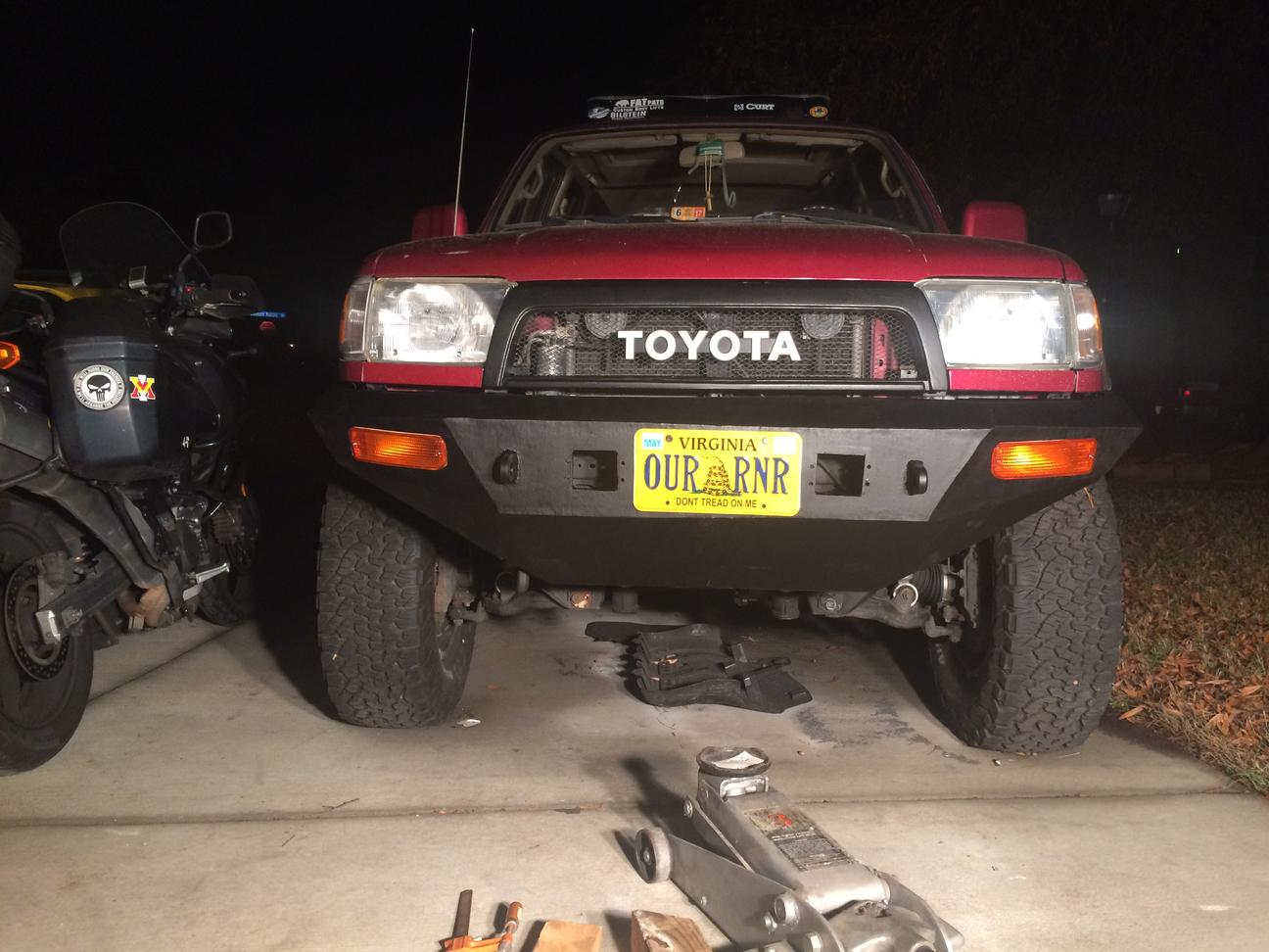

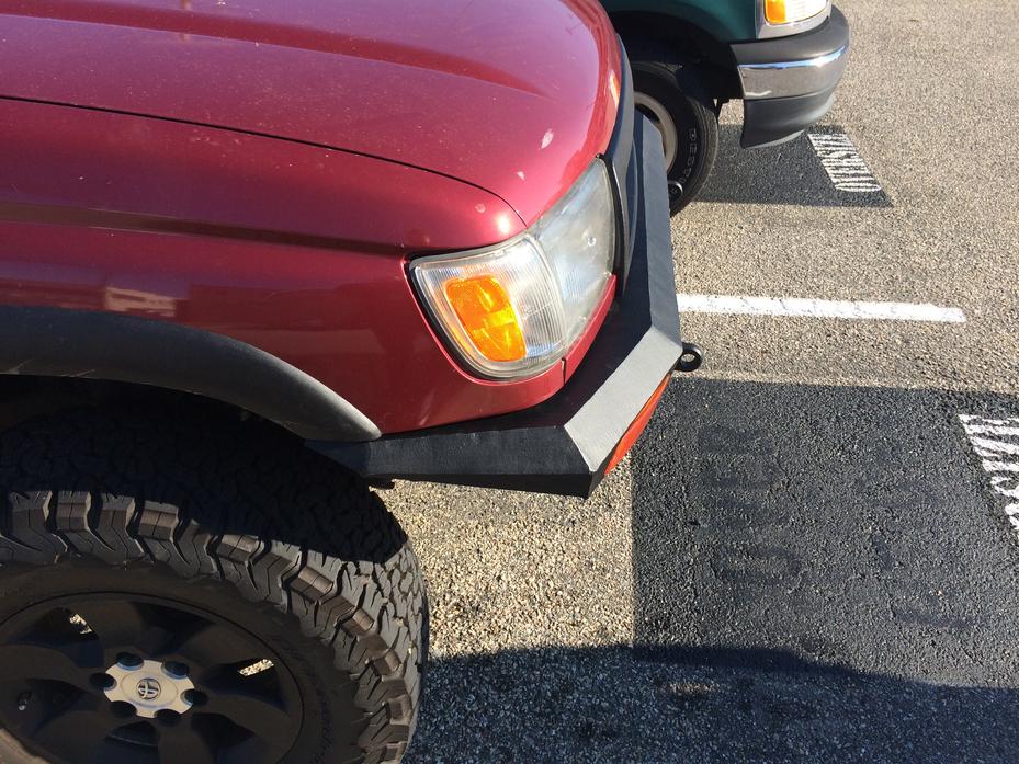

Lights installed and all done.
