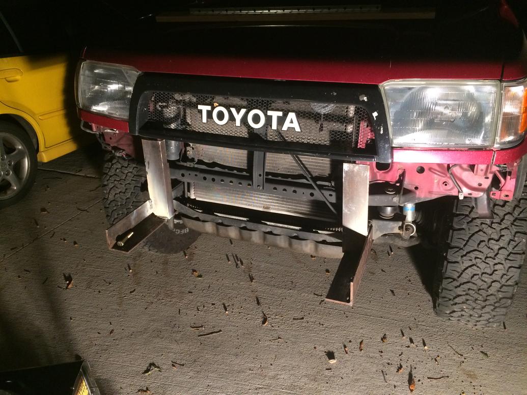

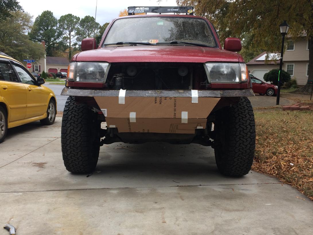

So the time as come to start the front bumper build. I took off work this whole week to try and get it knocked out as quick as possible. I'm using the leftovers from my rear bumper build. Hoping to get the mounts done and it at least mocked up today if not starting to cut material. I'm trying not to get too ahead of myself though just because I know doing the mounts may take me a while

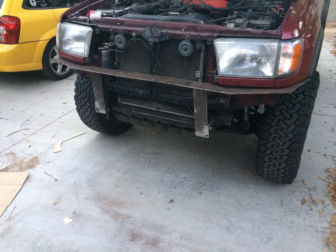

Not super exciting, but I got my mount constructed. Should be enough daylight left to start figuring out the rest of the bumper.
Obviously got some trimming to do in the morning. Don't have as good of a plan for the mounts in the front as I did on the rear.

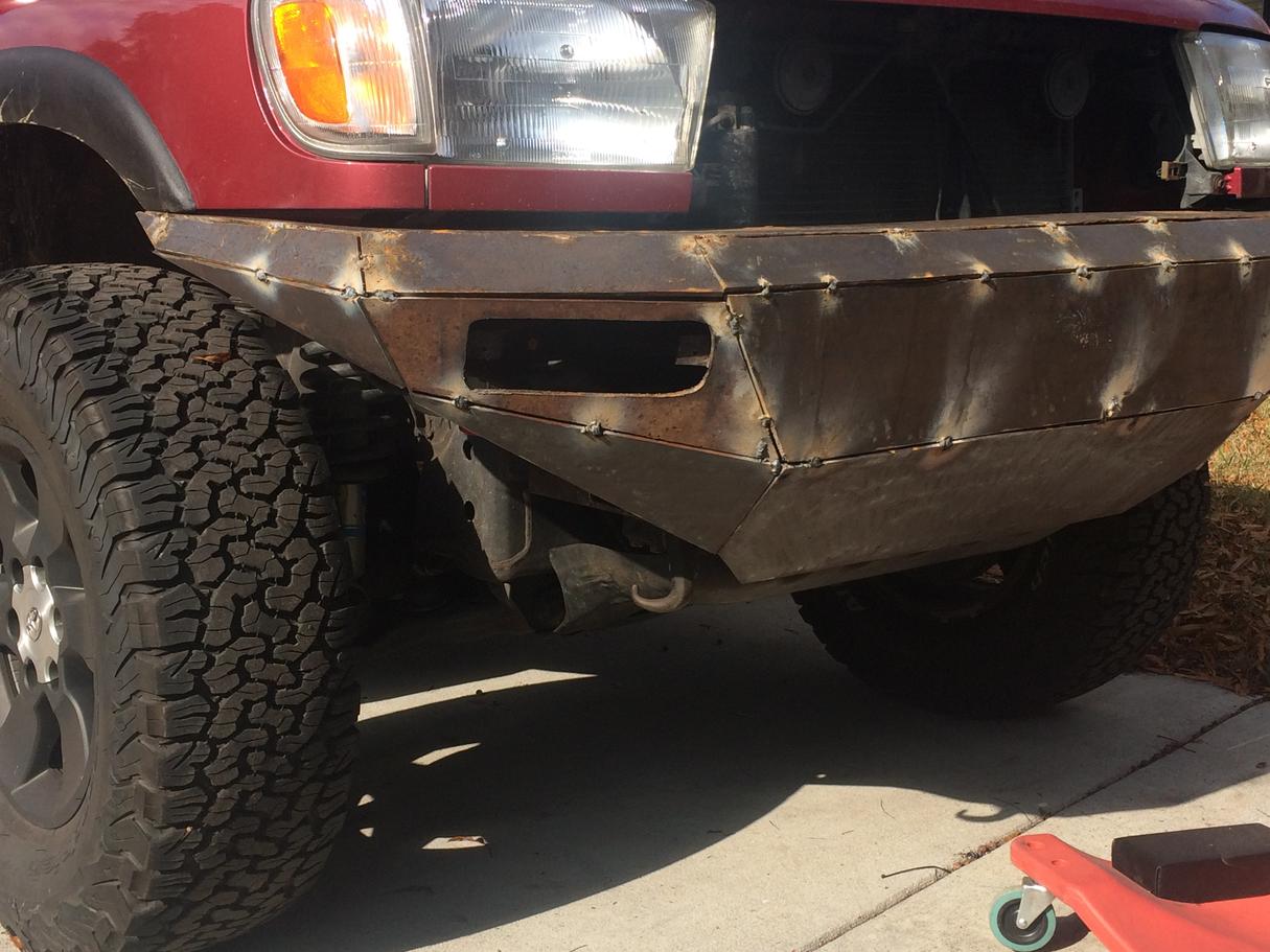

Doesn't look like much progress, but this piece actually took a while to template and then cut and get right. I wanted to get this done first so that I would have something more solid to attach the rest of my cardboard template to. Hopefully the rest should start to fall in place. I'm helping a friend move tomorrow, so we'll see how far I get....

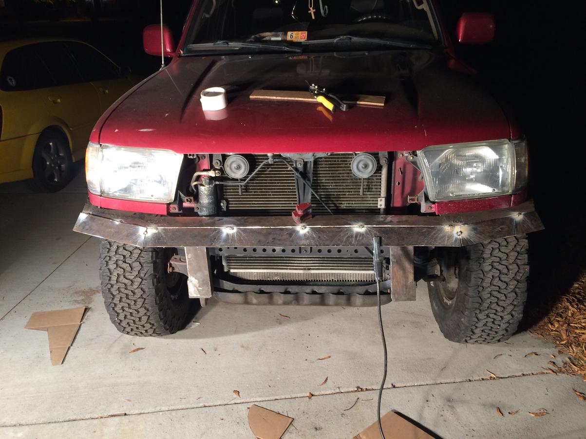

Finally making some progress. Had to get the drop lights out to do so.

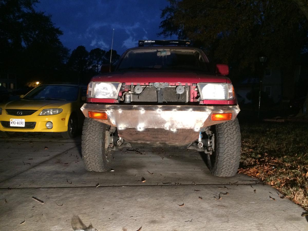

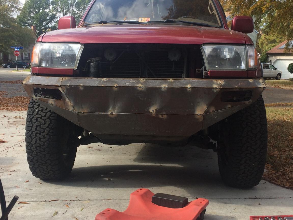

Planning to mount my license plate, d-ring mounts and some aux lights on the front panel. I'm planning to reuse the stock turn signal lights (hopefully).

Finally some progress worth being proud of.
Edit: Grooming the stock turn signal lights was a pain in the butt, but I think it will pay off, I think it looks pretty good right now.

I like the look of the stock turn signals integrated into your bumper. Would be cool to see that option on more armored bumpers.
I thought about going with aftermarket, but honestly I was worried about VA state inspection and also didn't wanna have to worry about any electrical grimlins. If I keep them stock I should be able to keep my electrical issues to a minimum and to non critical systems.
All tacked together. Time to drop it down and weld it up! Still need to add my d-rings, aux lights and license plate holes too.
