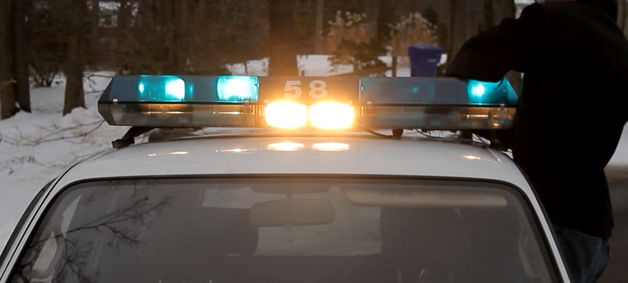

I should upgrade my alternator. Gonna make a thread about mine. Needless to say, an all halogen rotator lightbar is a little much strain on it haha
