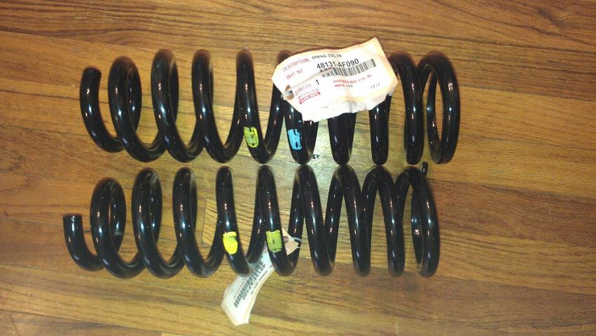

so the father in-law came down today and brought me a late christmas gift...
-Drivers side - 48131-AF100 Yellow/Yellow
-Passenger side - 48131-AF090 Yellow/Blue
brand new and all shinny, now i just need the tundra 5100s and a diff drop
