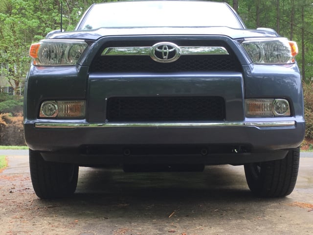

Can anyone post a photo of a Limited with the RCI skid powdercoated in black?
Not a worm's-eye view, but normal viewing angle front view.
I would like to know how this would look on my 2012 Limited before I order. Did a Google image search but all that I could find were TE's...

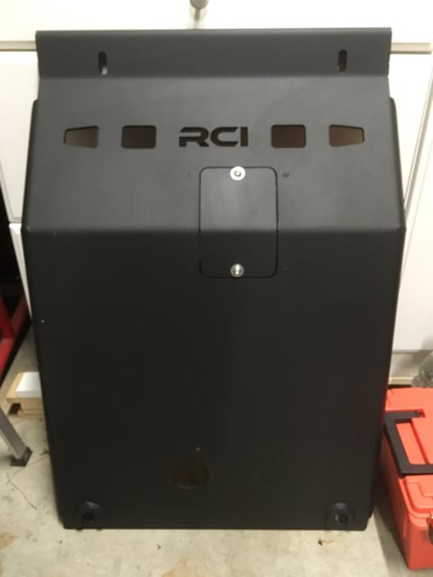

Soooo.... Turns out I didn't read the fine print and the RCI front filler plate does not fit the Limited bumper. Josh caught it and adjusted the order (great guy) but now I'm back to needing a stock front filler off a Limited. Anyone?

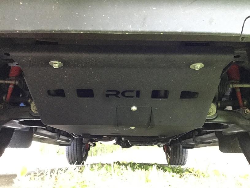

Arrived today...

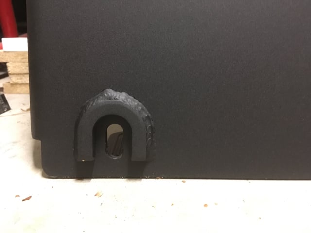

I like the enhanced bolt protection....

Did you install your parts? If so, how are they?
See my pic just above your post. Installed and fits perfectly.
I performed an oil and filter change with it on, and you can do it, but next time I think I'll just drop the skid plate. I just use a floor jack at the balance point of the skid plate, remove the bolts, and lower it. Much easier than the factory skid plates on my 3rd gen!
Oh, I did not get a filler plate as it won't fit the LE. Still not sure what to do about that.
EDIT: Found another pic...
