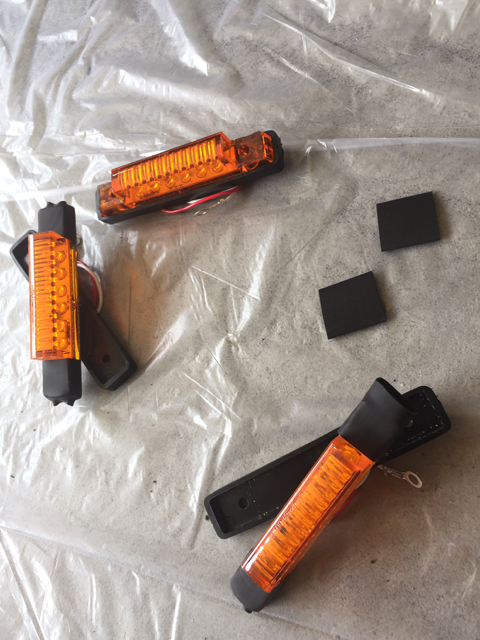

I also purchased the amber led marker lights and followed rockcreekoverlands detailed directions regarding add a circuit instead of tapping into the parking lights (still not quite sure what those lights are referring to).
I found they cut a lot cleaner with a small fine toothed hand saw and if you notch it with a knife where you want the cut to happen it could reduce the chances of ****ing up.
Then heat shrink the ends and zap strap it in place on the upper grille piece.
I like to have my cables as clean and tidy as possible so I techflexed and shrink wrapped it so you don't see white and red through the grille.
I soldered the three cables together each and then shrieked wrapped it too
Compared to the stock part
Ripped off the vinyl on the cross piece so I get better adhesion. I then added black vinyl near the edges so when it's on you can't see the gap.
Tested the lights with a 9v to make sure everything works before grounding and connecting to fuse box. Then voila.

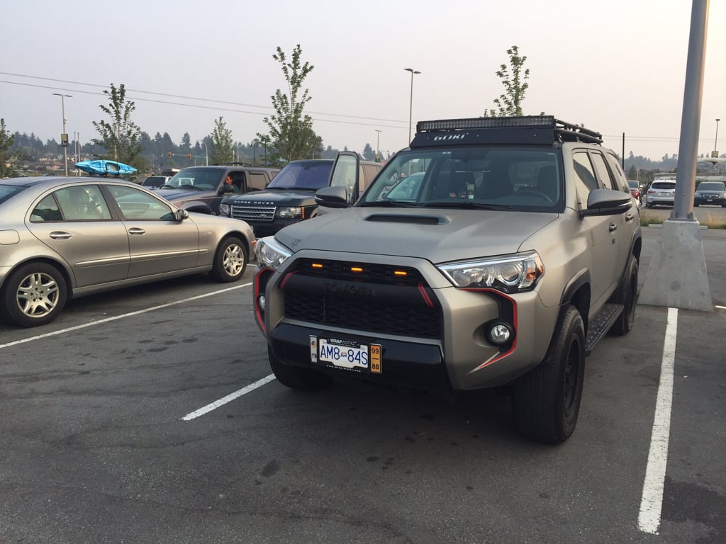

I slightly misaligned the cap but am too lazy to pull it off and remount it. Plus I am worried with the uber strong tape I might damage it. But overall it looks a lot nicer than stock.
Looks great! It totally changes the look of your front end. I think the pinstriping is a great idea and might have to copy that one.
