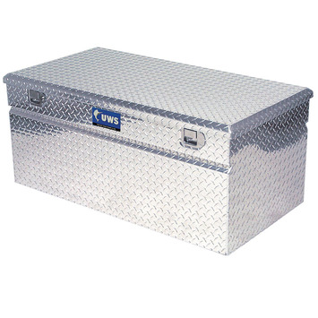

I've attached a link for a box that would fit on the hitch (and yes, that would be because I not yet sure if I've figured out how to post pictures yet). If I got this box, I might would add a rail to the top of it so I could strap a cooler or other stuff on the top.
