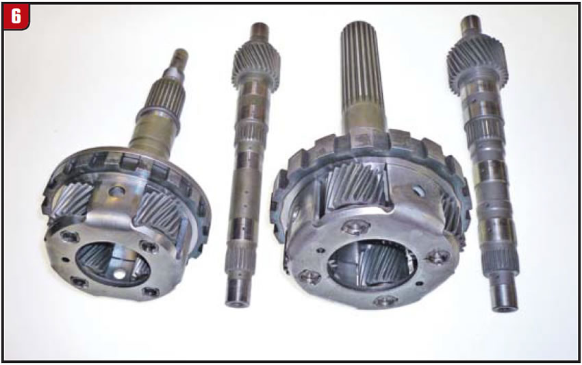

The AB60 in the tundra vs A750 planetary gear set below is a good visual of the comparison. Both are nearly identical in design. The AB60 is just scaled up a size category. Both are very reliable. Probably the most reliable production automatic light duty truck transmissions ever built. I can't think of any that would be better.
