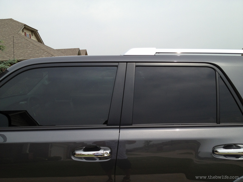

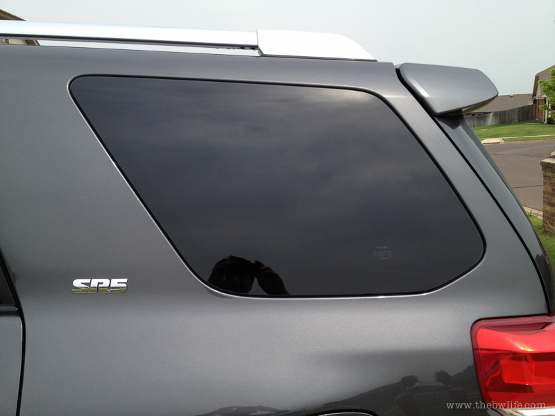

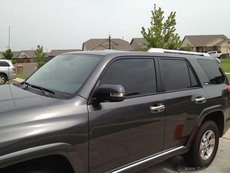

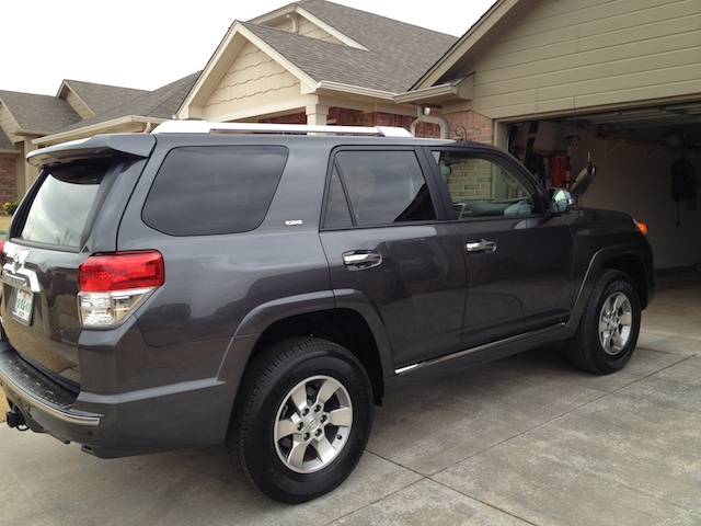

Window Tint
I got Llumar non-metallic charcoal tint. Its 15% in the front and 30% in the rear over the factory baked privacy glass. It almost matches with the rear being a slight bit darker than the front.

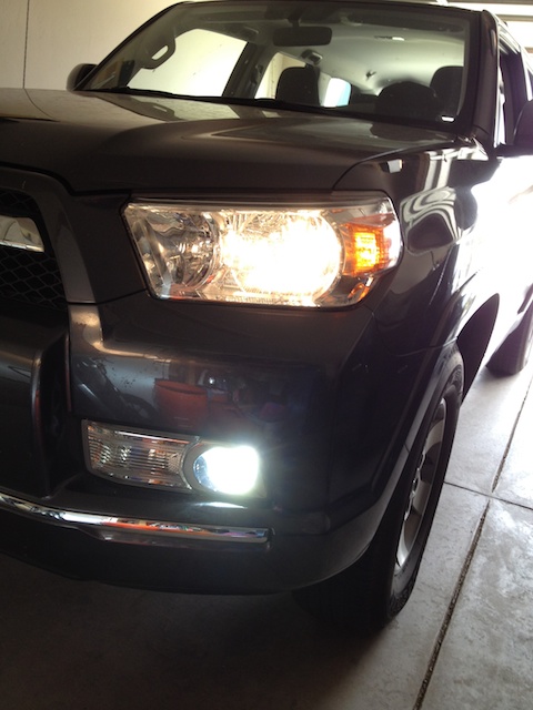

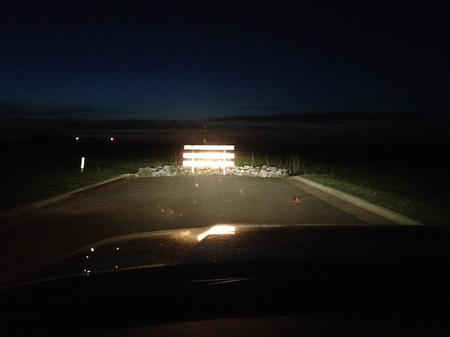

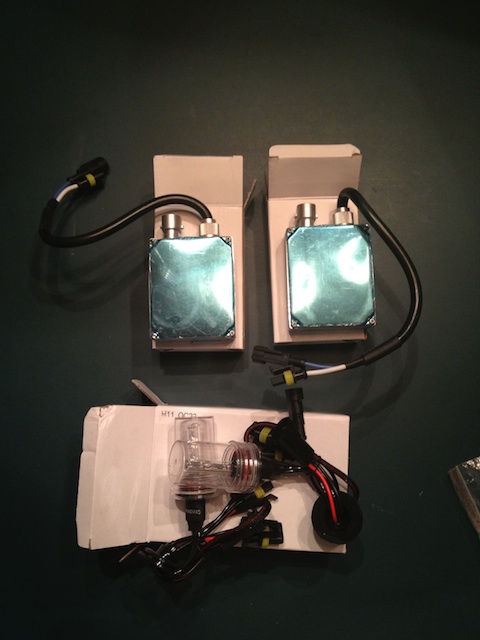

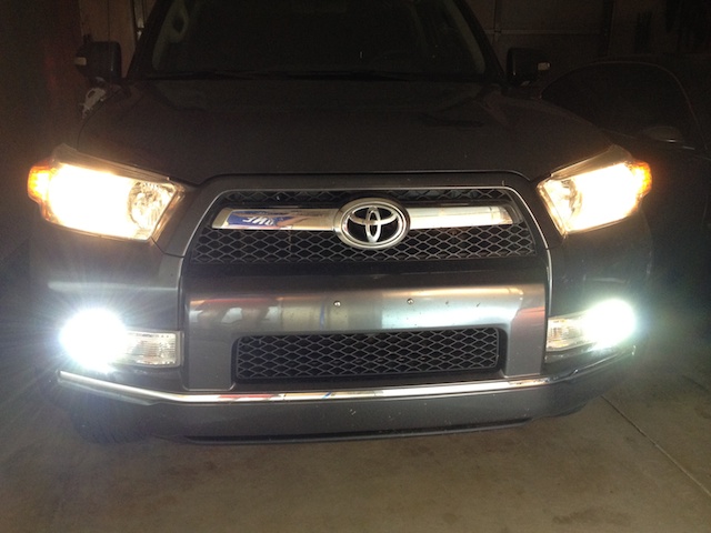

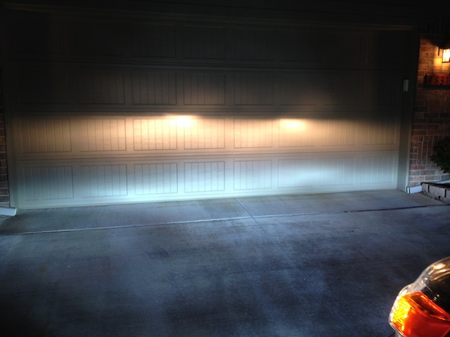

HID's In Foglights
I decided I'd give these a try - no its not projectors, but its only going in my fog lights so I'll be able to turn them off anytime. I know some of you "purist" hate this idea and thats fine. I do have really nice real HID's in my BMW so I know what it could be. Its not perfect but its kind of an experiment for me.
I bought the DDM Tuning 4500K 35w H11 kit with the Raptor ballasts. It was $34 + $4 mounting brackets + $15.83 S&H = Total of $49.83
They were bought on April 25th and delivered on May 5th, not bad considering they were direct shipped from China.
Installation was pretty straight forward and was all plug and play.
Light cut off is way better than expected, I'd think I'm not blinding anyone.

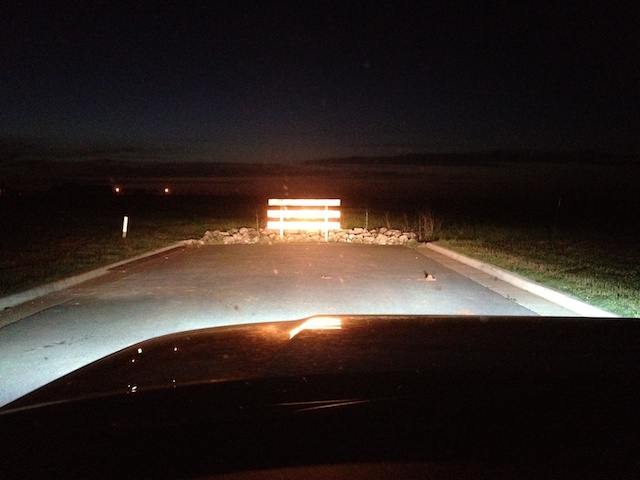

I'd bet you are blinding people. I ran HIDs in my Tacoma for a short time without projectors and figured, "F*ck it. Better I can see than nothing." until I was behind someone without projectors *one time*. I removed them the next day.
That's great, but I've driven by - and walked my my 4runner with the HIDs, they are not blinding. Being as they are pretty low the cut off isn't bad. I have really nice dynamic (some call telescoping) HID projectors on my BMW (move with the steering wheel and pitch of the vehicle). Are they that good? NO, but they also didnt cost $2500 either. I think people justify the projector kit by saying they "blind" people, but in the fog lights its just not so. I've never been flashed...not even one time.
Thank for you input, the beauty of fogs is I can turn them off whenever I please and still use my DOT approved headlights.

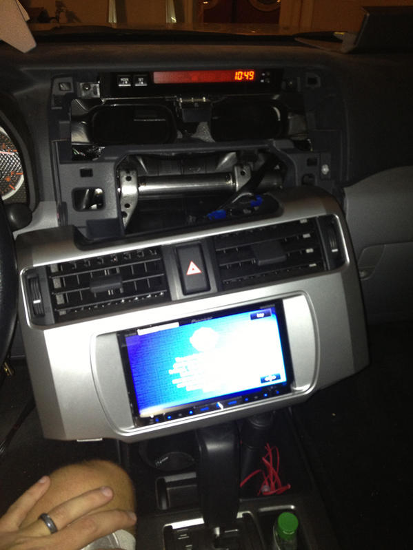

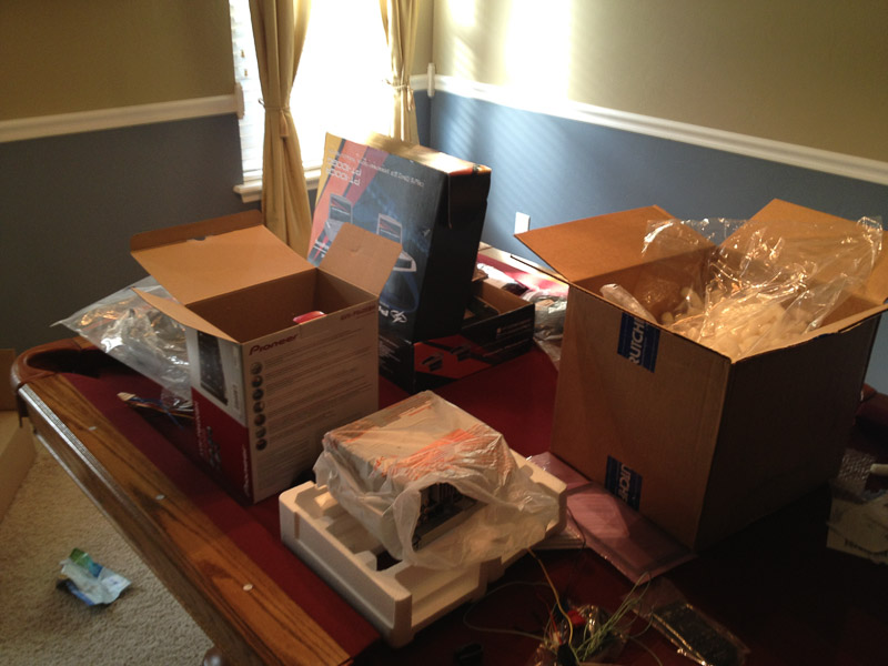

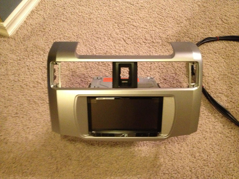

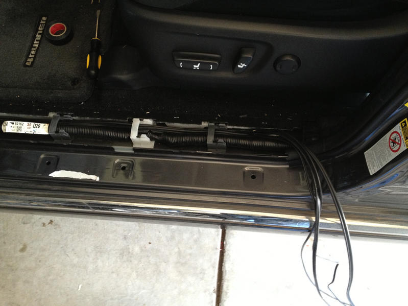

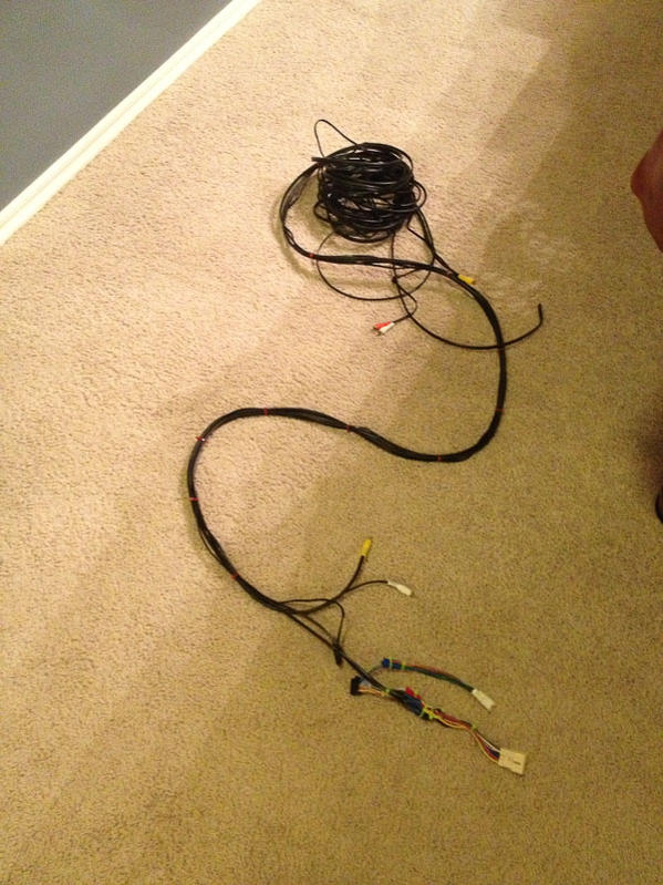

Pioneer AVH-P8400BH
Installed this Pioneer AVH-P8400BH DVD headunit, took me longer to get the wiring adaptor put together than installing the unit. Mostly got this model because it has dual zone control and can be upgraded to navigation if I decide I want it. Probably won't use it, thats why I didn't buy one of the AVIC headunits. Buying from Crutchfield I got the Scotshe Install package free. I will tell you the hardest thing to do on the entire headunit was take the airvents off and install on the new shroud. If you have any questions ask.
Got it all from crutchfield.com and sonicelectronix.com - I had to make my own wiring harness from the normal adaptor + all the A/V cables for the second zone. Most of the cables were from Amazon.com

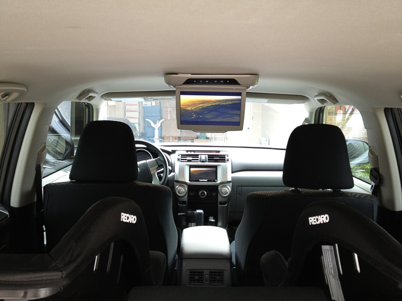

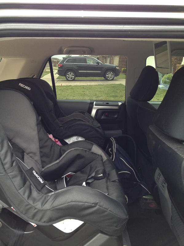

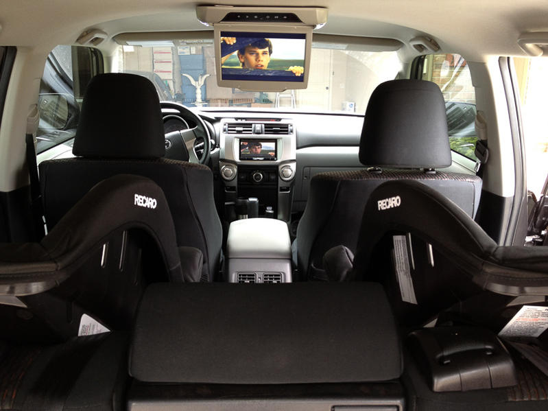

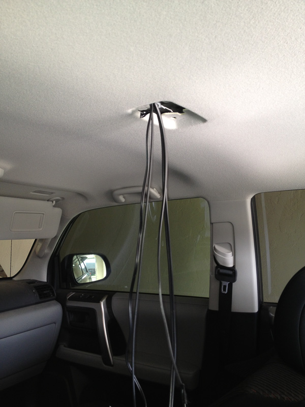

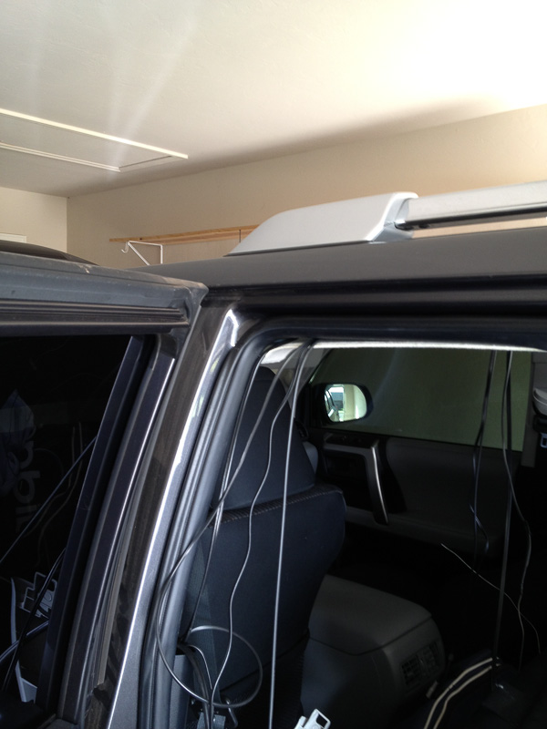

10" 16:9 Overhead Screen
I bought and installed this too, it was a pain. Didn't have to cut the headliner, but drilling into the roof was pretty sketchy because of my fear of screwing it up.
My twins better be smiling everywhere we go! It can mirror the display on the head unit or it can run a DVD off the headunit on the second zone w/ the audio going to IR headphones, but it doesn't have its own dvd player. Its mostly just an overhead monitor.
Notice this is also how two car seats look in the 4Runner. #twinning

Cool! How do you like the AVH-P8400BH
We like it because its dual zone, but looking back I would spend a little more and get the Avic series with navigation and sat radio (all an add on with mine now). But pioneer does a really good job of audio processing so all the music even on the factory speakers sounds pretty good and doesn't clip out. At some point i'll get some medium quality polk DB series and it should sound amazing.
But I have about 20 movies on an SD card and they play on the rear screen. My kids should be getting closer to the age where we can have headphones for them and we can stop only having one zone playing.
But if there is anything specific you want to see let me know and I can video it and show it to you via YouTube.
