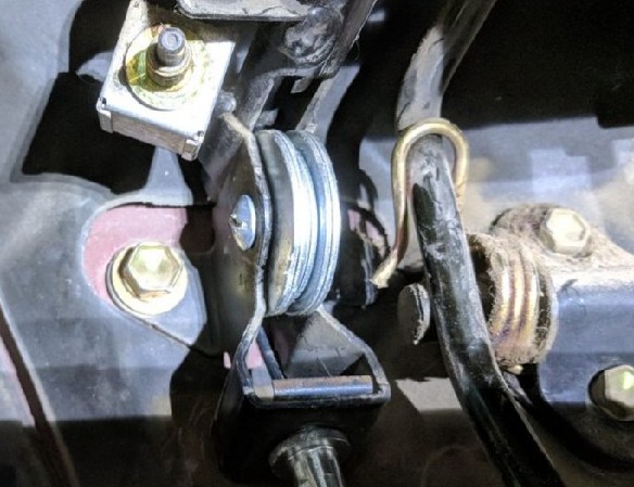

Next it was on to the parking brake. The previous owner pulled the whole bar out after the cable broke. He also must have tried fixing it cause a very important part of the system was missing.
Take a guess what these are about to become?
Figure it out yet? I was missing the wire pulley that holds the cable taught. It also acts as a roller when engaging the brake. The OEM part looks like this and would have set me back 13 bucks if my local dealer was open today. If being the key word.
Here's my McGyvered version installed. Total cost? 10 minutes of my time. I already had the washers and JB weld in the garage. Best of all it works perfectly.
