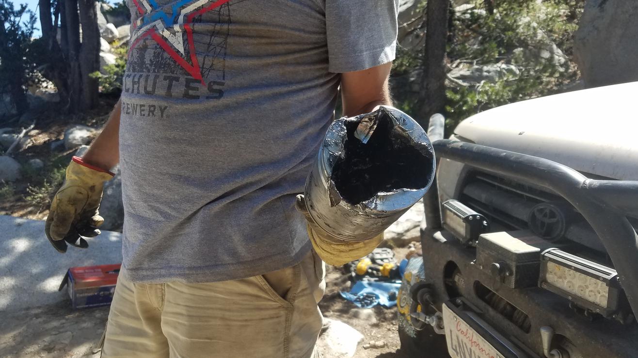

Here's a photo Andy just posted on TW. Possibly the worse place to break on the whole trail. This is where my passenger side outer tie rod decided to blow. It's called Divorce Rock. I can assure you it's steeper then the photo makes it look. Notice the winch line and strap from my sliders to a tree? Yeah, that was to keep the rig from sliding into an even worse spot. lol
Here's that pesky tie rod:
Here's the scene of the breakage.

Yeah. I'm pretty sure it is a record. If anyone has broken more I've never heard of it.

That's insane about that tie rod. You are the first one I've seen break one, let alone break it and bend it in half. I've seen it happen on a few new trucks but their tie rods are wayyy smaller.

Yeah, that tie rod was impressive. More impressive was where it broke. [MENTION=118730]AssBurns[/MENTION] got on the radio and said "STOP MOVING." lol
