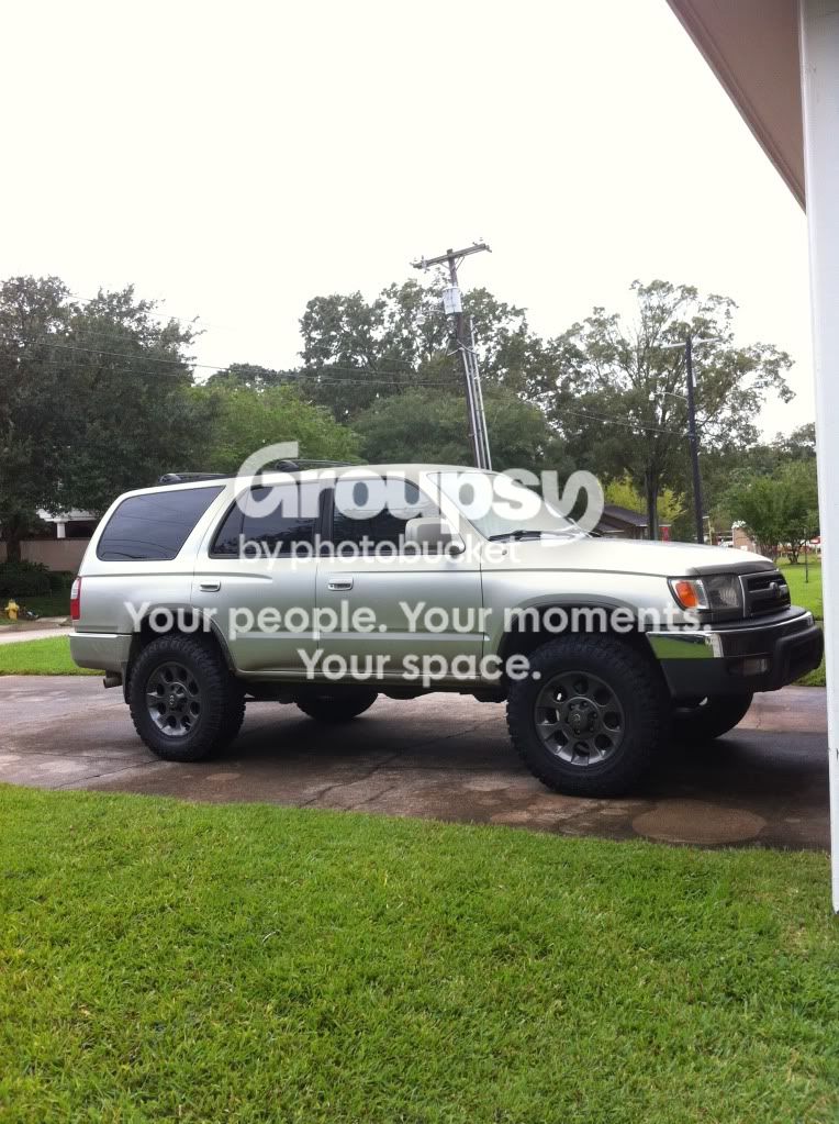

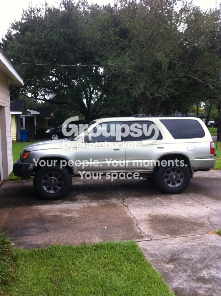

I got my tires mounted today. I went with the Goodyear duratrac 265/70/R17. Here are few pictures of the new setup. The weather was pretty bad today so the pics aren't great:
Before:
IMG_0591.jpg~original
After:
IMG_0762.jpg~original
IMG_0761.jpg~original
I can't wait to see updates on this rig
