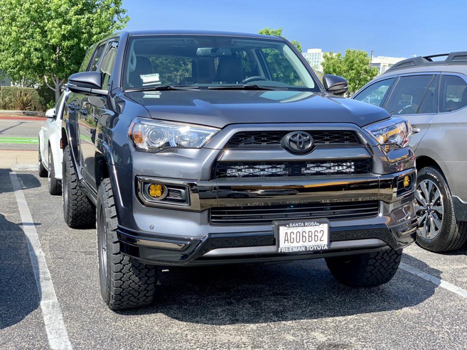

your photos above could be misleading, and I'm not trying to give you any OCD, but it looks like the XBs sit further back, especially on the outer edges, than your stock lights did. that's what mine did, and why i swapped them to the factory brackets.

I'm debating between these Morimoto XB's and the Diode Dynamics SS3 Fogs
I have a whole folder of 4Runner's saved on my laptop and I'm pretty sure this guy has the SS3's or at least something similar looking so I can imagine mine with them on. @dr_monkeypants or @dr-monkeypants
