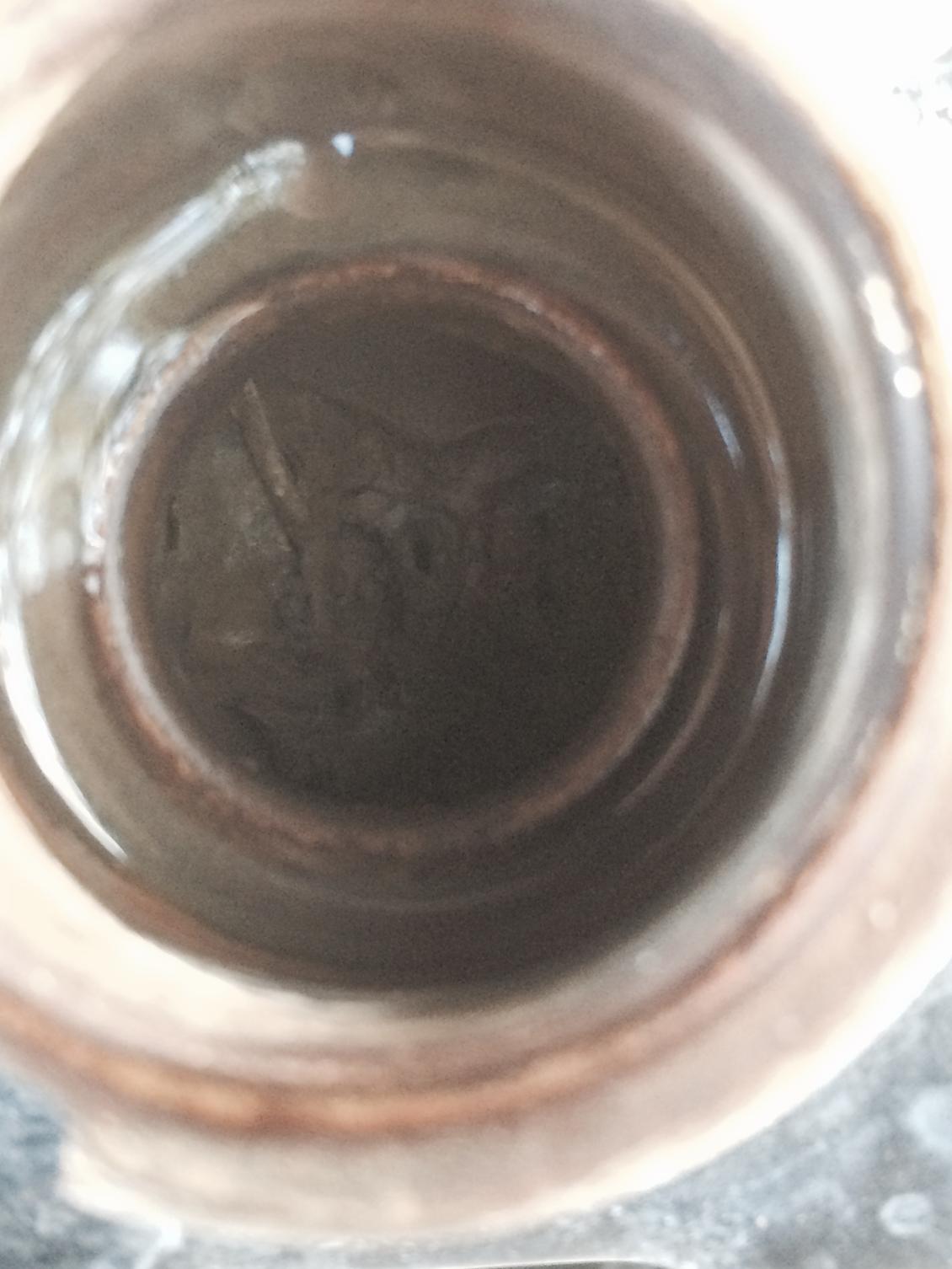

I pull the housing off to discover there was no thermostat in place. It seems someone pulled it, (overheating issues?) and of course because there was no gasket, the darn thing was leaking. Installed the new Toyota OE thermostat and I'm pumped!! I look in the radiator before filling it and I see the picture below. It is brown sludge, a pretty thick coat too. I know some folks say it is from a HG failure but I've had almost no coolant leak, (except for the small thermostat housing leak) and my oil is super clean. No white smoke and no suction/vacuum from the exhaust. In fact, the coolant seemed to be dirty but there was no visible evidence of oix mixture, (aside from the brown sludge.)

1) Any idea what could have caused the CEL 52, minutes after replacing the coolant? Could air pockets in the engine be causing this? Any suggestions on a fix?
2) Does the brown sludge in the radiator mean I definitely have a HG issue or could that just be from years of buildup? Is it worth it to replace the radiator and have a full system flush if a HG issue might be looming?

I've got $5 on air in the system after your drain and fill, which is why your heater isn't working. Air in the system will not cause your knock sensor code, but it's common for the knock sensor pigtail to go bad on 3.0 trucks, so that could be coincidence. It's absolutely worth it to have your radiator cleaned out and the cooling system flushed, bad HG or not. The brown sludge doesn't have to be oil residue, it could be from a previous owner mixing incompatible coolant types, I've heard that happens when you mix old school green or yellow coolant with Toyota red.
Don't replace the radiator if it doesn't need replacing - take it into a rad shop and have them pressure test it first. It might just need a good cleaning, which they can do for a couple bucks. You can have the rest of the cooling system professionally flushed, or you can do it yourself with a garden hose, it doesn't matter as long as you don't forget to backflush it and get all the crap out of the heater core too. Once your system is cleaned out and the radiator situation is squared away, you can refill with Toyota red, Zerex asian, or the new universal coolant, it doesn't really matter, but whatever you pick I'd stick with just in case. When you burp it, get the front of the truck as high as you can to minimize risk of air bubbles. When you think you're done, take it out and flog the throttle a little once it's at operating temp to shove any remaining air out of the lines and into the radiator, then bring it home and check the coolant level again.

Don't our 4runners have an issue with the tranny coolers that are built into the radiators? I think I remember reading that sometimes they leak tranny fluid into the radiator or vice versa. Maybe that could be the sludge in the radiator. Since you said the tranny is not going into overdrive maybe it's got some contaminated fluid?
installing the new thermostat has brought my O/D back to life. My O/D issue was due to not having a thermostat installed in the truck. Previous owners took it out for some reason.
Thats a good point about the tranny fluid mixing with the coolant. Only way to know is to replace the radiator I suppose. Took it to a shop for a flush and they advised against it, saying it would be better to just replace the radiator. Too much gunk in there to save.
Yes defiantly get a new radiator. Ask the shop your going to, if you could buy a rebuilt metal radiator. That's what I did for mine. Paid 80 dollars for it instead of 180-200 dollars for a new plastic one. As for the knock sensor give it a try unless its your DD then I would go with a shop to replace that stuff.
Thanks 4bee. I've been looking online and I just don't want to switch to the newer plastic body radiator. Called a local shop and they quoted me $125 to refurbish my radiator... I might just do that. I have a hard time letting go of the brass radiator.
